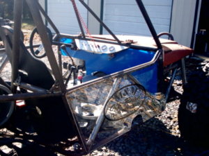

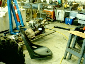

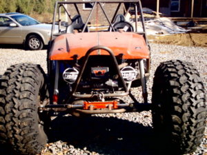

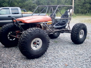

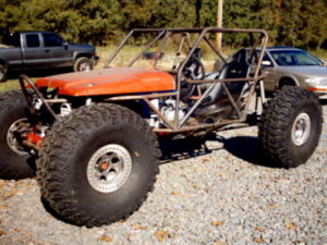

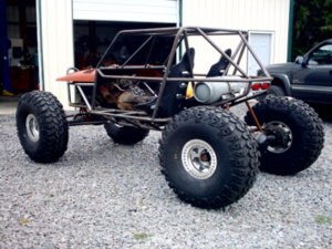

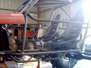

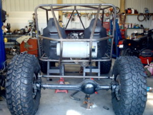

Here are some pics of the new toyota buggy i am building out here at M&M offroad. see what you think....
pics
more pics
22r on propane
5spd trans
minitruck low range bolted to 3spd cruiser case
front and rear steer custom toyota axles
all 1.50" 120 wall dom tubing
shortened cruiser hood
short drum 6000 lb warn winch
full hydro steering
42" irocs

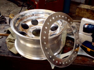

15x8 hand made beadlocks, all aluminum
lexan firewall/side peaces
walker evans air shocks
custom toyota axles :bling:
finished mock up pics
freakin cool.. Hope that rear axle holds up for ya... I'm interested to hear how it does!
Super duper pimp man. I really dig that. Very sweet, no worries about the super birfs, I've seen a couple of rigs run them and brutalize them and had zero probs, post some pics once it hits the trail please that thing is going to be awesome.
Looks AWESOME P.J.!!! For the doubters, Cassidy has been running rear steer and 39.5's w/toyota axles for what? 2 years? Any more info on building the steering axle? I just picked up an Fj80 front axle cheap, having evil thoughts of it going in the rear of the Zuk.
Looking good P.J., can't wait to see it on the trail!
R.K.
not yet, but i am trying to have it done to work out bugs on the land before santa and the sleigh show up.. we will see... I appreciate the feedback, seems positive. Kyle, contact me and i will be glad to help with specifics on the axle. Back to making the donuts......
I've bee thinking of running a 'yota rear steer for a while now. How do you think it would do at highway speeds? Any vibrations or wear and tear you can think of?
high way speed wobble
i have not run it personally yet, but i have seen another guy with rear steer on his toyota buggy do 50 mph with just the ram holding it. However your best bet would probably be to mount a fixed connecting point on the tie rod to the axle when you get on the hard rd for those speeds, that way it will not turn at all. as far as wobble? If alighnment corrections are taken into consideration when building the axle, in theory you should not have any more wobble or problems than you would in the front... When i get it done i will let you know my results.
How about vibration? I recently forgot that the hubs were in and drove to work. (60-70 on the beltline.) I noticed a vibrationg at that speed and knew what it was, but I wonder if you'd get that with power applied like in rear axle.
