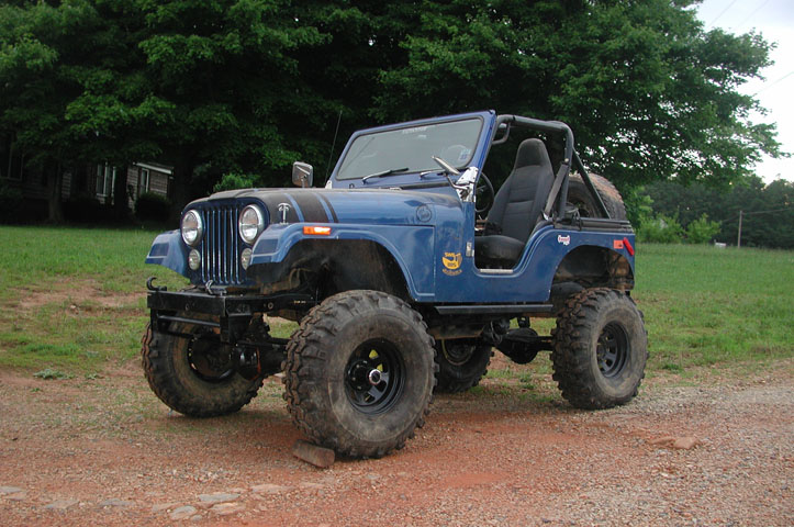

Sunday, my Jeep saw direct Sunlight for the first time in about 5-6 months
here's some picts.
I think the only things left are Shock mounts, Flex it and Measure for shocks.
run thru and make sure everything is tight and torqued. Axle vent tubes, Traction Bars... put some Anti-Freeze in the tires, and a few other minor things....
Oh and find a D44 carrier and get rid of that damn welded front. That crap ain't gonna fly. I was feeling issues righ there in the gravel lot with it binding up. SCREW THAT!

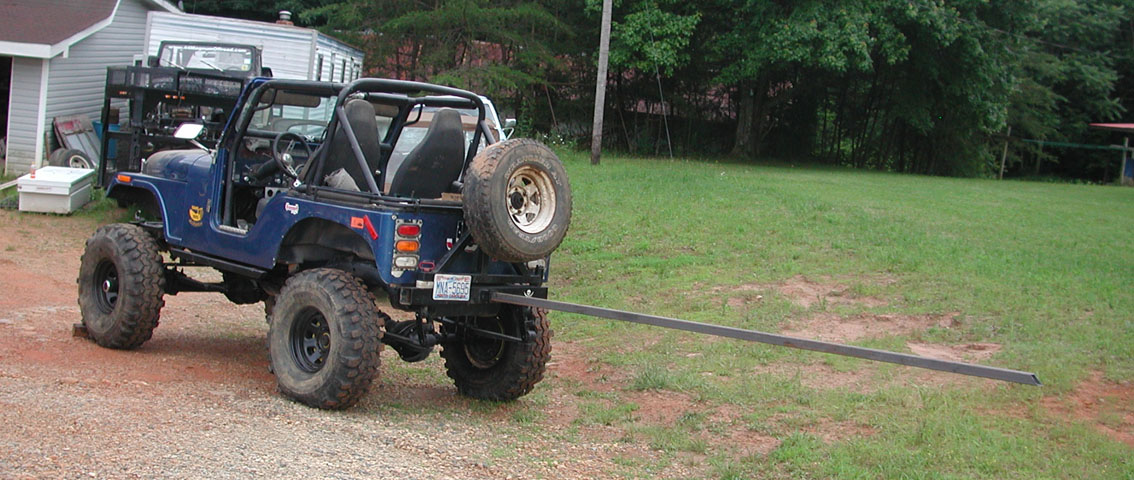

OK, wtf is the 2" box tube for?
lmao
the top of the cage is 85" the door to the shop was 81" we aired down teh rear some, jambbed teh tube in teh hitch reciever and Bill and Darren weighted down the rear using it as a lever to clear the door as I backed it out. :D

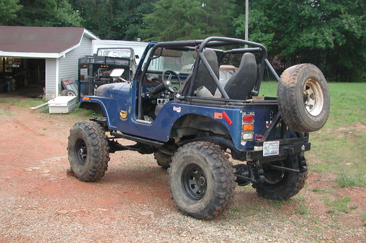

what wheelbase you runnin?
we just got done with the rear of my buddy's 5, SOA with waggy's in the rear for a little stretch. not sure what the plan for the front is yet...
I am out to about 90" as I recall. Haven't gone back and actually measured now that it's all done.
As for my front I went XJ rears (actually all the wa around) and used the offset behind the axle. the short end of the leaf is basicalyy the same as the stock CJ.. with in 1/2" as I recall. so my steering is in the same place
