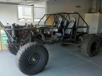

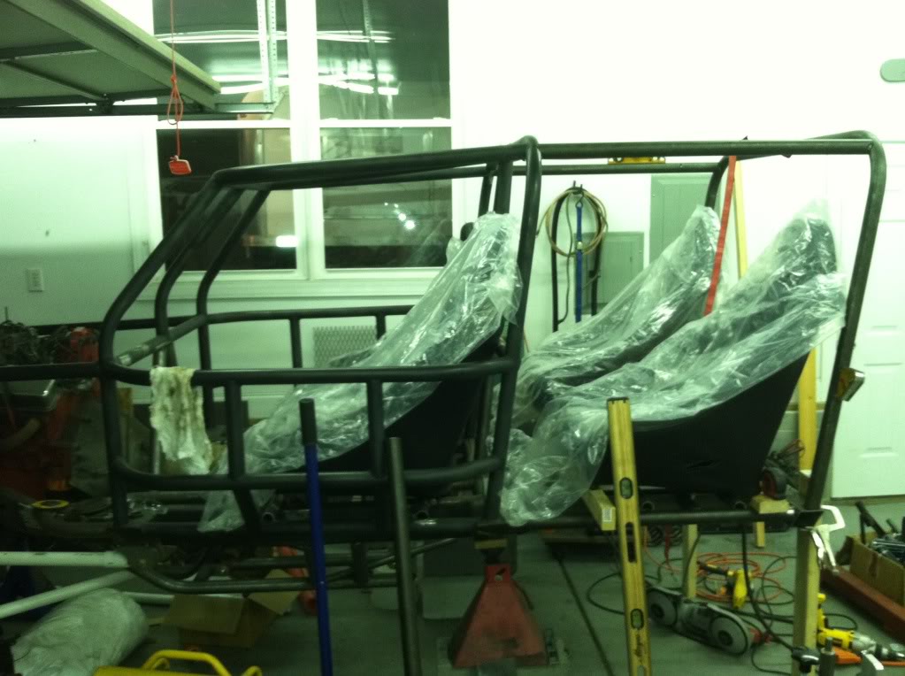

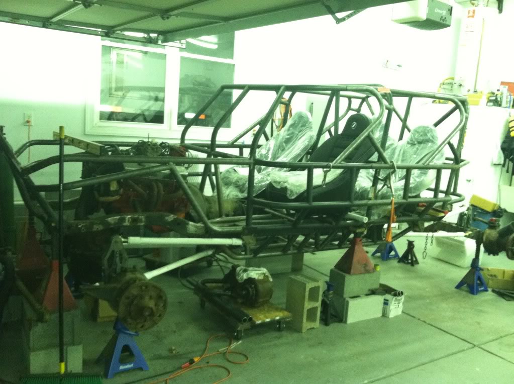

I purchased this two seater buggy and thought I would take it straight to the trails...but when I got it home and really checked it out, it needed ALOT of work...so I started cutting....

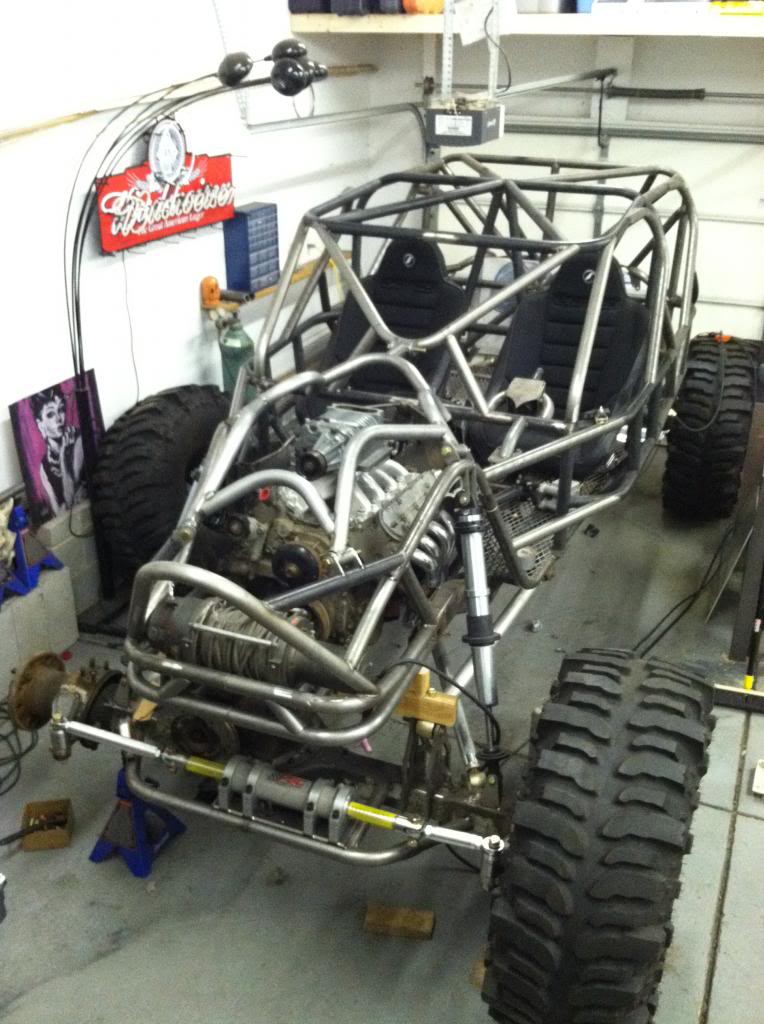

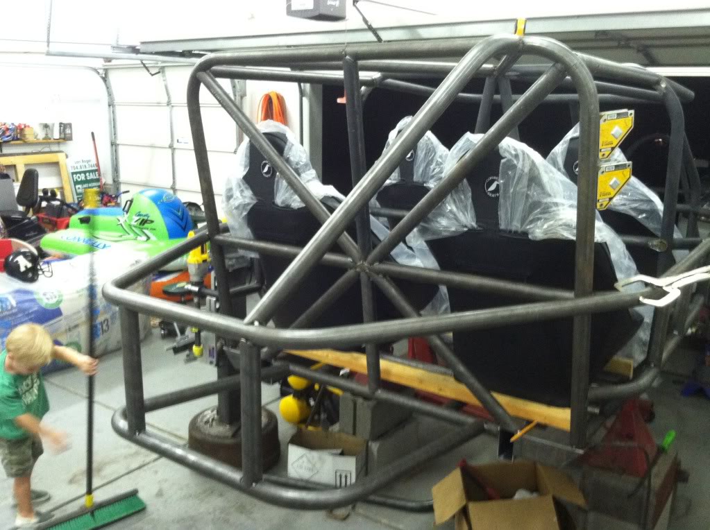

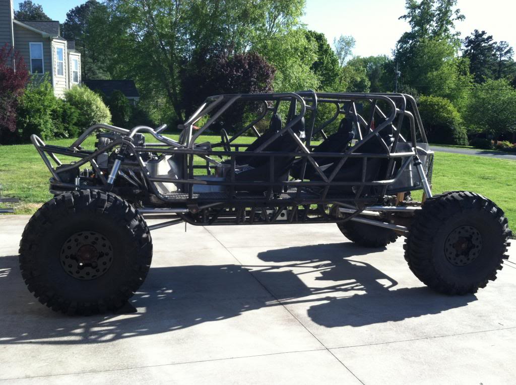

Started to cut it up and decided I wanted to build a four-seater for entertainment!!
four seaters are nice....i like my two seater....but no room

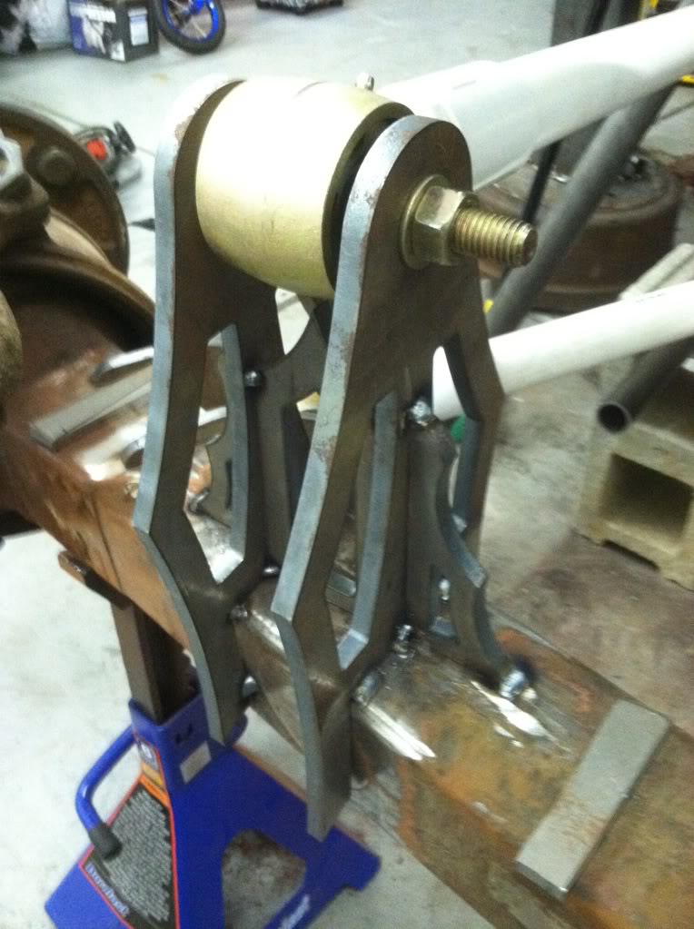

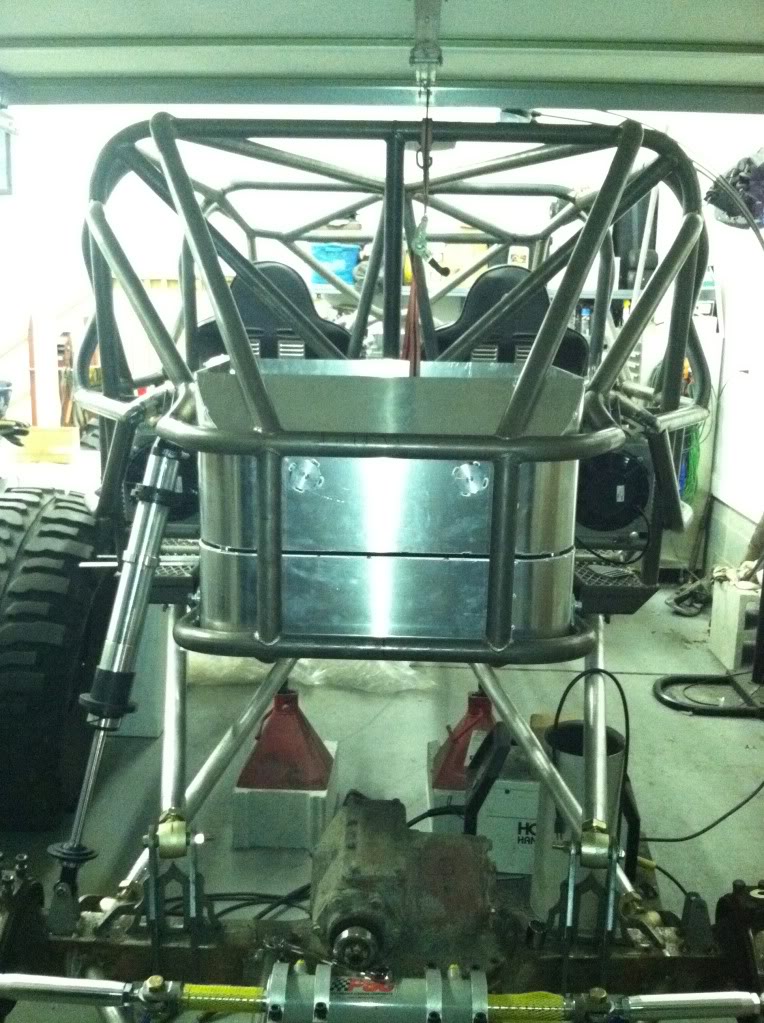

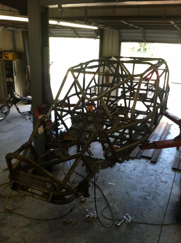

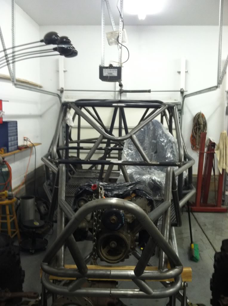

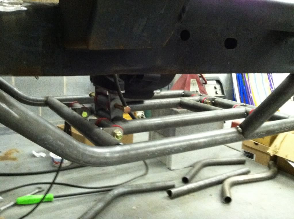

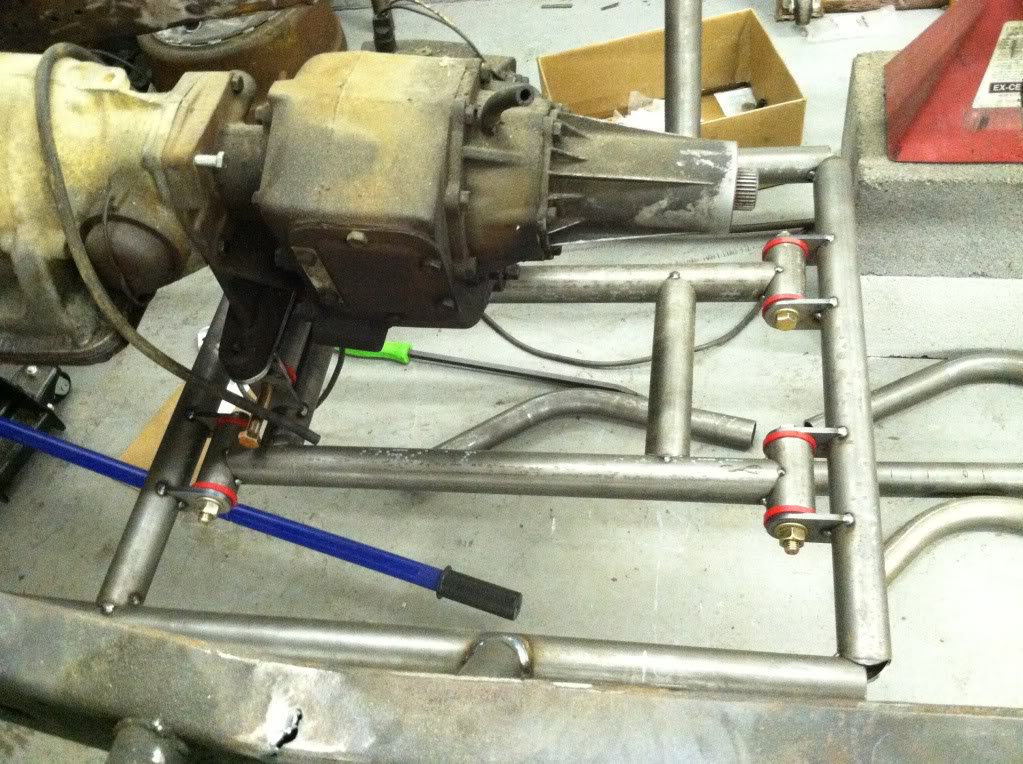

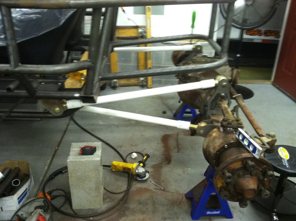

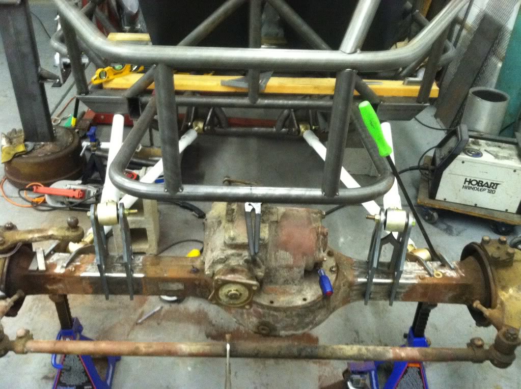

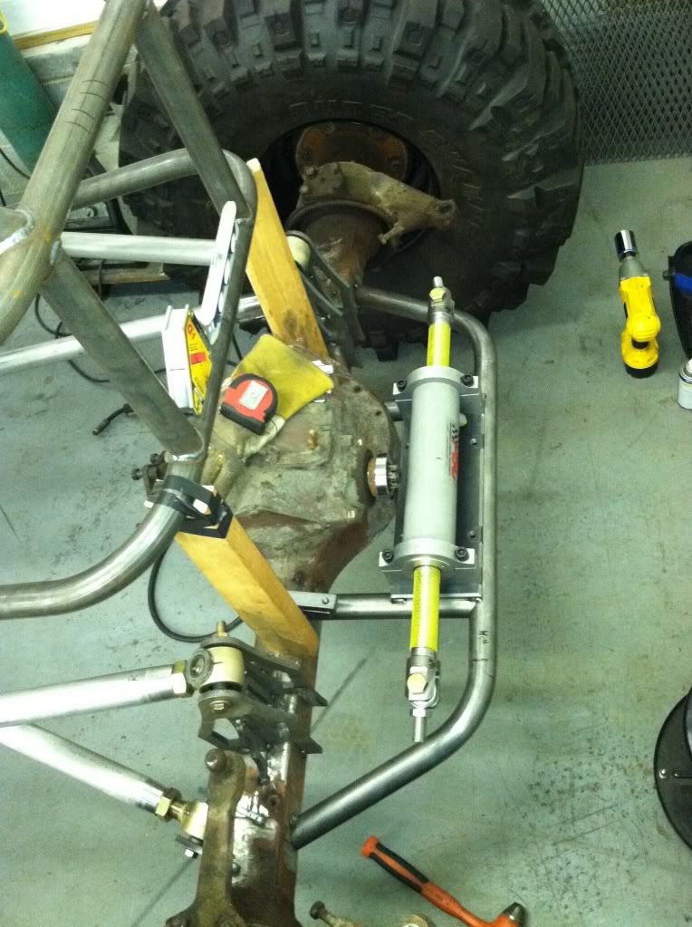

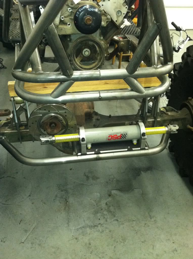

Got the front axle and some side bars in. Started on the front end.

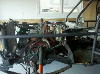

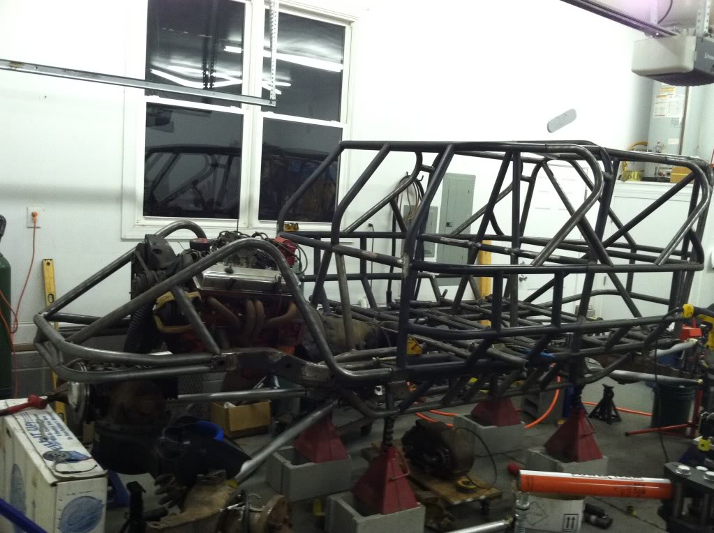

The front end wasn't looking like i wanted it to, so i cut it back off. Now looks like this.

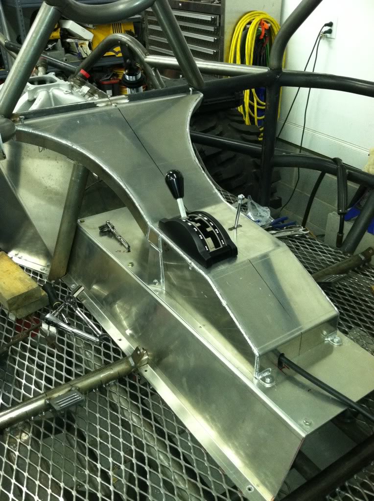

Dang...you about should have started from scratch. Looking way way better than where you started! Like the center console.

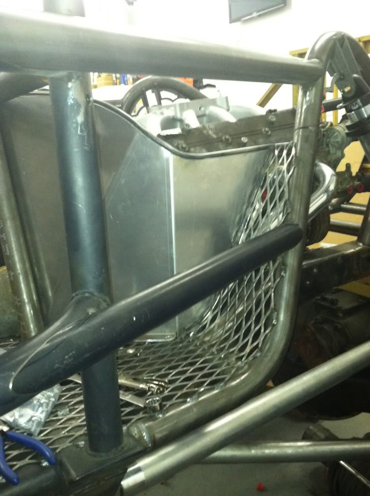

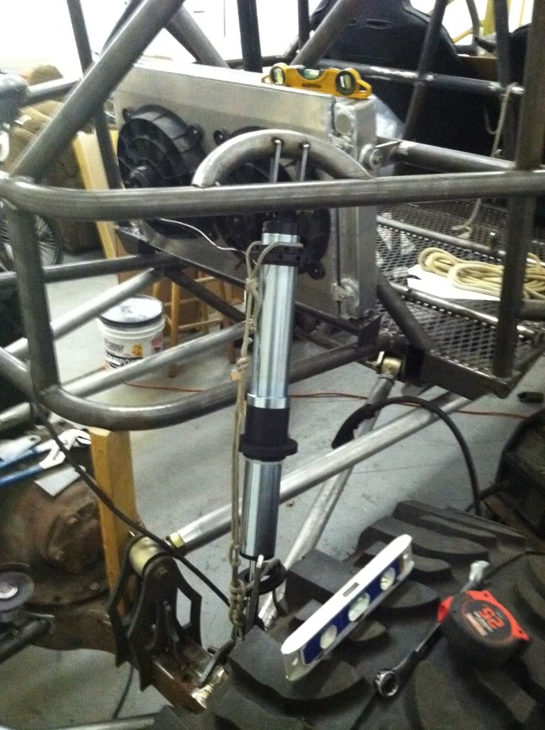

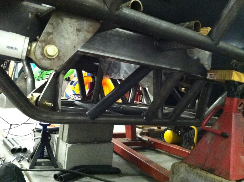

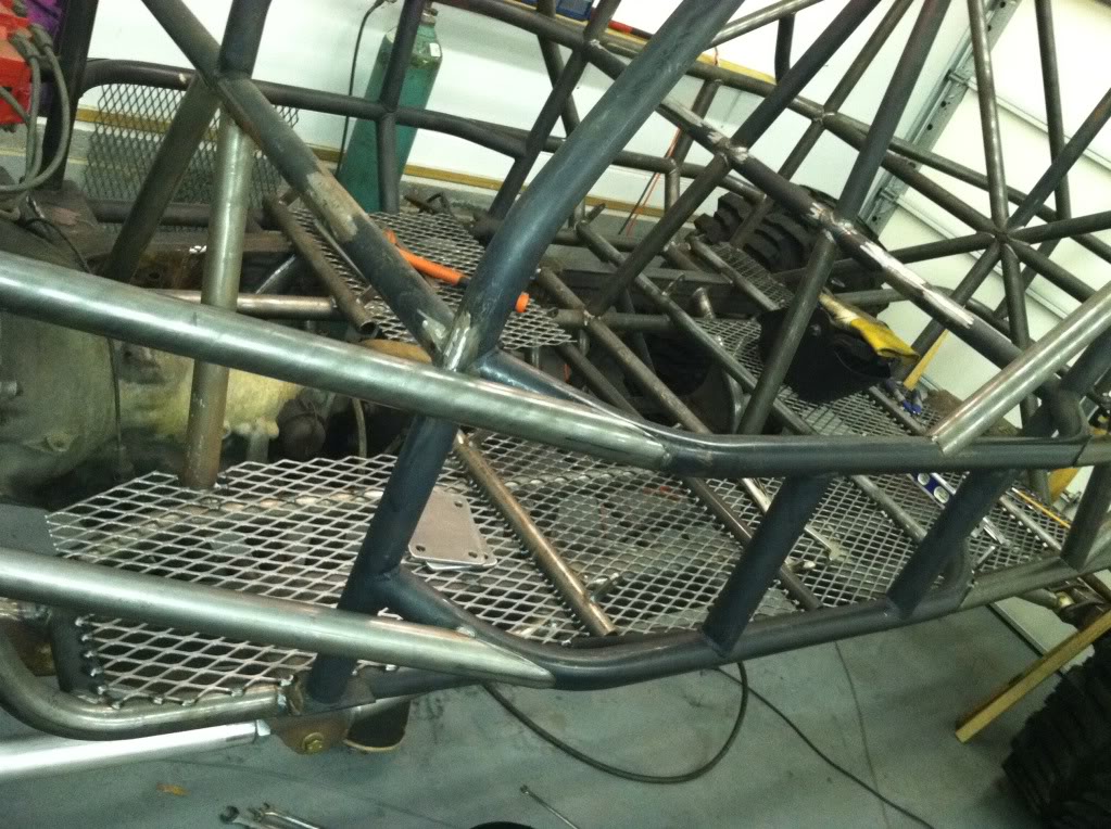

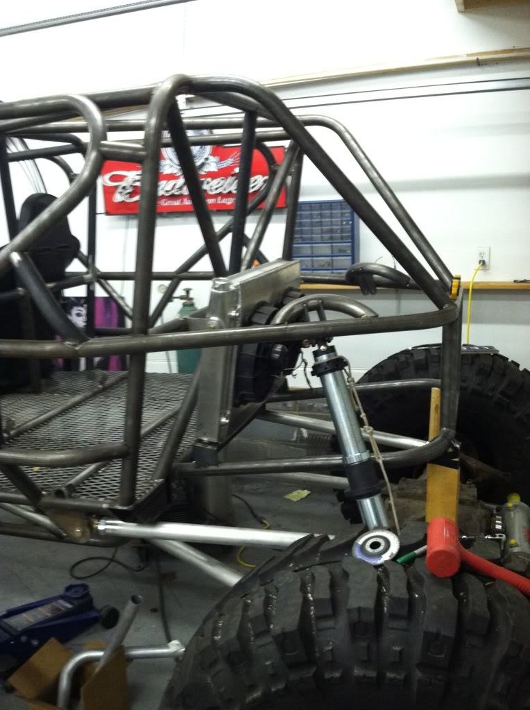

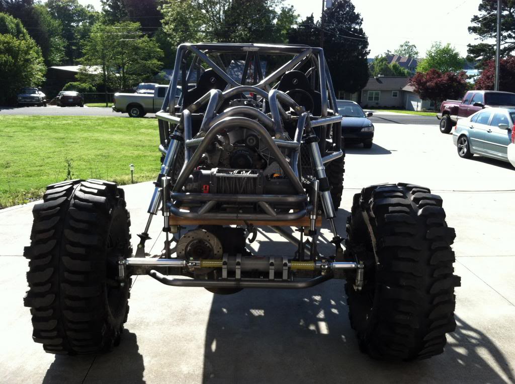

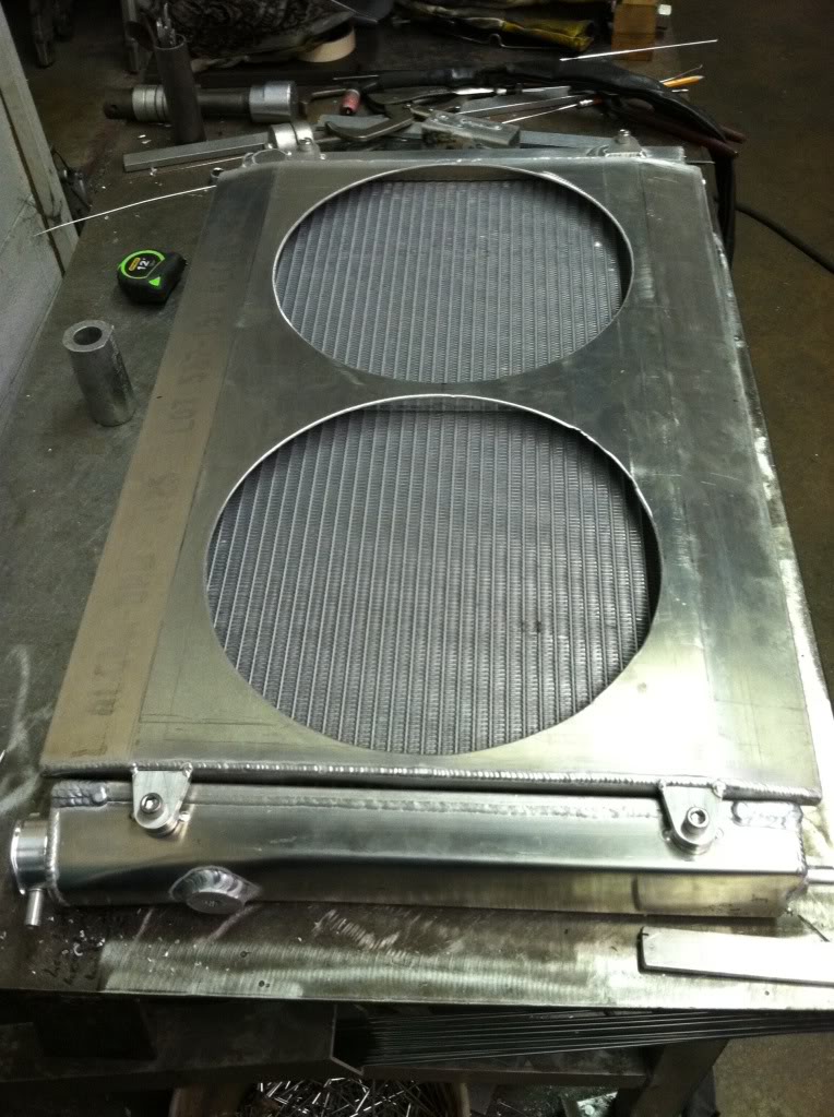

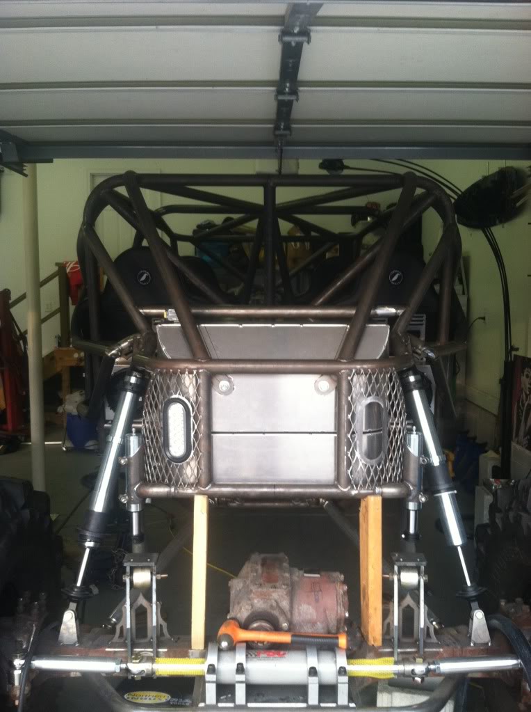

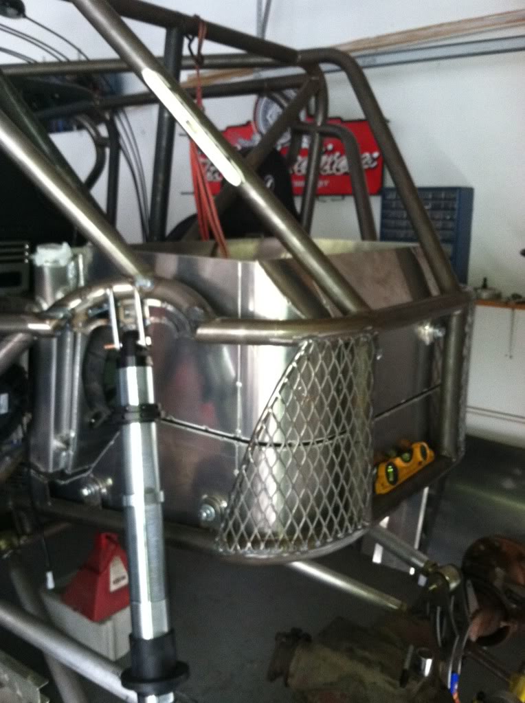

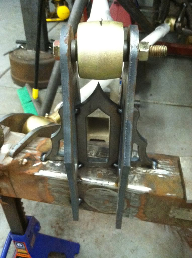

Thanks man. Yea i know, but i was to far along to turn back. I got to thinking i could do a few things to it and go play but i am to anal for that and ended up redoing about all of it. Got the radiator,shocks fuel cell and a storage area done.
Yeah, probably would have saved you alot of money to start from scratch... But looking very good.

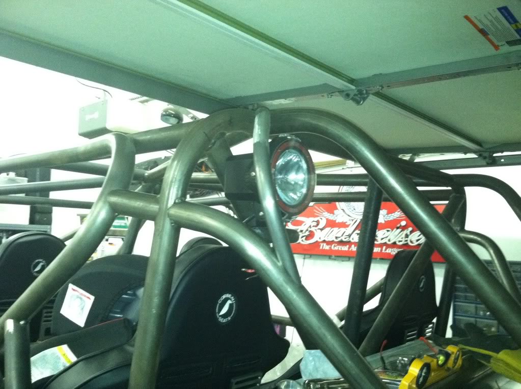

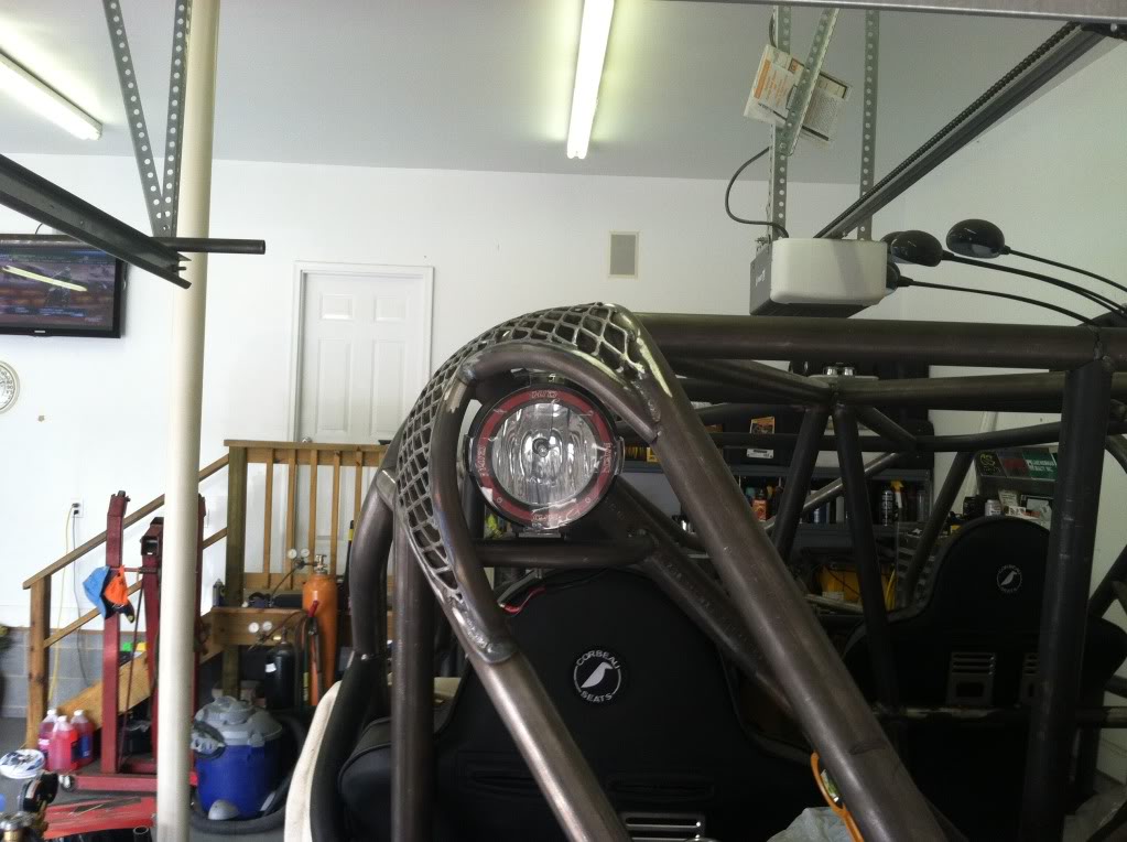

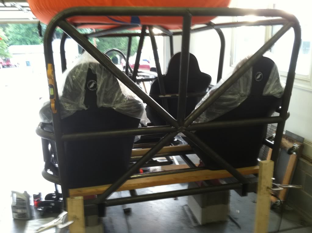

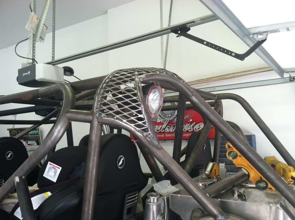

Thanks, i didn't have to give too much for it so i am not too far in the hole.I sold most of the stuff i didn't use. Here is a pic of the tail lights and some back up lights.
Very quality looking work, but sometimes there is a such thing as "too much"...the windshield bar has for sure got to go. :flipoff2:

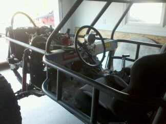

:edit: Where did the seatbelt tabs come from? Looks like a pretty cool idea.
Nice work...

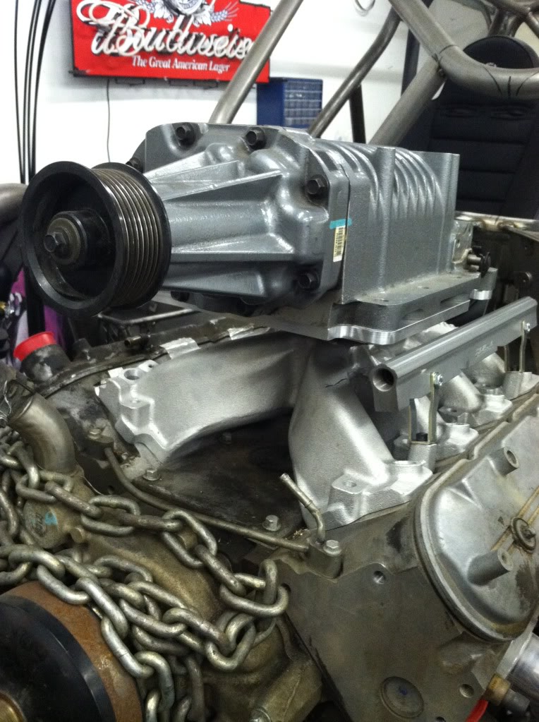

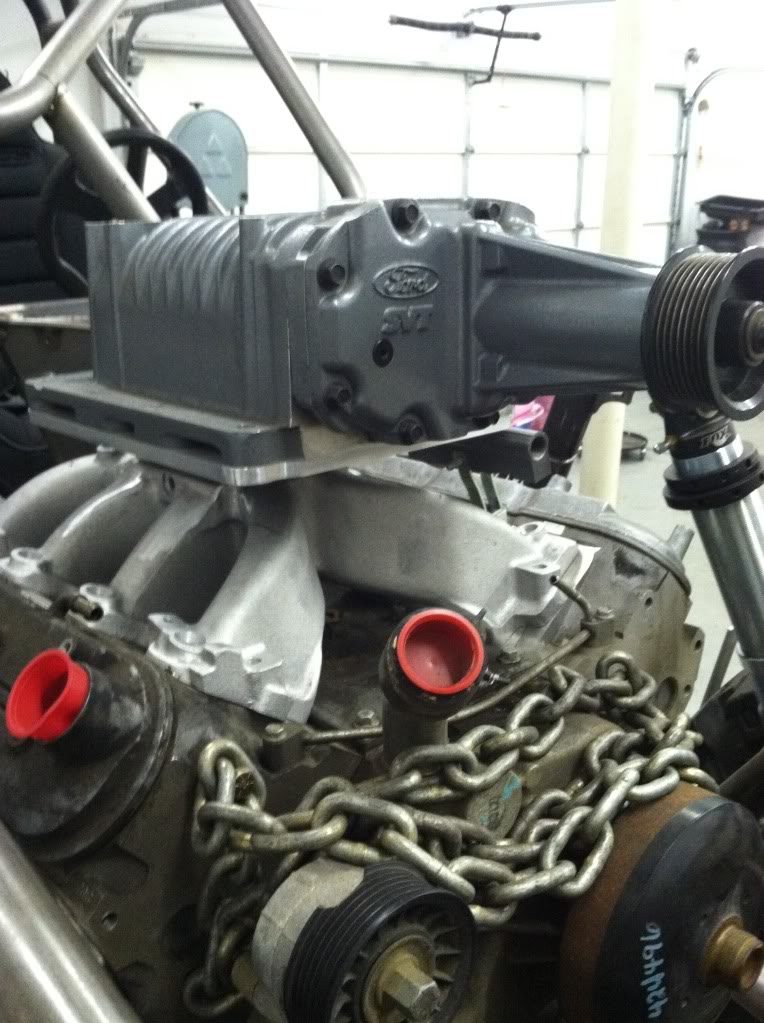

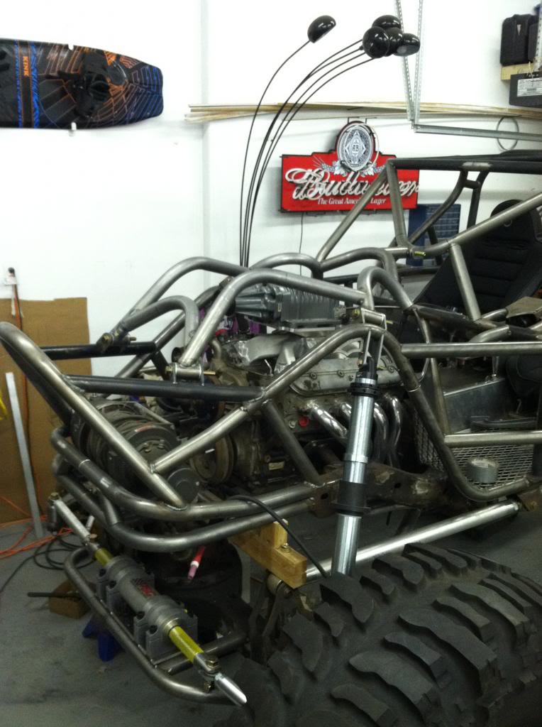

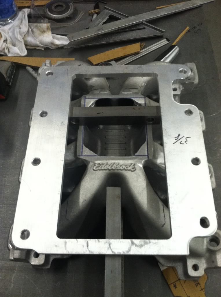

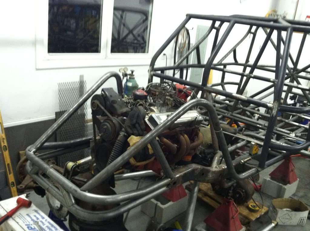

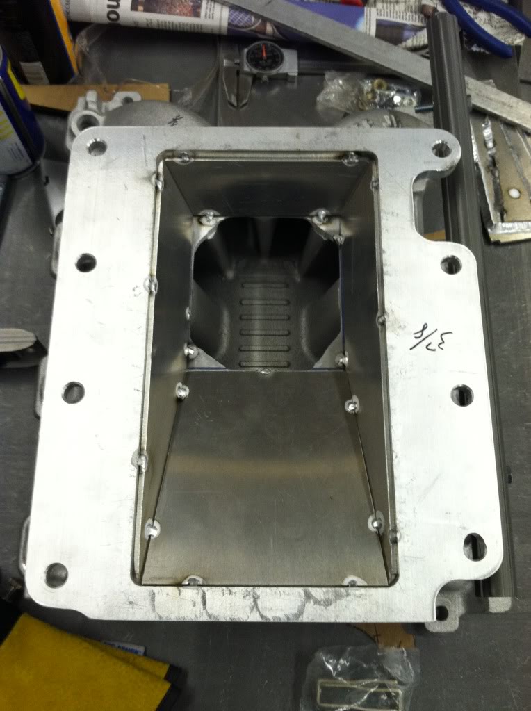

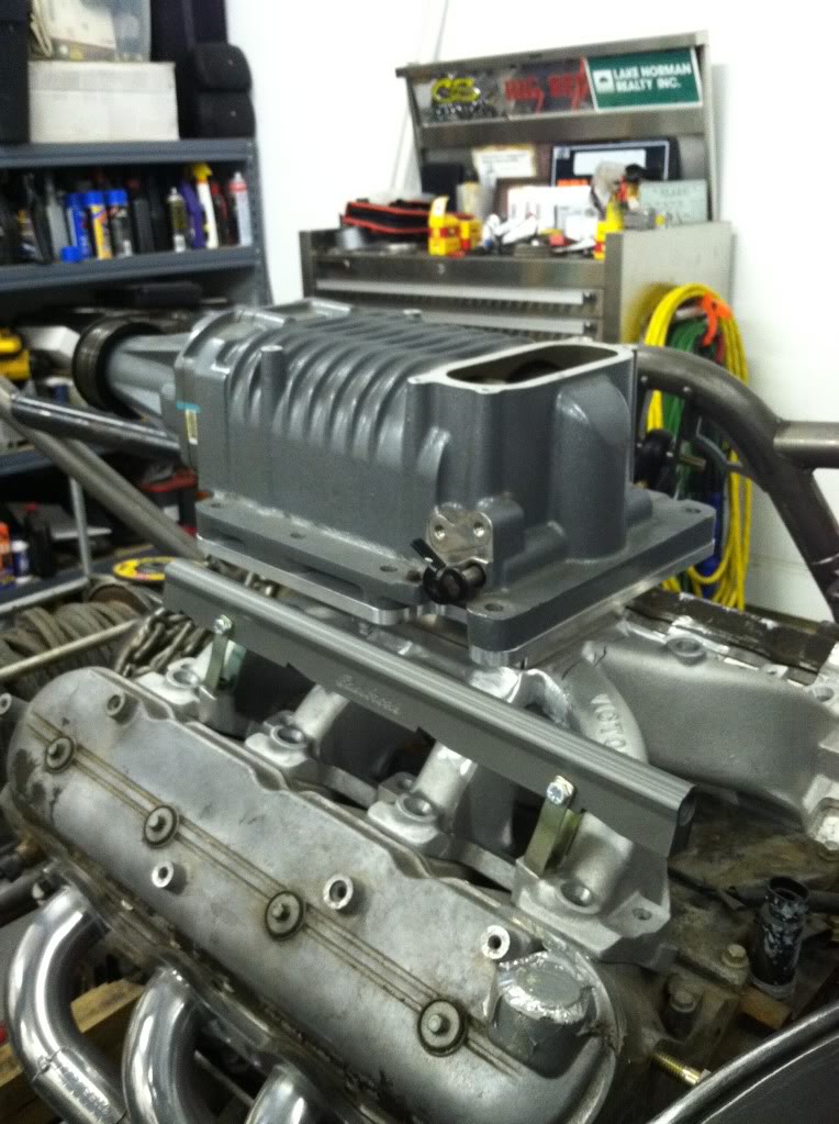

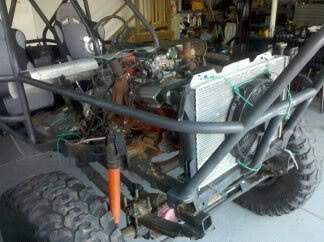

Thanks, i might have went a little over board with a few thing but everyone likes different things. The seatbelt tabs i made, thought it would be a little cleaner then having your belts wrapped around the bars. I am going to run a 5.3 motor with a supercharger. The supercharger is from a ford lightening truck, i know its not the best way to do it, but it is cost effective. I cut down an intake and made a plate that fits the bottom of the supercharger and welded them together, check it out.
The expanded metal and tube work on the rear lights is sick! I wasn't sure about it at first but it turned out great! I'm not sure about the front windshield bar but I'm sure you'll make it look good too. Carry on! :D

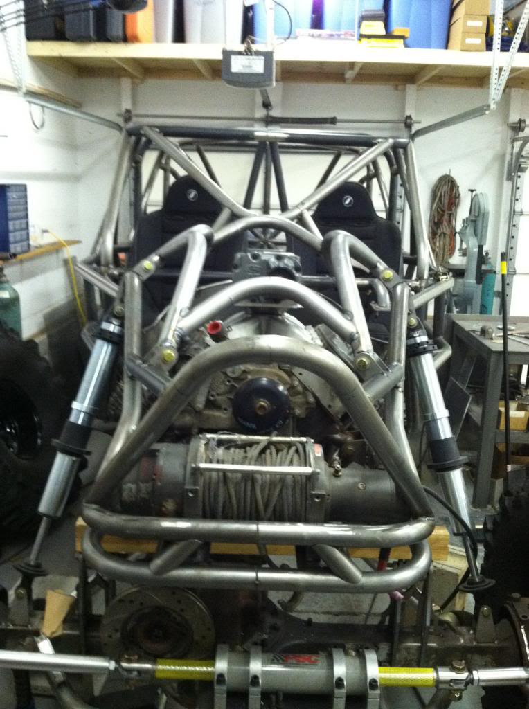

I like different stuff too. Here are some pics for the supercharger cover bars.

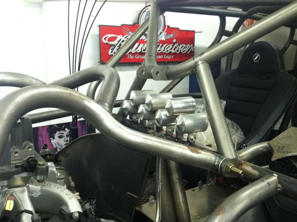

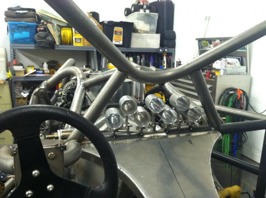

What do you think of my gauge pods?
