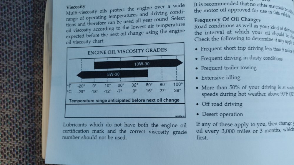

I thought about running 5w30 but I'm not sure. I know it will help with cold starts but the owners manual calls for 10w30 all year round.
99 owners manual.
