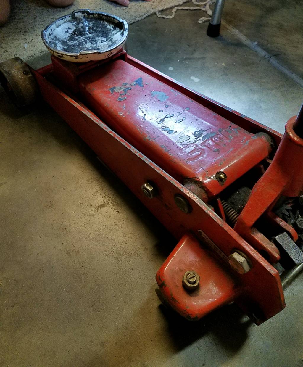

Putting tires on my son's XJ today and in the middle of it all my jack won't drop. Handle spins freely so we take it off. Of course the handle is rounded out where it goes over the nut. Put a socket on it and the valve is nearly froze up. So now I'm looking for a new one. I've had mine for years 15 or 17 never a problem don't even know the brand as it was given to me by a friend who didn't have a garage anymore.

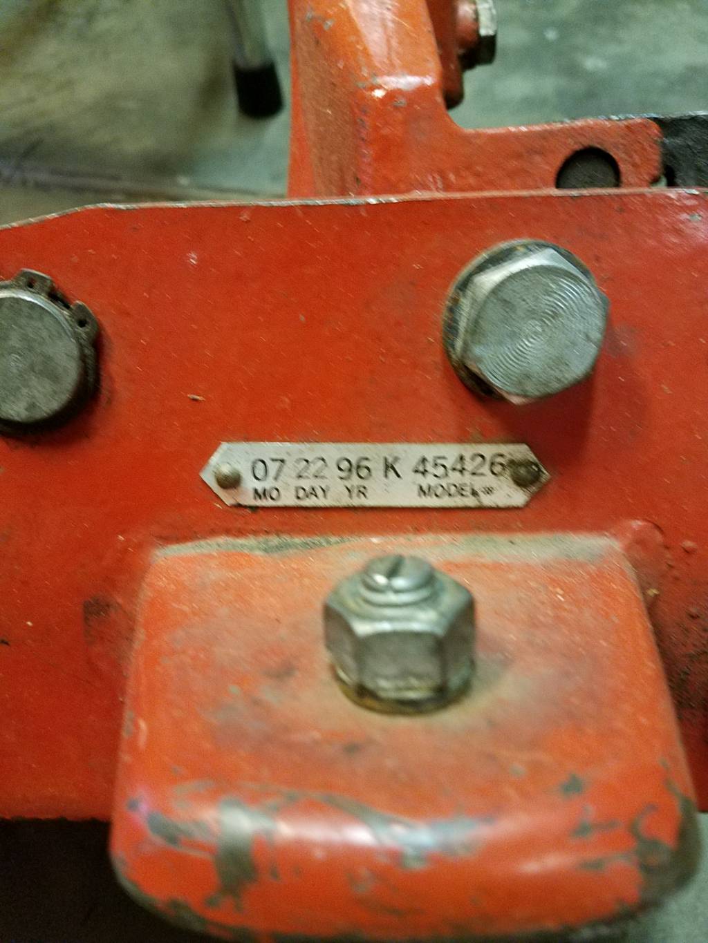

Gonna do some more research. It was made in 1996 I've gotta find out what it was.
Allied is the brand and looks like others last a long time too from a quick Google search, people getting 20 yrs . Bet they don't make them the same anymore though

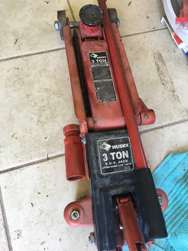

I've been using a similar 3 ton for 18 years. Not sure of brand, nut theyre pretty much all the same.

Ok just a little bit of time and fab work. Hopefully another 19 years!. I cut the end off a China Charlie wrench and opened up the jack handle end so it fits down in and weled it in place. A little cleaning and lube it is probably better than most from what I'm reading. While I too would like an Aluminum but this thing is solid and only this time has it "let" (not) me down. Money well saved I hope.
