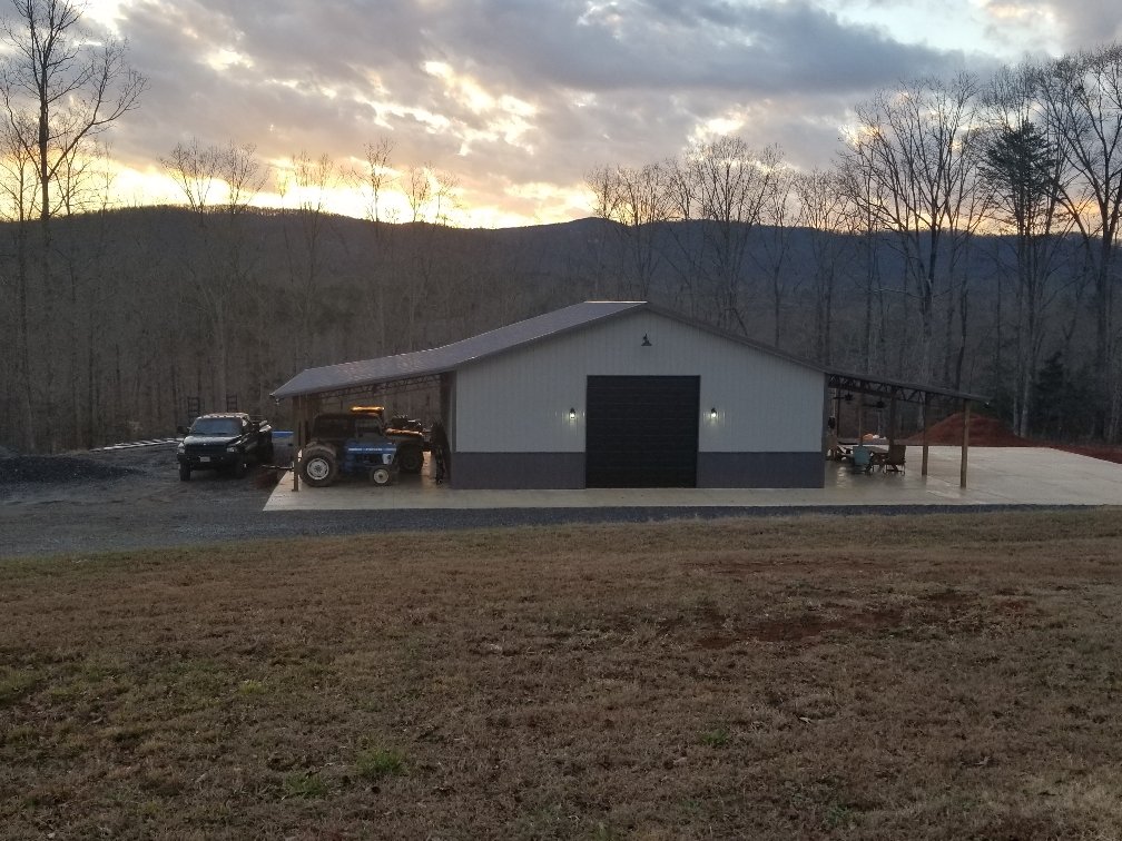

I just finished my R&R building. 40x40 with 2 16ft leantos. Justin was easy to deal with and delivered it within a few days of ordering. I chose the post frame over the red iron because I liked the residential look of the building. I have an old farm house and the post frame look matches better.
Sent from my SM-G955U using Tapatalk
