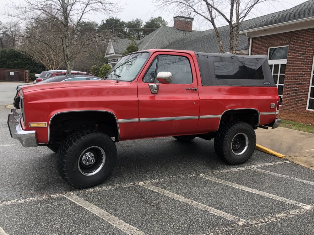

Red Rover - 88 Blazer

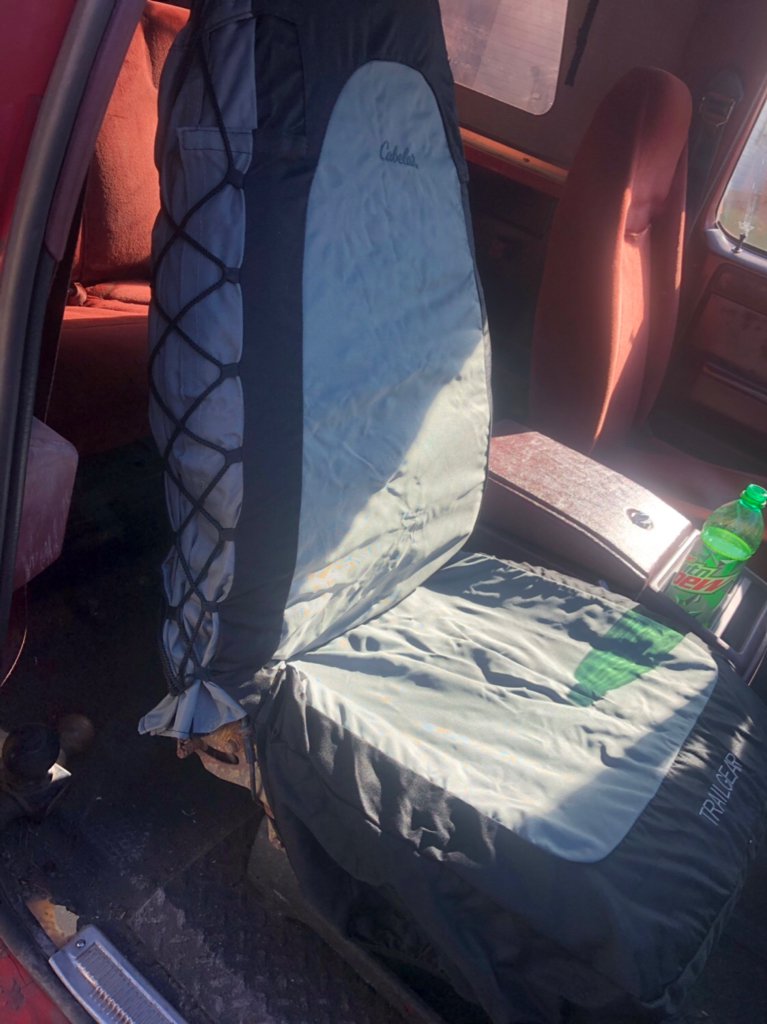

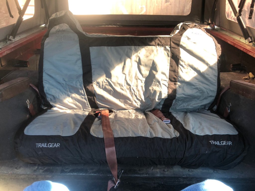

Put Cabela trail gear seat covers on it. Looks nice for $20 and semi water resistant. Covers the missing plastic bit on passenger side.

Yes, he put it on / swapped brackets, I think from an 86 truck. Looks nice on there and I have the blazer tailgate as well to eventually fix up (new motor, missing bits, etc) Can see a bit of daylight between fenders and tailgate when I look backwards, might be some 'seals' that would normally close that off a bit more but just adds character (and possibly exhaust fumes!?) But doors off and the soft top down all summer, exhaust fumes won't matter a whole lot anyway!! :)

Been a few weeks, got the transfer case rebuilt by Billys Transmission in High Point, NC ($675) and rolled over the odometer a week or so back!! So it is BRAND new again!? Just over 1100 miles on it now since I bought it, no actual snow to drive in since then.

So far it has been a GREAT "pickup truck!" Folded up the rear seat and you can put a bunch of crap back there.
