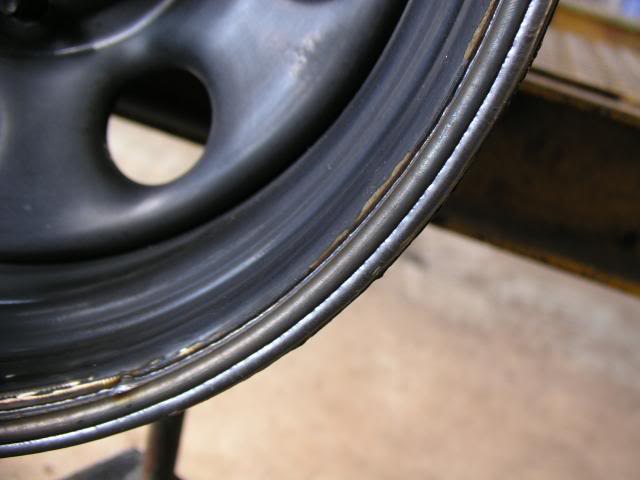

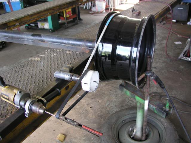

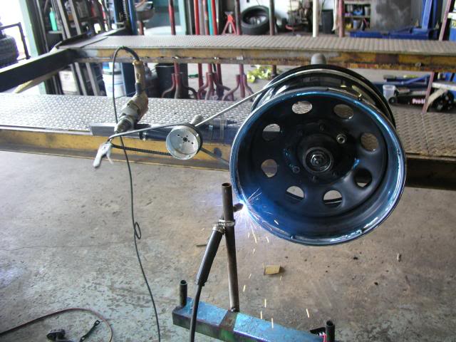

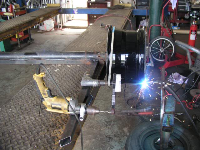

He made this set up to weld a bead on each side of a 3/8 piece of solid round tube around the outside of his wheels to stiffen them, kinda like a rock ring, After figuring up how much welding it would be he came up with this.
Nice weld also
