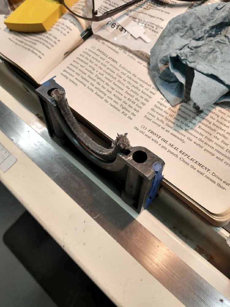

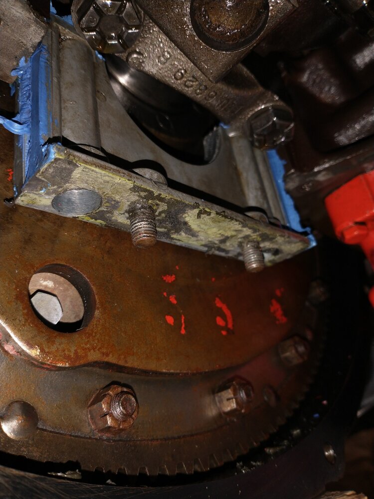

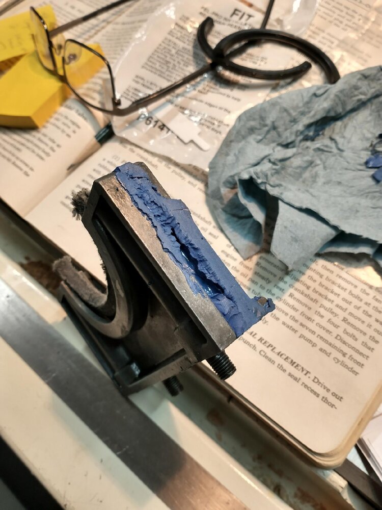

My dad is working on a 1955 Ford Y-block and when it was at the machine shop and rebuilt 20 years ago, they assembled the short block for my dad to include the rear main seal installed as a factory original rope seal. Things happened and life changed, and the car and project has sat for the better part of 20 years, everything has been inside a climate controlled building. My dad has now began to rework the project. He removed the heads and the oil pan to ensure that there was no formation of rust on anything re-lubed all parts that he could get to and has since started the engine. Everything is going absolutely fine to include compression oil, pressure and temperature, but he is having an issue of a leaky rear main seal. He lifted up the transmission just enough and was able to work the oil pan out from underneath the engine and found that the rear cap does in fact hold an oem, original style rope seal as opposed to a newer upgraded rubber seal does anybody have any idea how to push the upper rope seal up and over the crankshaft and then replace it with a new style neoprene or rubber seal? Yes the old blue rtv will be fully cleaned and new goo will be used.
- think replacing a 2 piece in the rear of a Jeep 4.0 except this is a rope that needs pushed out not a newer conventional seal.
Any ideas would be great. Thanks.
Any ideas would be great. Thanks.View attachment 387412View attachment 387413View attachment 387414

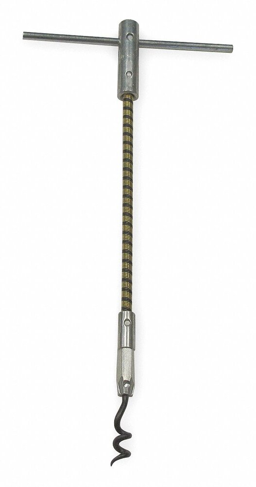

No experience with rope main seals, but that stuff looks a lot like the stuff we use to pack valve stems and pump casings with. We use a packing removal tool to pull out the old stuff. Looks like this.
