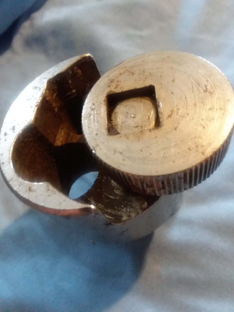

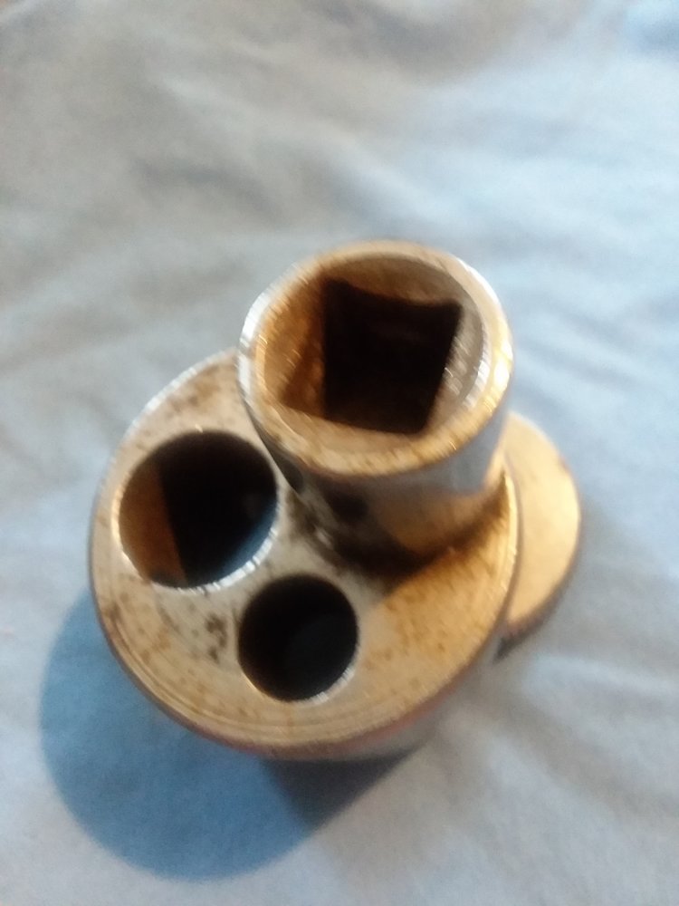

Black Hawk 49980
Large hole is about .775 inch

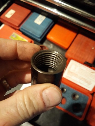

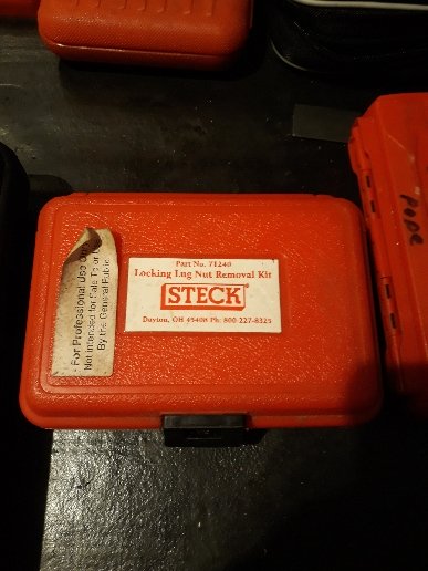

Really a stud remover, I have removed several rounded off nuts with it. Been in my toolbox at least 40 years.
That is similar to the one I bought at autozone, it was a 3/4 in size I believe. All it did was strip the chrome plating off,
If you can its best to grind off the chrome first ( I like a die grinder) and then hammer on the removal socket. All these "Teeth" help to grab it. You turn slowly with your ratchet and tap with a hammer at the same time. This keeps them biting.

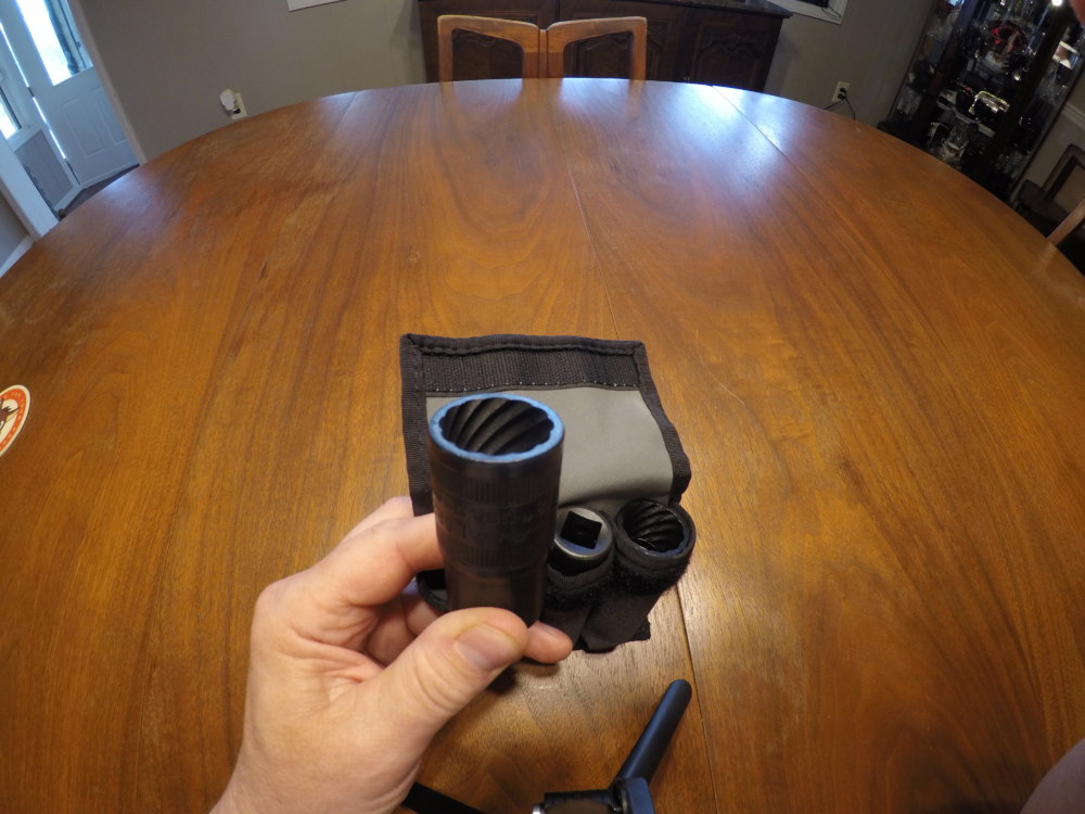

These are the ones meineke had. Where did you find those? That’s the kind I would like to invest in just for any unfortunate future occurrences
I bought the set off of the Snap On truck. I imagine you could order the set from Snap On website. I think I paid about 100 bucks for the set but priceless when you need them. Also the "teeth" will eventually loose their bit after continued use. But with a lifetime warranty you just trade the worn ones in for new ones.
