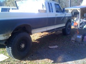

After getting 1 1/2" spacers they fit great!!
