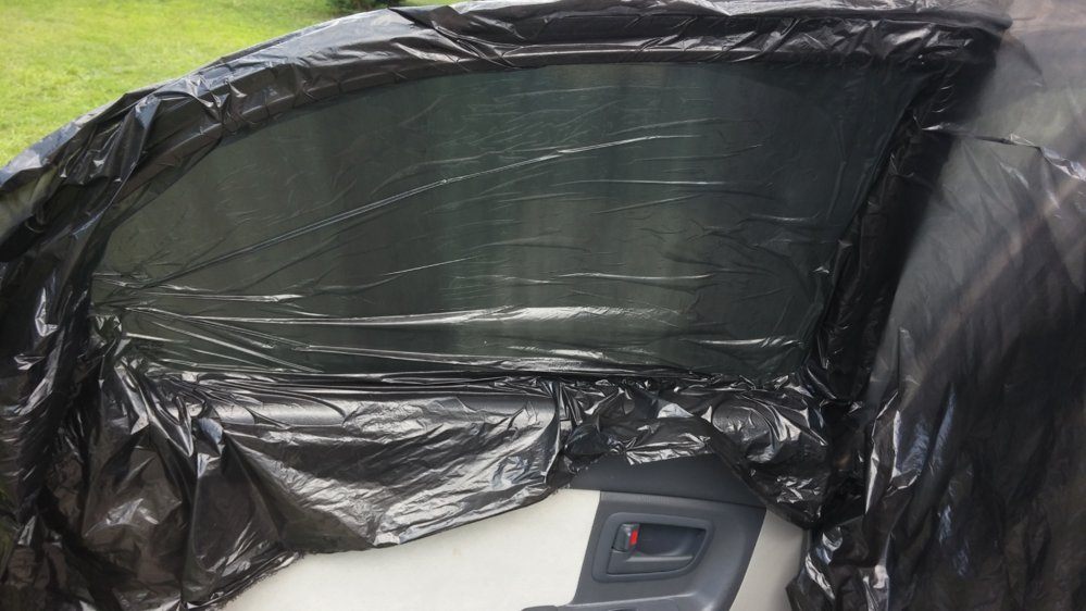

Last year I had the wifes car tinted 20% all the way around. Thought I could get it to pass but the first place I took it to said no, and actually failed it in the system. So now I'm removing it.
Found a video online using 409 and a trash bag. Soak it down, stick a trash bag to it (black shiny one) park in the sun for 20 minutes or so. Worked like a charm.
I'm not doing the very back glass, hoping I can slide past with leaving it. But good to know this works very well, and peels right off leaving no glue. I was very impressed. I even wondered if it came off so easy Just cause it was so hot in general so I tried without the trash bag and cleaner, no go. Left a bunch of glue so I stopped. It worked perfect so I thought I'd share.

heat gun will work too. the black trash bag is to use the suns energy to create heat. the heat releases the glue. just use a heat gun and razor scrape blade.

Find osmebody that has one of those garment steameers that you use for removing wrinkles from clothes.
Run the handle over the tinting to get it hot, it will peel right off.
I did it on my car for teh same reason, worked great.

I already got it all off before I posted this thread. All methods work great, but to put the cleaner and bag on it, walk away and do something else, then peel it right off, I'd say that's the easiest way.

Soak it real good in the 409, put the bag over it, let it sit for a bit, peel it off. I was pretty impessed at how simple it was.

So just reading the above. Ive never needed to use trash bags or 409...
there are two major common types of tints that I'm aware of ceramic and vinyl . I always buy ceramic and the only thing I do is wait for a warmish day and peel away. every now and then I might need to get some glue residue off one of the corners but I guess Ive just been lucky. there is Static cling tint too that just uses static electricity to cling to the window which is even easier as you can reinstall it if needed.

I just pulled the tint off of my TJ doors. Owner before me had them so dark that I couldn’t see crap at night. I used a heat gun to get a corner started, then I heated the rest up just to loosen the adhesive. Pulled right off without a single tear. I used some goo gone to get rid of the adhesive followed up by some windex. Both windows took literally 10 minutes total and are crystal clear.
