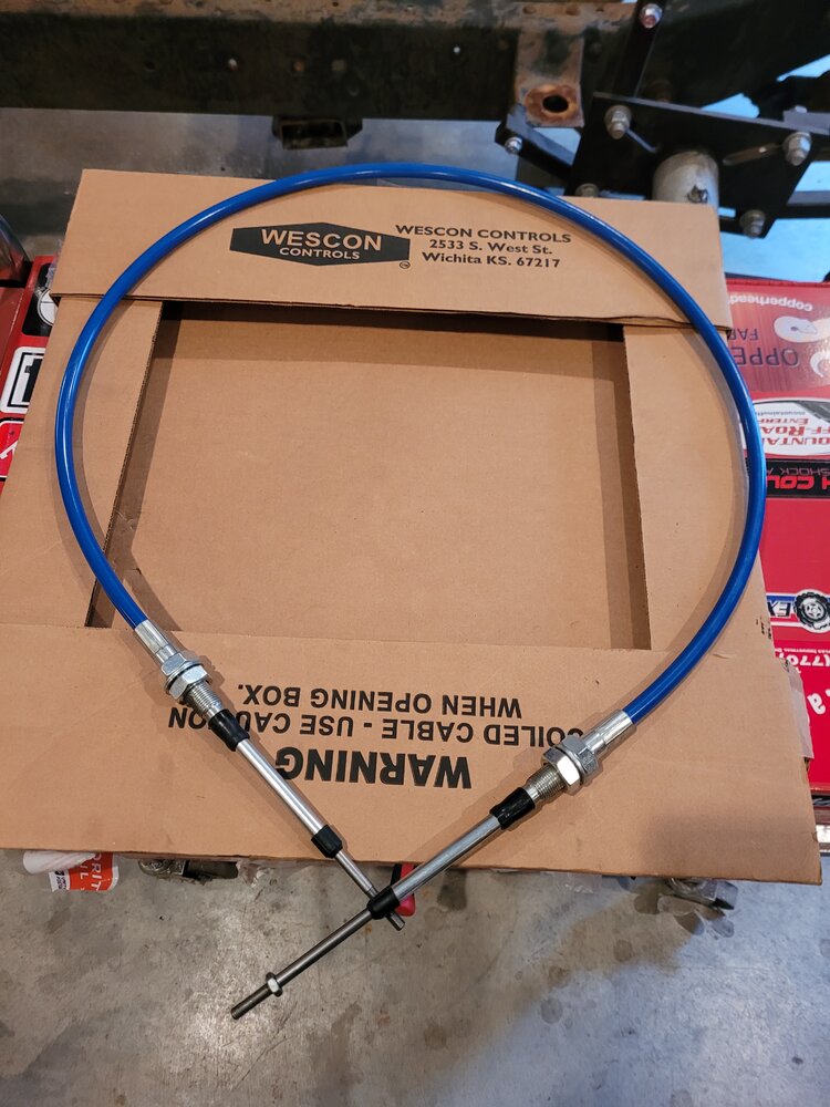

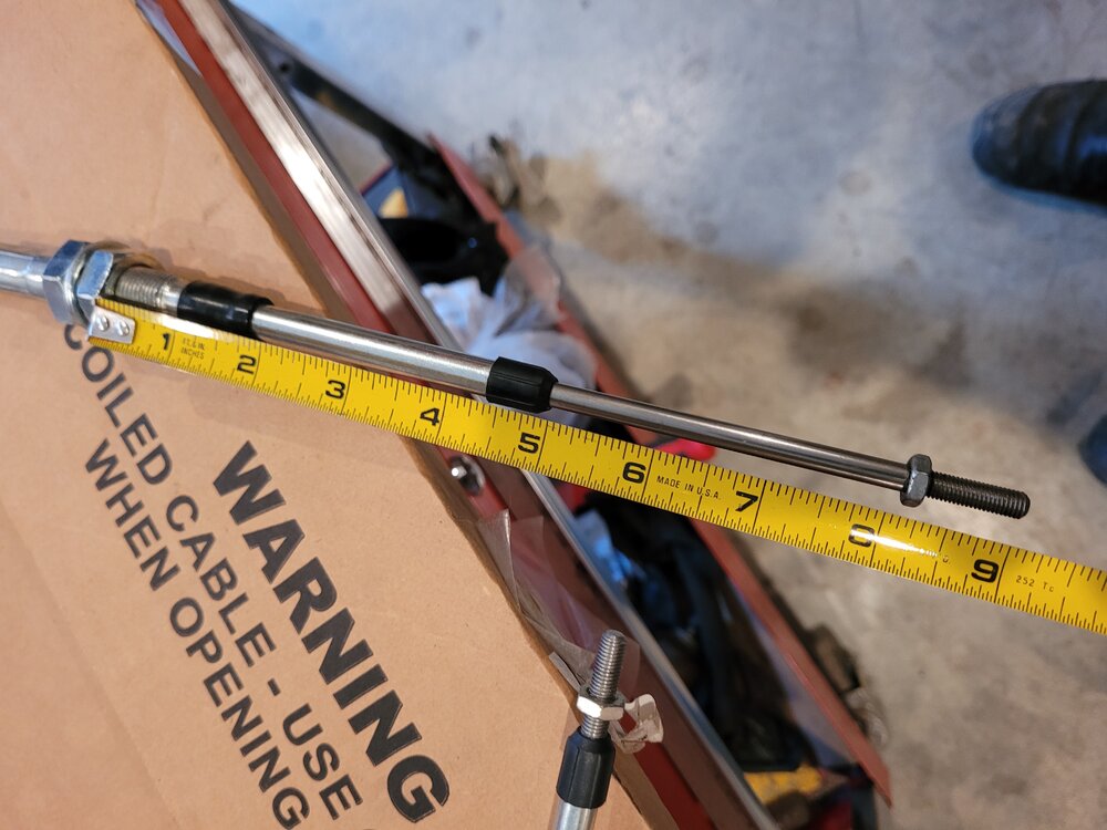

What size and lengths are the ends? I have a couple new ones i bought off here for my dana 300. Bought 4 and used 2. They have been great.
These have 1/4-28 ends and, i think, have 3" of travel. They may be too short though. The blue is 48"
Tried to measure the threaded ends, but haven't extrapolated the decimal values to an actual threaded size 🙄 Pretty sure it's 3" of stroke/actuation though 🤔
