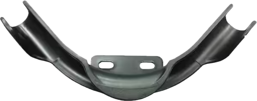

My only recommendation is with a flexible product like pex always try to reduce fittings by radiusing corners instead of using 90s, there are plastic or metal clips that hold a 90. Each fitting is a potential leak so I’d use the advantage of a flexible material everywhere you can.

I used those bend things when I re did everything above the water heater/under my shower on leak number 4, they are definitely nice. I also plan on using some manifolds halfway down the hot water/cold line under my kitchen, and at the end where the other bathrooms are to cut down on fittings. Figuring out WTF is going on with the branch lines will be fun, I have hot water lines running to places where I don't have hot water and stuff like that. I have an opportunity to simplify the system I think. I did after all spend all day today in YouTube university after all, lol.
