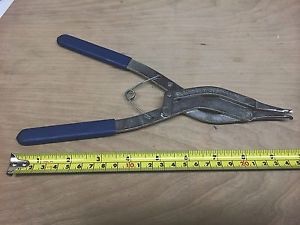

Those are the best I have ever used. The jaws open parallel.
All I used to rebuild an ax15.
I've seen them under bluepoint, Proto, and Blackhawk Brandings, all the same.

Makes sense, Blackhawk and Proto are common ownership, and Proto makes private label tools for SnapOn and Blue Point.

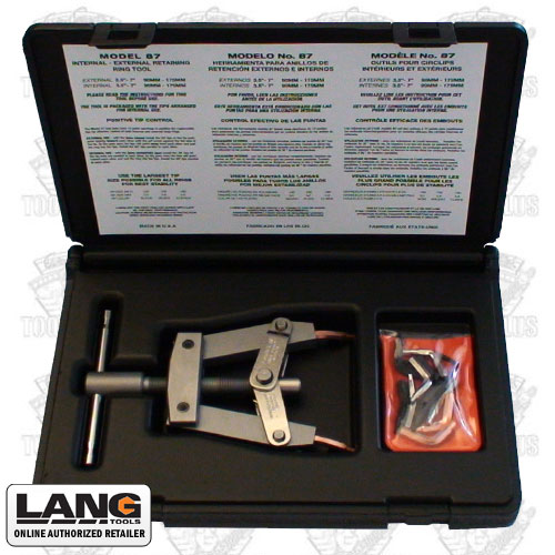

This is what I have except that they are pliers. I like the continued holding power of the screw style though.
Those are snap ring pliers. I think I bought the same pair at advance but not sure how much they were. Must have for sye/tc/trans repairs.

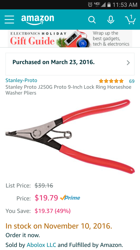

Snap rings - typically beveled ends, no holes
Retaining rings/circlips - holes at end of rings to allow tool pin end insertion
Small technical difference, big application difference. Typically snap rings are thicker than circlips.
Untechnical information: those can be used to remove or install circlips with varied levels of frustration depending on exact application.
i have both internal and external sets of these, they work well, but not for all situations. the tips tend to be a bit to long in some applications and cause the pliers to get hung up on the ring.
they're great for what they are, but not end all be all
EDIT let me add also, if you have the opportunity , buy these from a tool vendor, you WILL need to warranty them at some point, a lot less hassle going thru the truck. (probably not any faster)
