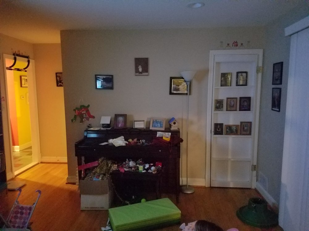

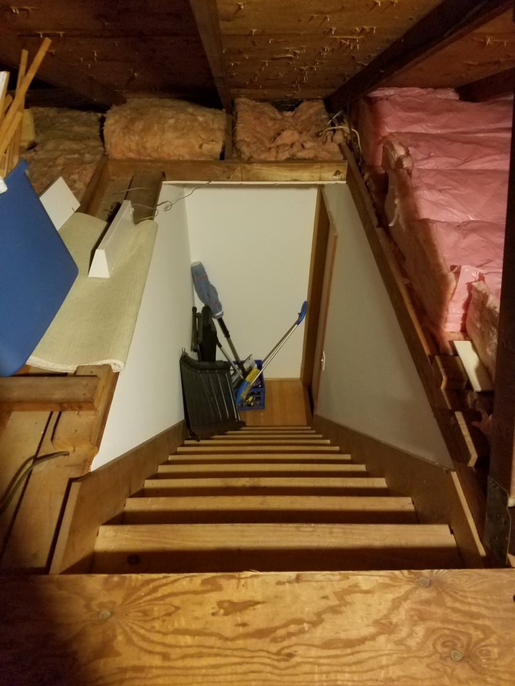

Pics. The hinged shelves on tbe right are the door, so the stairs run a diagonal from lower right to upper left behind that wall.
Oh, yeah, it's about time to put away the Christmas crap.

Insulate like crazy. Make the hatch usable but only in an emergency......build storage building. With the low ceiling and challenges I would put my material dollars in better storage else where......if it's in another less climate controlled space it can't be much different then the attic in the summer or winter.
I have an attic space similar in a rent house. The biggest difference is the roof has a stupid pitch and the space is litterally a bonus room. Blown insulation. Raised sub floor. Pull down ladder. Only thing I would add is a glued up frame/ lid for the ladder out of blueboard. The house is pretty tight otherwise so I haven't bothered.
My mom's house is like yours. A very insulated crawl space on the top.....I hate crawl spaces the older I get.
