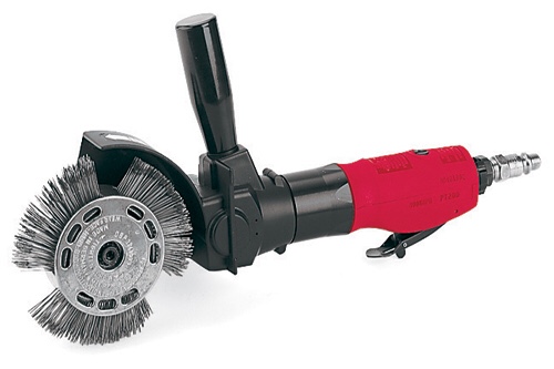

Snapon crud thug... Aka wire wheel only beefier.
