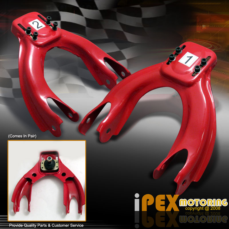

Got a customer bringing their kids car in for some work. It's a 99 civic coupe that has been lowered. It need's a camber correction of some kind in the rear. Does anyone make a "kit' to fix this issue? She is wearing tires out (unevenly) in the rear because of the camber being off. Any help...anyone...anyone....Bueller????

here ya go
google search it. There are a bunch of differnt kits out there. I think the Skunk2 kit was 250 and most others are a bit cheaper. Skunk2 is good stuff when it comes to the ricers.
Specialty products has kit 67030 run you about 85 bucks a side and gives you -2.00 to +5.00 camber.
how in the hell would that work?
those 4 tiny ass set screws wouldnt hold any side load at all....
