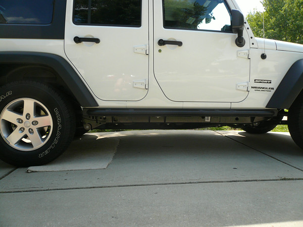

Alright, got the Smittybilt #76639 rock rails: "Classic Rail with Step". Sourced locally from 4WheelParts (thanks Ryan!). Packaging was solid, finish is crinkle black and looks good. Seems like it'll hold up for my mild fire roads and hunting trails; will probably withstand much heavier use than we will dish out.
Here's a pic to begin:

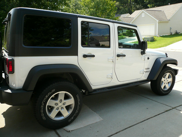

This is the angle no one shows online (basically fit exactly like the Mopar Enhanced Rock Rail):
And the last shot:
If it weren't for the shadow and my bad photography, you would notice these fit very close to the rocker panel- the inner rail is literally almost touching. Again, fit like Mopar rails on Rubicon package or the "Enhanced" Mopar version.
So, mounting required one trip to my parts bin. I ditched the included #10 washers and replaced them with 1/4" washers that won't pull through mount holes in pinch seam. In contrast with others' experiences, these Smittybilt rails did not require any drilling or dremeling. One tab required a slight tweak, no worries!
Finally, the step is fully functional, there's no BS girder hanging down, and mounting was a breeze on the 2014 JKU with my son helping to line up the rails. At the $349 price I can't imagine handing over $700+ for the Mopar Enhanced...
those look great.
I like how it covers the pinch seam close to the body like the Rubicon rails.
