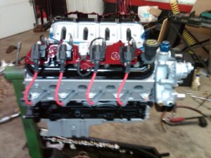

here is the motor almost complete still waiting on a couple parts and brackets. The Atlas will be in next week and we will set everything in and maybe get the suspension done
Going to be sick! Nice work man.
