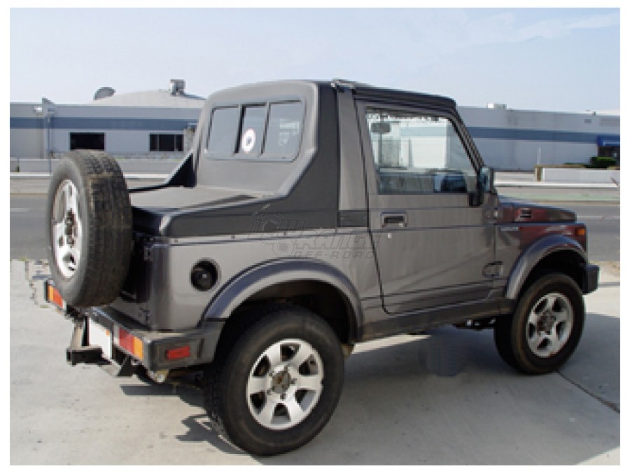

For a samurai, what sort of ball park am i looking at for a cage? $500, $750, $1000? Basic cage, mainly the cab area as my sami has a RallyTops Sport top on it.
Here is what the top looks like. Not my sami. mine is uglier and less shiney
alghttp.14077.nexcesscdn.net_806AE0_Magento_media_catalog_prod4faf8dc3e92367ee26caaf97822263dc.jpg

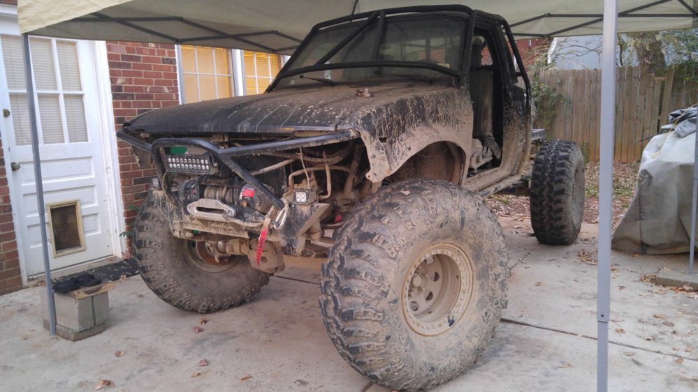

Got this tube work done and tunnel and cab floor for less than a G. Supplied tube though. Metalworx is the shiznit, Scott, i believe it is, went over and beyond to make us happy, even rebuilt stinger after in progress pictures. Let Scott do it and you will be happy. I can post more pics if you're interested.
