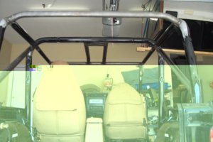

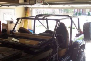

You guys that wheel with your kids, what do you do to mount the car seats?
I'm not talking about infants, my daughter is almost four and loves to go riding in the Jeep (not on the road, around the back yard).
I am fixing to build a cage for the Jeep (M715) and was just looking for ideas.
Pictures would be great!
Thanks
BBB

My son is almost four and he has gone to almost every trail ride I have done since he was able to walk. He rides the trails with me and my wife set up in the rear center of our TJ. I have a standard Poison Spider full cage. He and the wife always get out at obstacles. It is not worth the risk and he likes to watch more than participate in the difficult stuff. Currently he is set up an a Bestop replacement CJ seat bolted down and then his car seat strapped down to that and the Jeep. I am planning on switching him to a suspension seat soon.

My ranger is getting a 3rd seat in the new ex-cab. It will be mounted as far back as it can go in the between the front seats. It will not be a real seat but more of a place to mount a car seat. Thinking of using one of the jump seats to build it so it can fold up out of the way when she is not rideing with me.

I personally was just curious about what you guys had done/built. Since my M715 is convertible (and NO seat belts), I am going to do the cage before I even ride her on the road in it.

My buggy chassis was desined around two kids sized PRP seats and I have 4 point Y'd harnesses to hold them in place.
Got the idea from a guy in Charleston SC who had the rear cage built to hold two PRP seats for his kids in a TJ.
I say, build a cage around em, attach the seats to lower cross bars tied to the cage, and put some harnesses in. I would also put some rangler nets in to keep debree or rocks from hitting them. I used to use soft handles on the bar behind my seat so the kids could hold onto something in case of a roll without putting there arms outside the cage.
