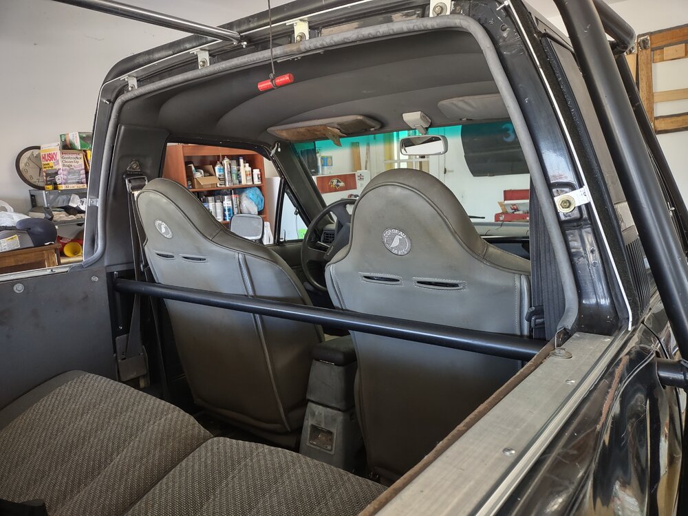

The cage spreader bar behind the seats in my 4Runner make getting into the back seat a real pain in the butt.
I've come to accept that it isn't going to be used for any serious 4wheeling or racing in the near future.
I'd like to cut the ends of the bar just inside the interior and add fittings so it can be replaced if needed.
Any suggestions?
