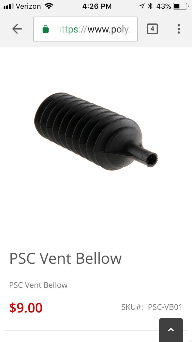

After my recent roll over I’m installing a ball valve with check valve on fuel tank vent. Also installing vent bellows on everything else.

The psc unit is a very small can with the filter on it and check valve built in, but it's $75. So I was hoping someone had info for a cheaper piece.
I’d just run vent bellows on everything except fuel, this way can account for temp cycles with no fluid loss or contamination. Fuel needs a vent ran past the tank in every direct with a roll over valve.

I've always heard top stay away from the bellows as they may not expand enough and begin to pressurize. But I've never ran them so I'm just playing web wheeler here.
