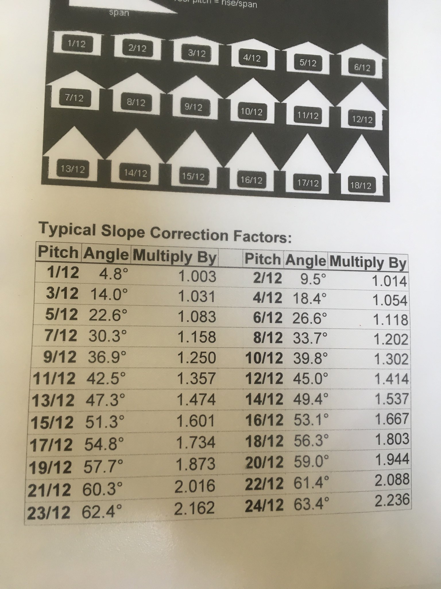

If you know the roof pitch I can give you a multiplier that should get you in the ball park of sq footage
Should be 275-325 per square of shingles depending on type of shingles
Edit:
See picture below
