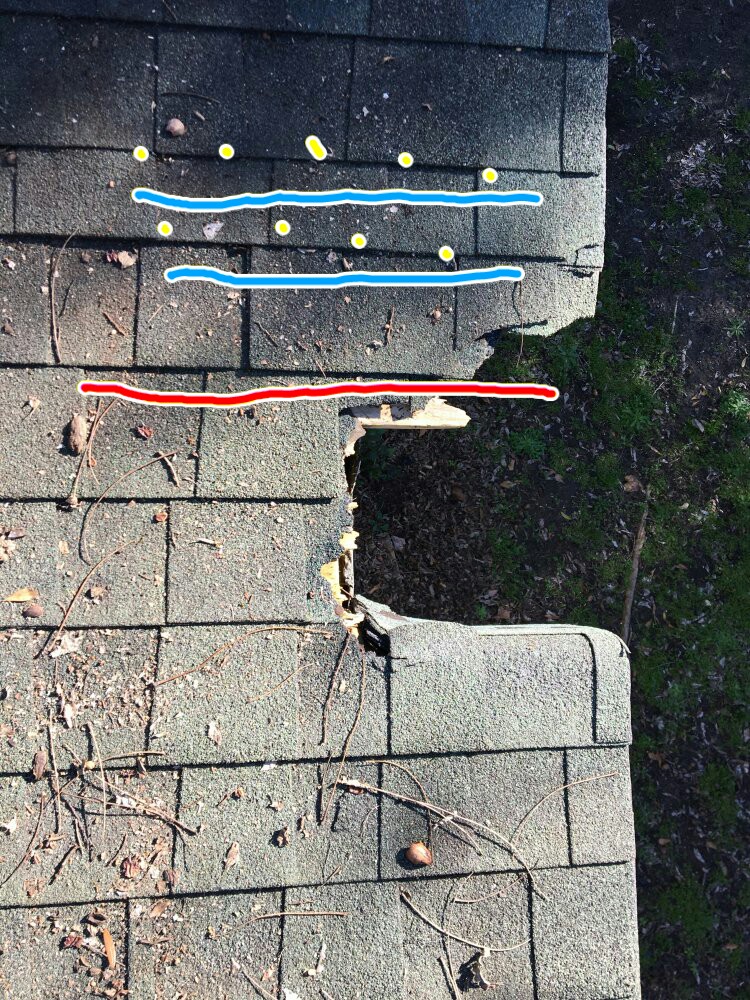

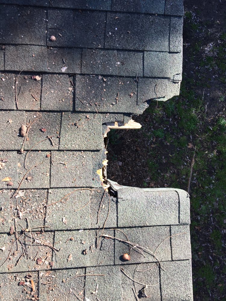

So this pecan limb did a number on the shop roof. Thought I’d pull just enough shingles to replace the two boards it broke. However with the way they are interlaced I’m now trying to figure out how to not remove them all. Suggestions?

Yes that is what I found. They are layered and staggered which I knew they should be. Also found a rotten board above the break. So this is going to quickly snowball I fear....
@ghost, Flat bar, thin putty knife warm sunshine and take your time, or you will be replacing more of them than you want.
Putty knife on the blue lines to work them loose and save those shingles (this is when the warm sunshine helps). Long flat bar under the red line to work those two rows upper nails lose ( then pull them out from the top side with flat bar).....

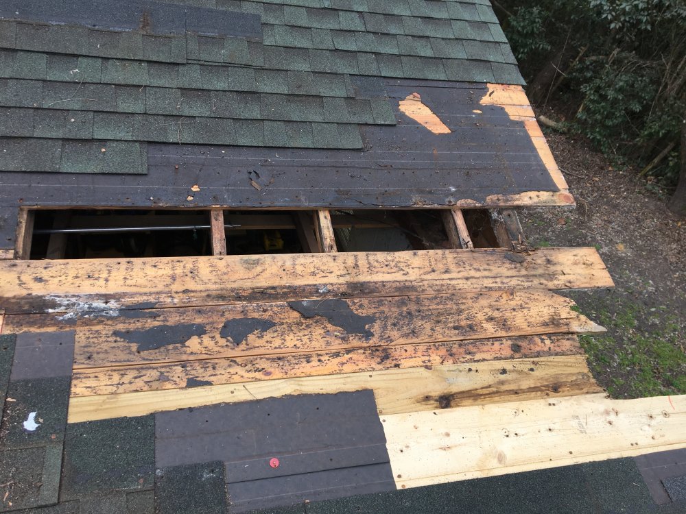

That is pretty much what I learned. I made some good progress before dark. Unfortunatly I found a couple rotten boards so it looks like it's about to snowball.....
