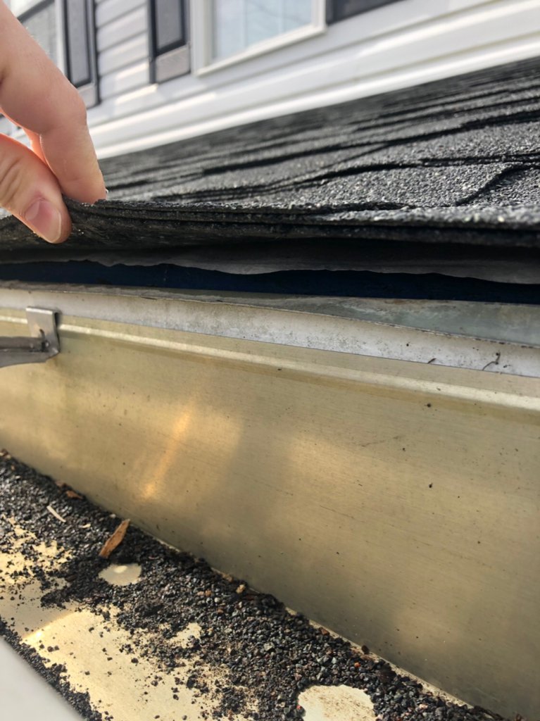

Roof got pretty tore up by the hurricane. I tarped it up and had to leave town. Finally got the insurance check and roofers came out.

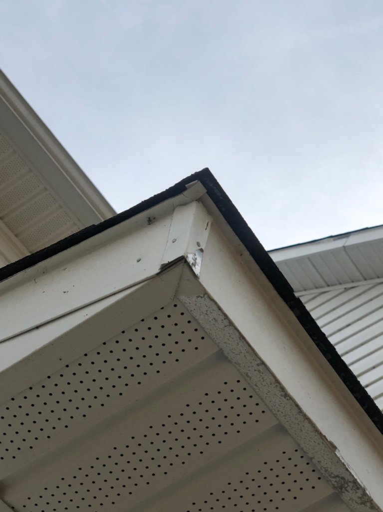

My problem is we have a fascia with a 90 degree lip that sticks out at the top so the roofers didn’t install drip edge because they said it wouldn’t fit. They are trying to charge me $800 for the drip edge saying the quote is just “semantics for the insurance adjuster” which is just silly tits of them to think I would agree with that.
So my question is should I have my fascia redone now to accommodate the new drip edge? As it sits some of the OSB is exposed and I think the water would easily get in there.

Is this gonna be fine or what?

We don't have a drip edge, just a shingle overhang and the edge of the roof deck is exposed if you lift the shingles. Not my favorite, but has worked fine for 30 years on the house. I asked a roofer about it (the lack of drip edge) during a few repairs, and he said it was pretty common and was unconcerned about not having one.
To me it looks like there never was a drip edge and someone used the fascia metal/vinyl to trim that out like a drip edge.
I’d have the fascia redone and a drip edge put in. To each their own I guess but that’s the right way.

I think this is what I’m going to do. I’m getting a quote for new fascia and then have the roofers do the drip edge. I normally wouldn’t care but I can see the edges of the OSB swelled up a little from being exposed...

No shingle manufacturer will say it's ok to exclude drip edge.
I agree with frankenyoter. Anyone with a brake can make a custom profile drop edge in no time at all. Saying it wouldn't fit is bull

I’m with you. I read the shingle mfr warranty and it specifically states the use of the same mfr drip edge is required for the “50 year” warranty that the roofer throws around. I don’t know how much of that warranty is sales hype but it backed the roofer into the corner a bit. I’m getting new fascia or the appropriate drip edge either way and then they’ll get their money.
