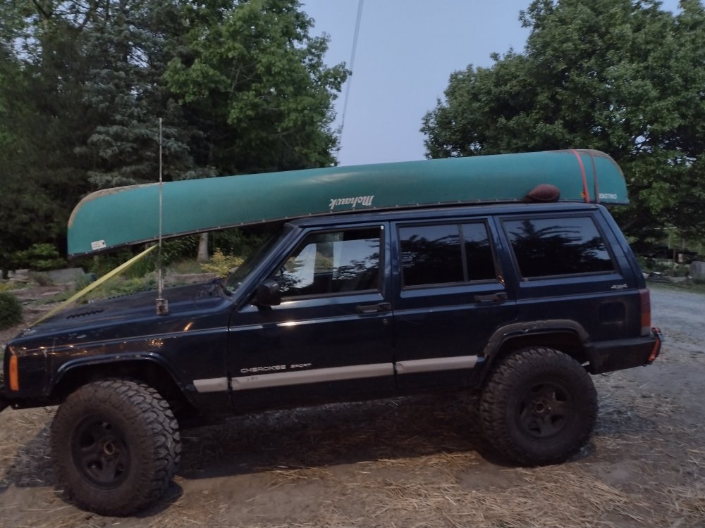

Sucker jumped on my roof & demanded to come home with me. About 25 years old. It's been down the river a few times. Scrapes & dents don't concern me much. There are some places that appear to have a crack thru at least the first layer. No apparent delamination. Any tips &/or tricks for addressing the cracks? Or should I just send it?
