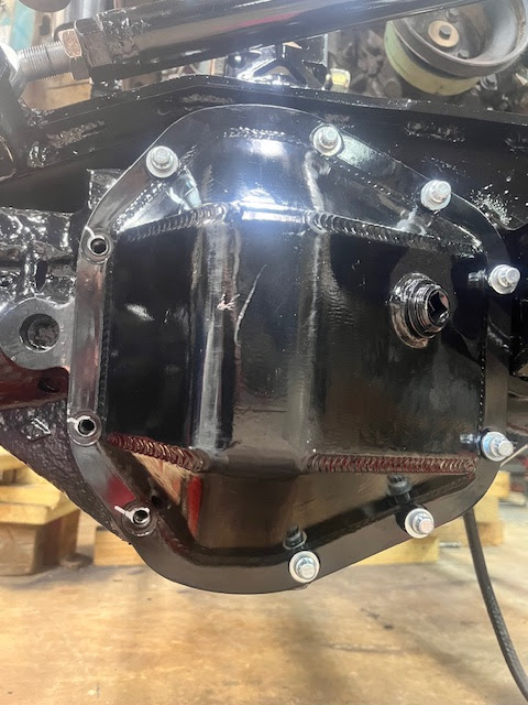

Paint the cover and Put it on.
Fill with fluid.

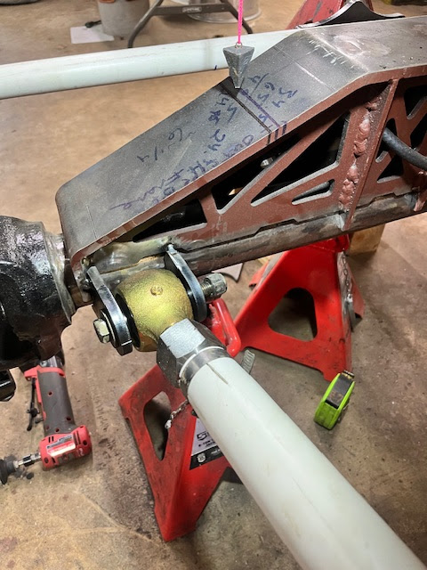

Build permanent lower links pan bar, and top link, (PVC now)

Front diff: put my Dana 60 differential cover on and fill with oil.

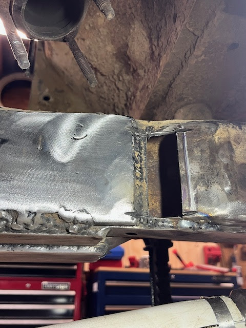

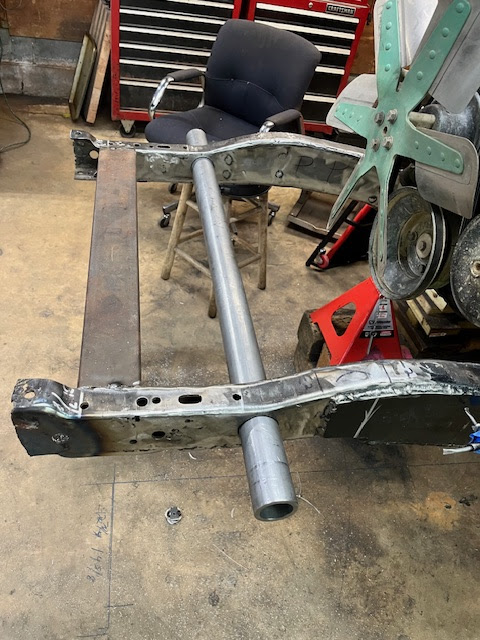

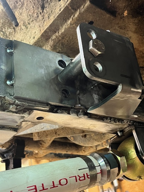

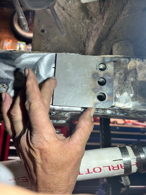

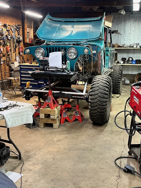

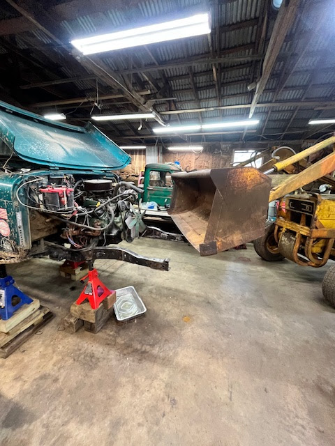

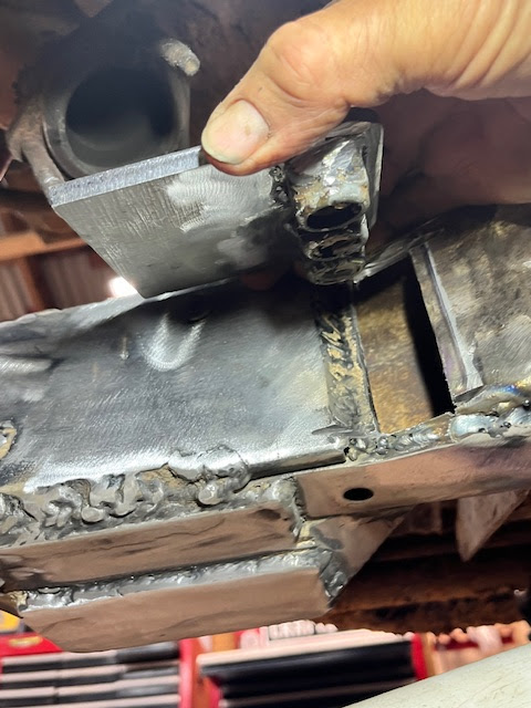

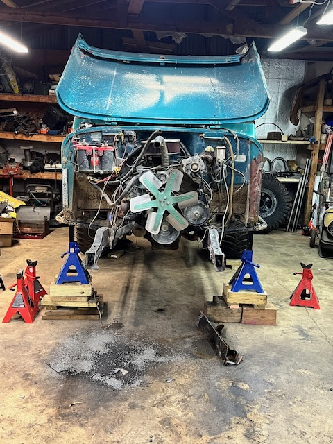

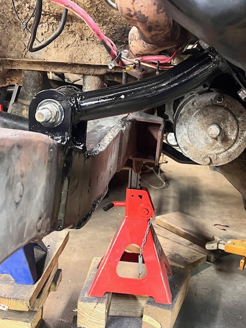

Since our last installment things went kinda south. While checking placement for the front top link I finally saw why my motor was tilted. Frame twist/bend. I knew there was an issue but could never put my eyes on the exact problem. As I was looking down the frame from the front I saw it. Right side rail is bowed outwards some and drivers side is about an inch higher than the passenger side. So I got my trusty old Ford 340 and mashed on it with a few strategically placed jack stands to send the bends where I wanted it...hopefully. It didnt work perfectly but its a lot closer now. The original cross member was in bad shape and in the way of the upper mounts on the axle so it had to go.

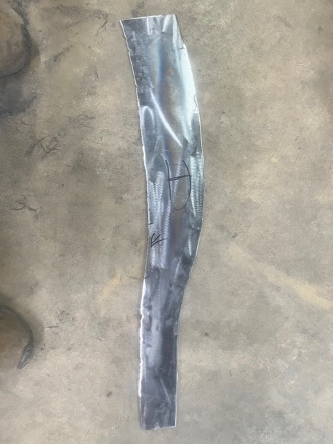

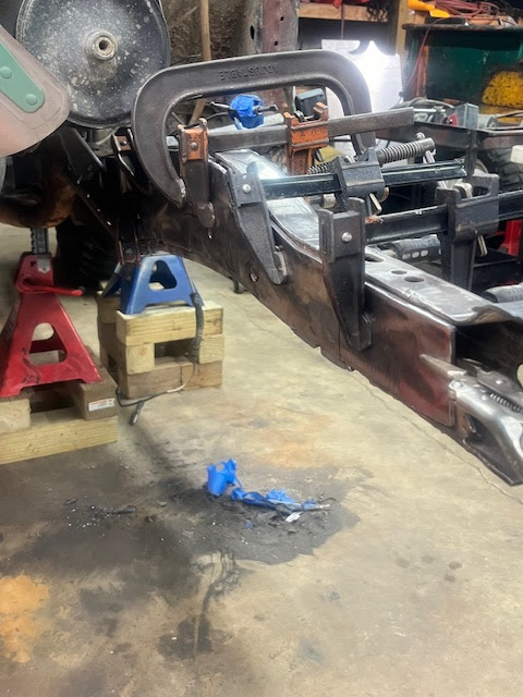

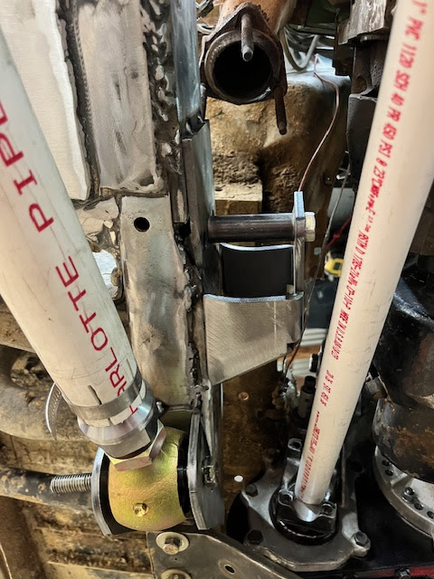

Jeepster frames are fairly thin so I boxed it with an emergency steel order (thanks @DannyH ) and was able to put the new cross member in place. Once it is burned in I can go back a few weeks to final link mount placement and cycling the 60 and hopefully moving forward after that.
This square tube is just tacked in to keep rails in place and the right distance apart. The 2" DOM is the new cross member

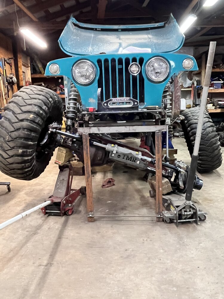

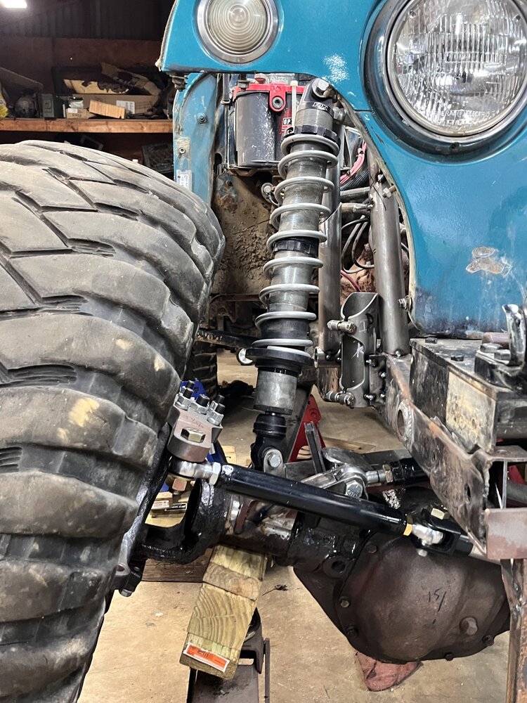

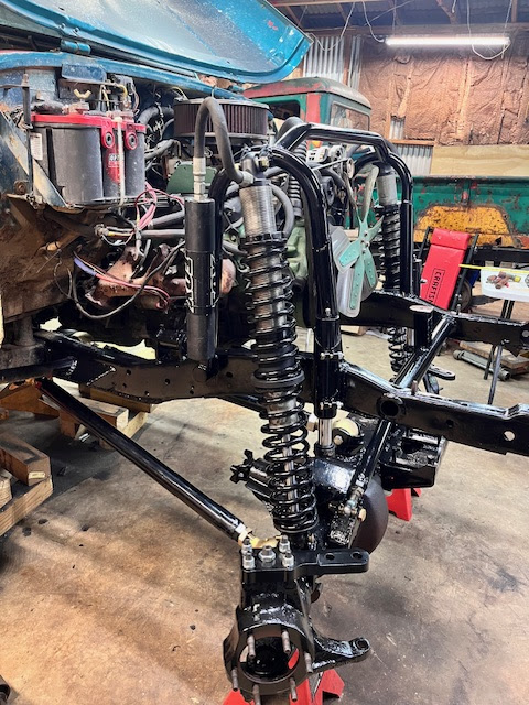

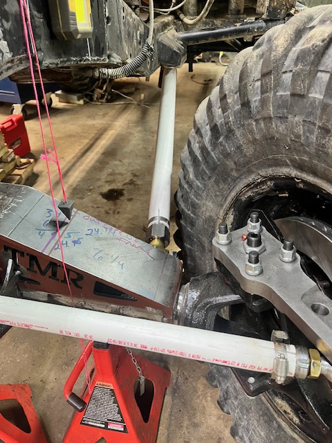

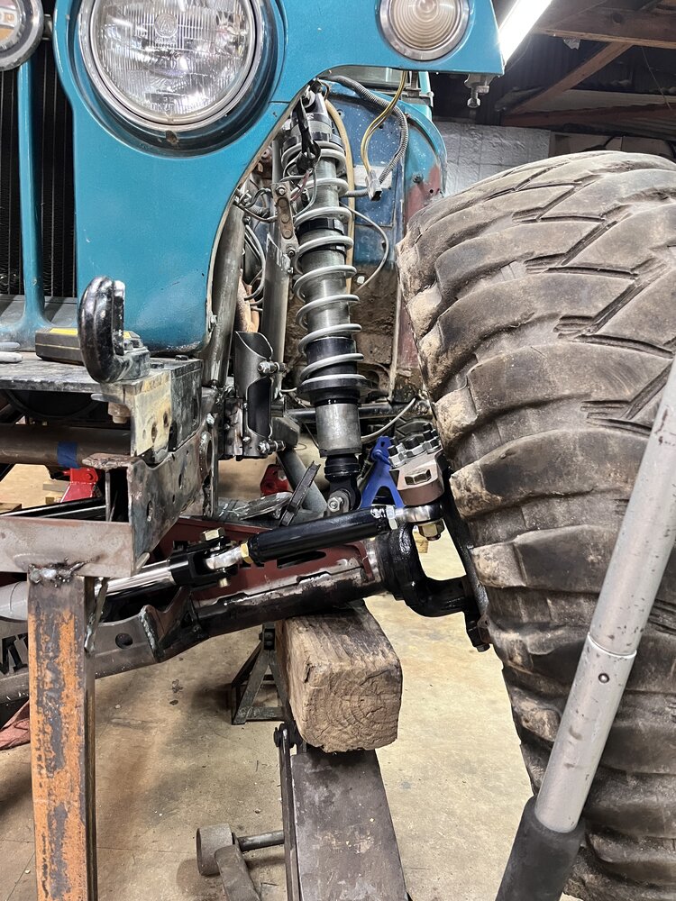

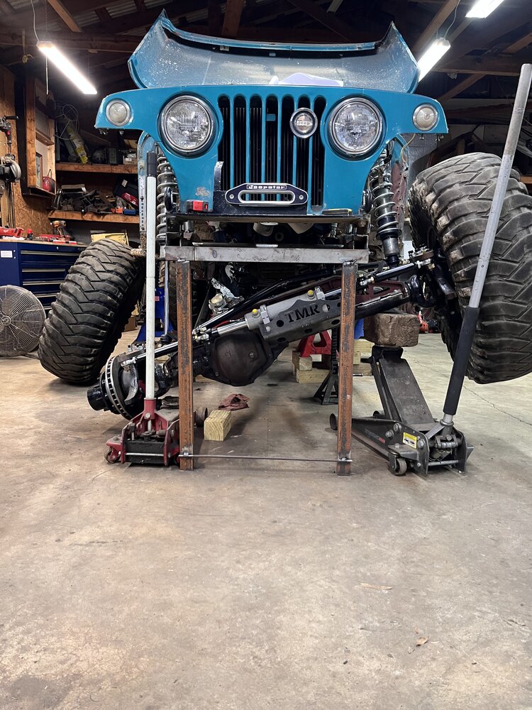

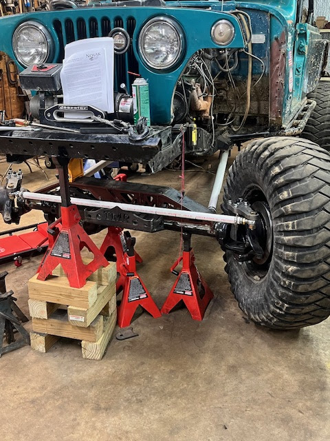

Front clip is on for now so I can figure out plumbing. Top springs are a little soft but the 200#s were too stiff so I put some 125#s on that I had for now.

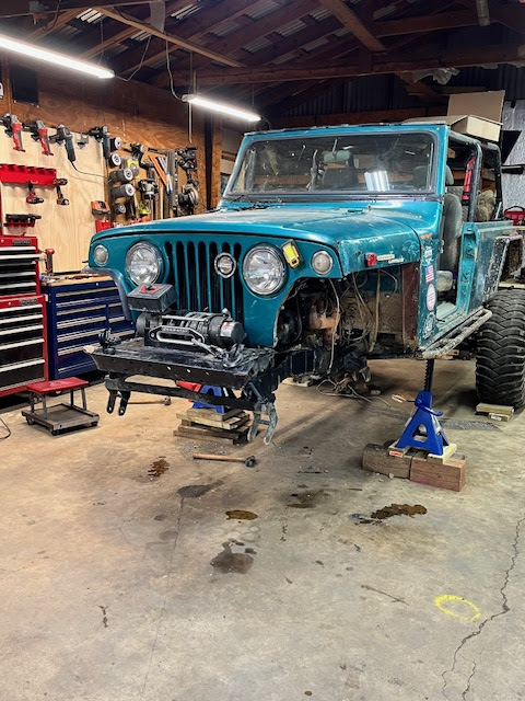

Side shot. Now I've got to dig into the rear and redo the shock mounts and get it all squared up but I'm getting closer and can finally see the end of the tunnel. I like the stance. Still have to build some front fenders.
Looks sweet and you are gonna run 40's on this giant?!!
