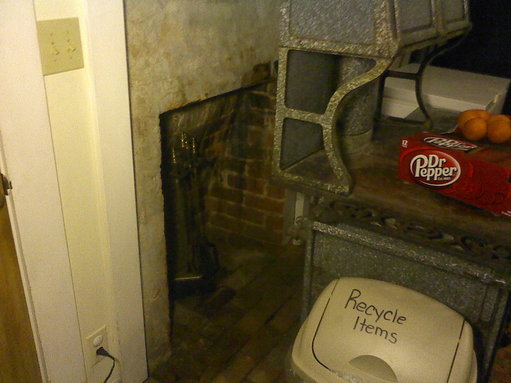

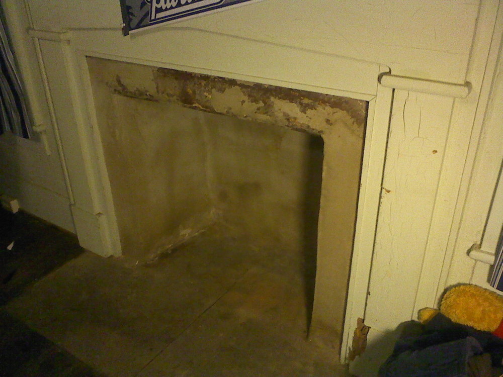

Four drafty dangerous 1890's fireplaces.:eek:ops:

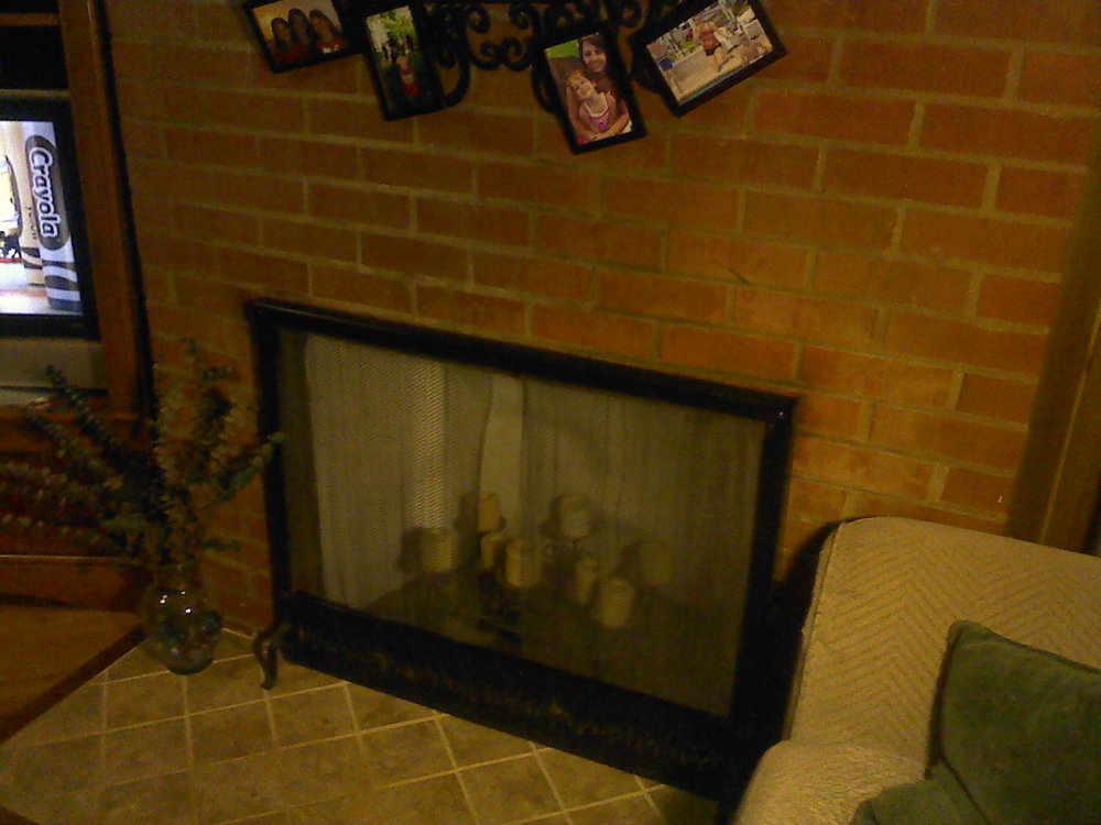

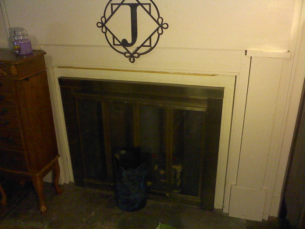

One 1910's with the glass doors and screen. Now plumbed with flu pipe for oil furnace!:confused:

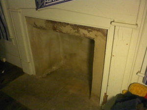

One 1950's was the front porch. Changed when the indoor plumbing arrived. Just a screen. :(

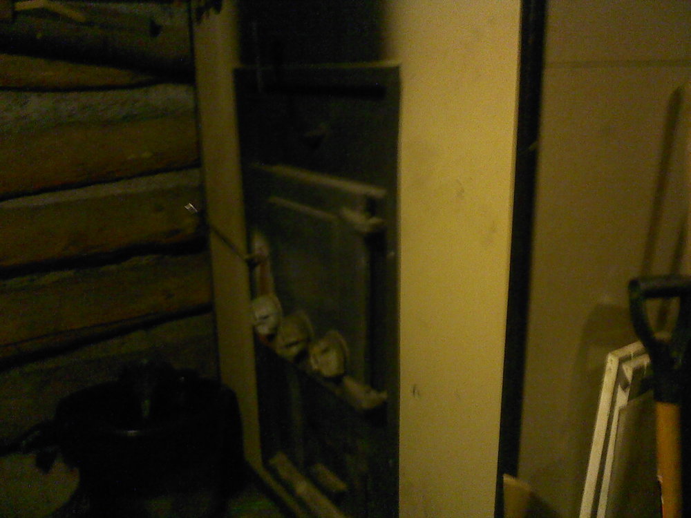

One when the kitchen was added to the house some time between 1910-1930. Notice the later technology plumbed into the chimney in front!;)

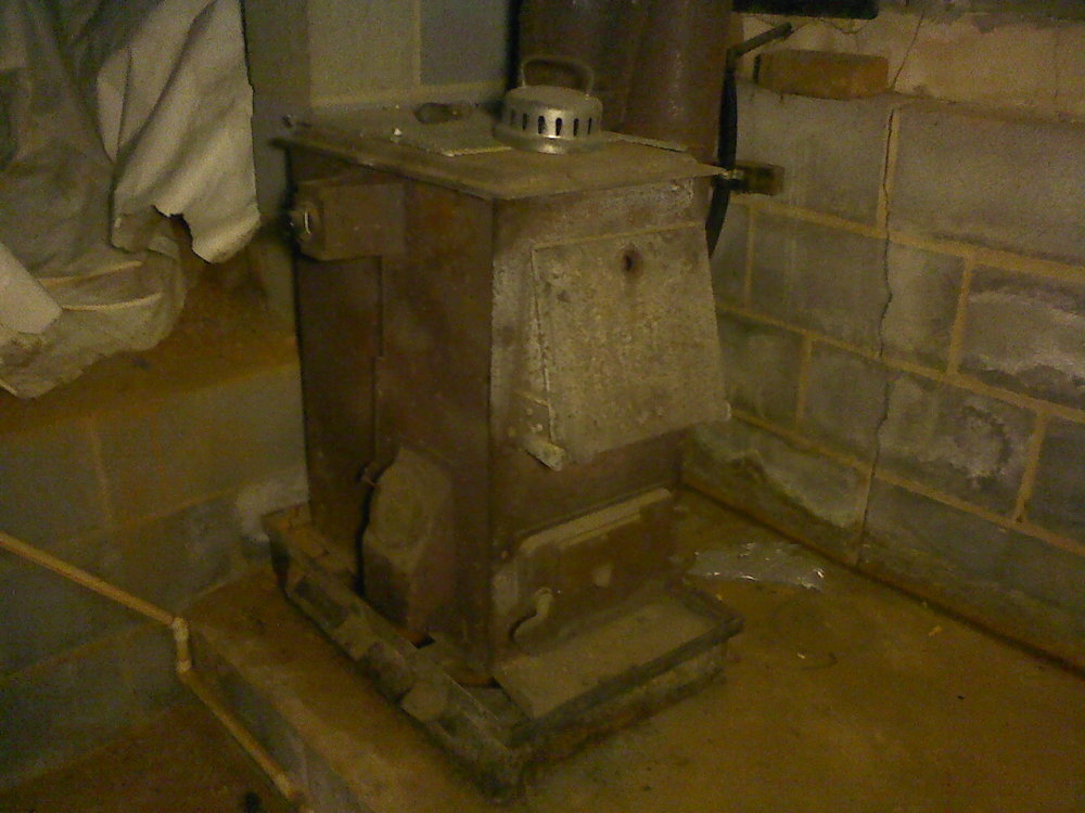

And now the best modern alternative to heating a pieced up drafty very old house. Which is located in a old wood fired smoke house. Go figure.:lol:

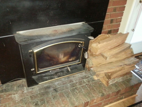

i have a "smallish" wood stove insert and a 1680 sq. ft. ranch.
I typically burn about 1 cord a year as I only burn it during the coldest days to reduce my gas bill.
if all of the bedroom doors are open, on a 10-20 degree night, the main room will stay at 78-80 degrees and the bedrooms 74-76 degrees. I have ceiling fans in all rooms and I leave them on low to circulate the heat.
whenever you open the door to either get the fire going or add wood MAKE SURE THE DAMPER IS OPEN ALL THE WAY OR YOUR HOUSE WILL FILL UP WITH SMOKE. as you can see in the pic my back door is right next to the fireplace and i'll crack that open a tiny bit when I get the fire going. it helps the heat column go up the chimney quicker (cold air - and especially moist cold air - is dense).
like mentioned, you can "choke" it down to slow the burning process. I can stuff mine full of wood at midnight and it'll go all night. i'll have to either top it off at 5-6am if it's a cold day or just throw a couple on to keep it going until the evening. I can only burn it 4-5 days straight (maybe more haven't tried yet) until the ash bed gets to the point where you want to empty it.
BUY A STEEL BUCKET so you can shovel out the ashes and dump them outside - be prepared to hose them down, they can smolder for A LONG TIME - POSSIBLY A DAY OR SO WHEN IN THE STOVE.
that's all that comes to mind off the top of my head. good luck and enjoy! :)
edit - oh yeah, this insert (like most) has a blower - it's tstat controlled with an override and a separate variable fan speed knob.
