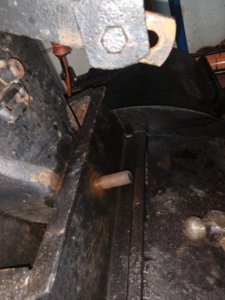

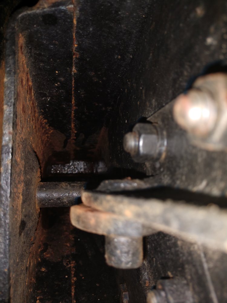

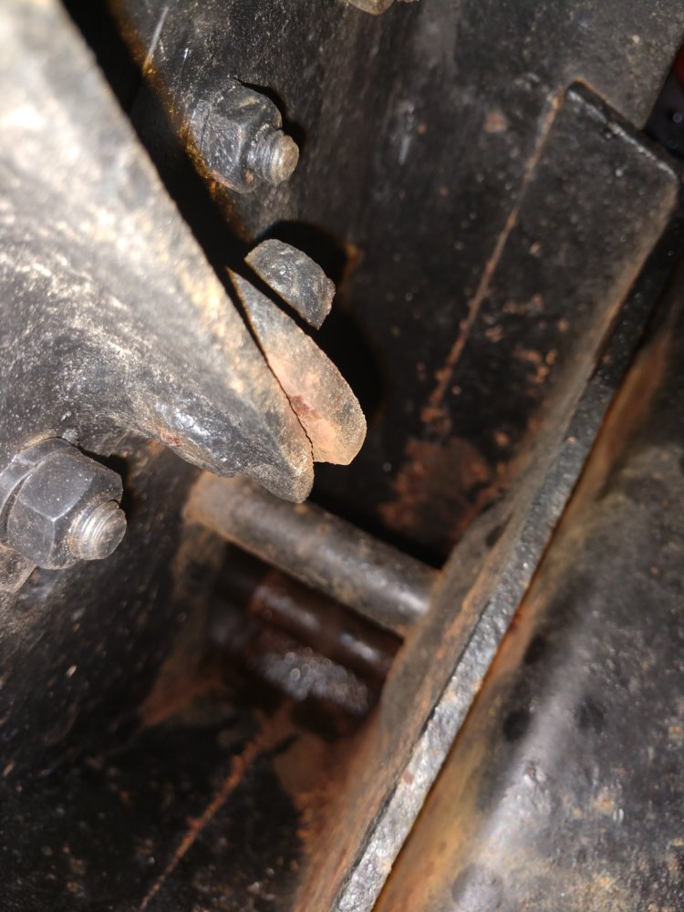

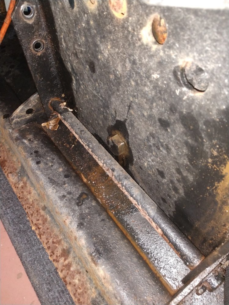

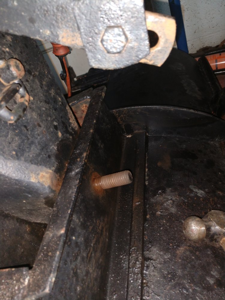

I have a 3/4" bolt, stuck with rust, that I need to break loose & remove. It's up inside a mount on a push blade. So far my 1/2 impact, hasn't budged it. Been soaking for 2-3 days with WD40. I know the general tips like More power, & Heat. Just wondering what you Metallurgist, have done? Anyone tried the WD Rust spray? I'd like to reuse this bolt, just need it out for now. I spent an hour today, drilling out a rust welded cotter pin! I can get Heat to the bolt, but not so much the metal it's froze in. In the pictures, it will be the Wet looking bolt.

It Did soak in ATF & Acetone, for 2--3 days. And probably a little Wintergreen too. I Finally got back to it. First tried my impact in reverse, no luck. Added more lube, & hit Forward. It barely started moving! Couple more switches & oiling the spaces, & it was spinning wide open. Knocked it as far as i could with the nut & hammer, then used a punch. Once out & separated, I found the bolt is in a sleeve. That & 4 sections of 1/16 steel, with rust! No grease fitting. Now i can tell, I'll need to either build a mount section to the tractor, or maybe highly modify what I have. Just something Else to do! Btw, Kriol probably would have done the same, at the same cost, or less. Or Matt's Milwaukee! I got another cotter pin to get out, which has Not loosened. That bitch is going to get a Torch!:kaioken:
