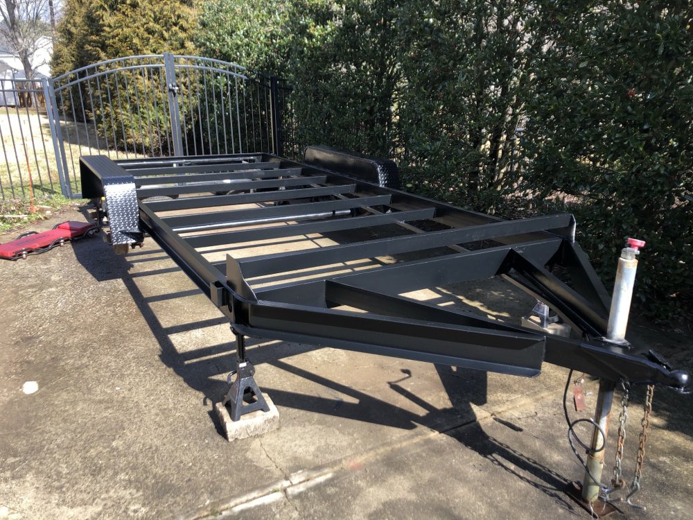

Instead, I cleared my work schedule and took this morning off. It was >50*, dry and even sunny at times! I pulled the rims after dropping the frame onto jackstands. I finished a little priming then started rolling away! Turned out awesome!
Tires later this eeek, wiring this weekend and deck next week... then I’m hauling my CJ7 wherever we want to go.

I used quarts and a few of the professional rusty metal spray cans. I then used the regular satin black “stop rust” quarts and spray cans.

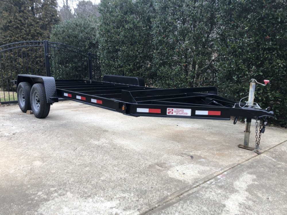

Trailer almost finished...

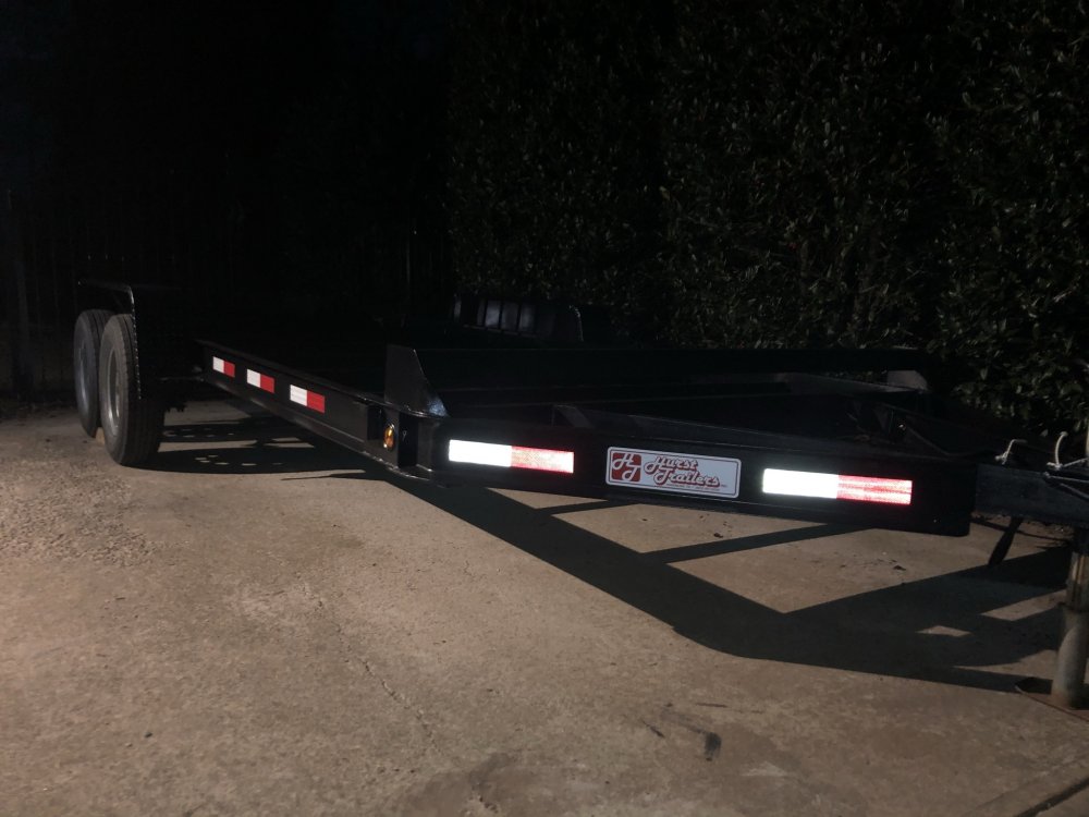

New reflective tape and labels
New wiring and LED lights installed
New bearings, races, seals all around
New trailer plug and junction box
New tires on freshly painted rims

I’ll get a daytime pic tomorrow...
