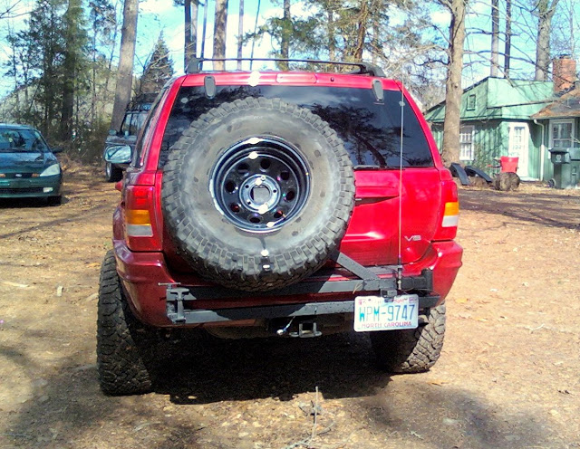

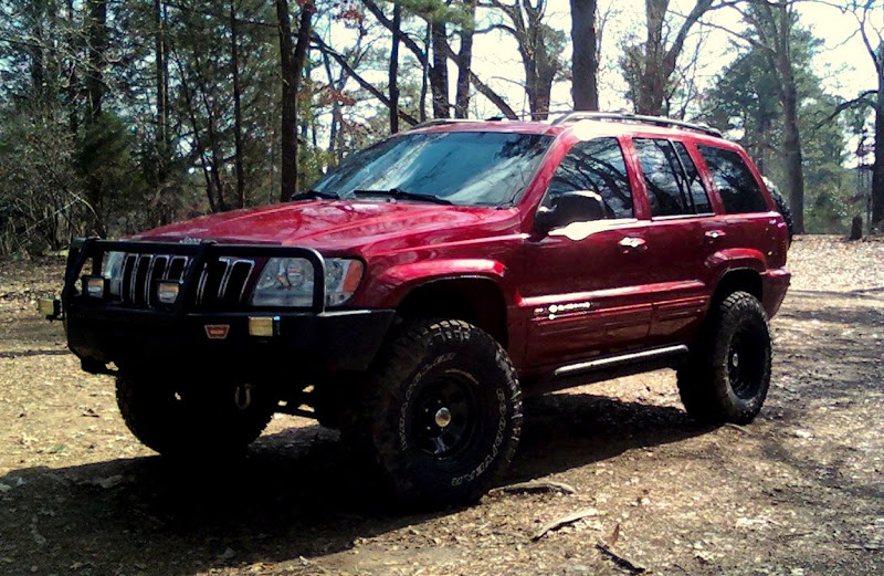

Its a WJ
The tires are goodyear wrangler duratrac's 33x12.5x15
I got them to replace my km's
They are super quiet.. so far have not done any serious wheeling with them, I just got them a month ago, but I have done some riding around in rough/muddy trails during deer season, and some snow action, and they seem pretty good. I just got tired of the noise w the KM's. I sold my DD (a 1992 saab) for a $1000 profit and decided to put the money towards some things to make the jeep more street friendly.
The specs
Engine/Trans
Homemade K&N Filter Intake
Flowmaster 50 muffler
Transgo HD2 Shift Kit for the 545RFE
Most Recent Mopar Solenoid Pack
Factory Tow Pkg. with external Tranny and Power steering coolers
D44a
3.73 gears
Vari-Lok diffs (not great but definitely better than my last open/open jeep)
Suspension
IRO 4" Springs
Rancho 9000 Shocks
Adj. Rear LCA's
A-Arm Spacer
Wheels/Tires
Cragar Soft8 15x8 4"BS
33x12.5x15 Goodyear Duratracs
Steering
Dual SS
JKS Trackbar W kevins firm bushings
Goodies
Spare Parts, Tools, Hi-lift, Tow Straps
Cobra 70 CB radio
new speakers, head unit
Rear Tire Carrier
Armor
T-case Skid
ARB Winch Bumper
Custom, welded sliders

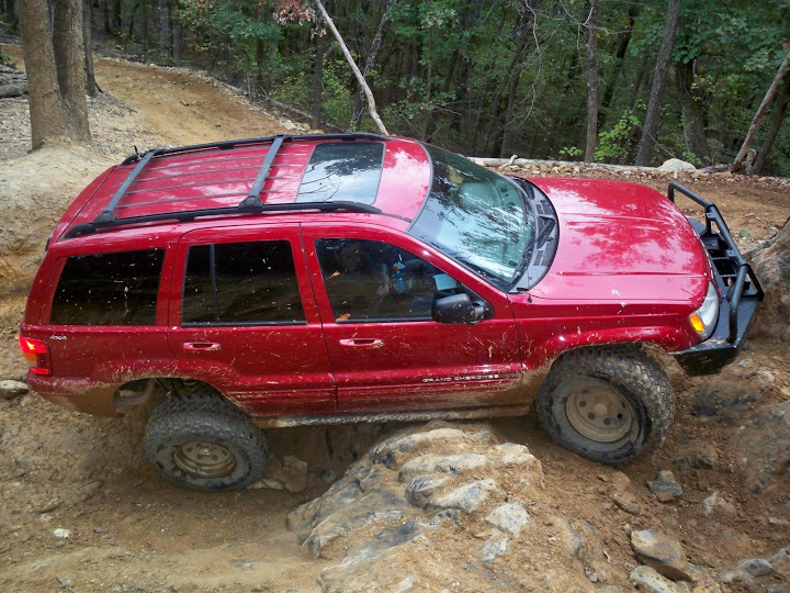

nice jeep. glad to see you wheel it, i don't think i would have the testicular fortitude to wheel something so clean/nice/new
thanks guys
its got about 150K and only has a year or so left as a DD... getting a newer truck, f-150 or similar... going to keep it stock (maybe an intake and a leveling kit haha) and keep the WJ for wheeling
Good looking WJ man.....beat on it.
Nice! x2 on wheeling something that nice. I'd be so scared about messing it up that I wouldn't be able to have any fun with it. But I do like the look of a lifted Grand Cherokee. Just don't do this to it...
Is the D44a the one with the aluminum housing? If so, how is it holding up? And do you have any front tow points on that ARB bumper?
Oh the D44a is holding up nicely. From what I understand the aluminum center is more susceptible to rock damage but the overall strength of the axle is pretty good. I haven't had any issues with it and the few times i have hit the pumpkin on rocks it hasn't done much damage.
I do have tow points, there is a shackle hanging off the drivers side, not visible in the pic
Actually just put one of those 8000lb smittybilt winches on it yesterday too
