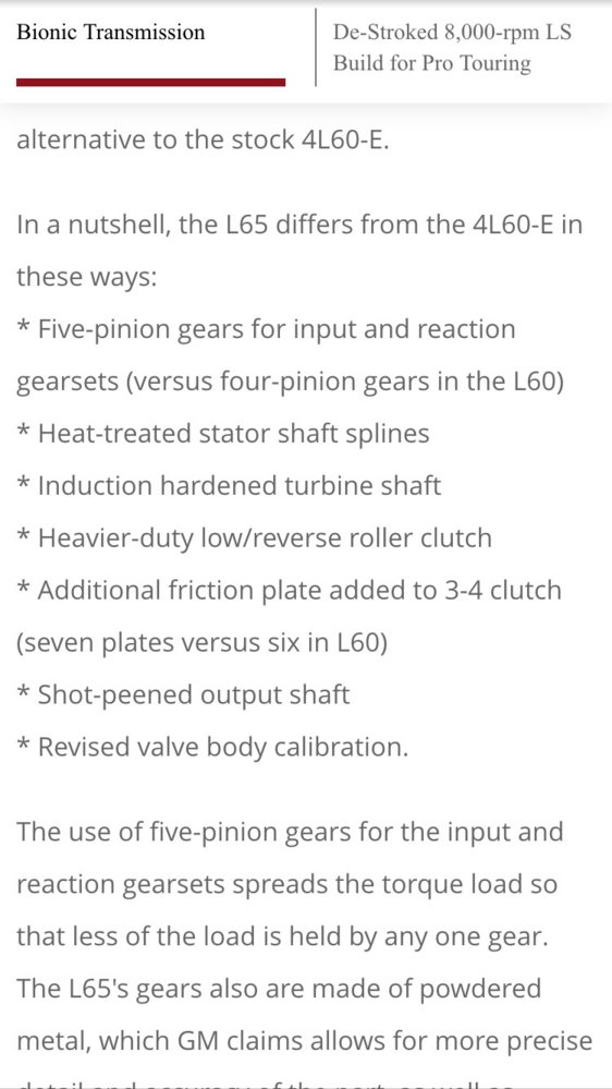

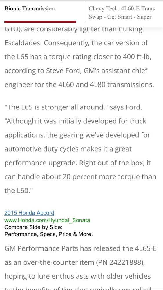

Heavier duty version of the 60.

sorry ron, just saw this. the 4l65e will be just fine. as far as differences between that and the 4l60e, i'm not sure about the hardened shafts and crap like that, i just know it has 5 pinion planets instead of 4 pinion. either way, it's rare when they come in with broke planets (unless it's lack of lube or sungear,sunshell damage causes their failure)
