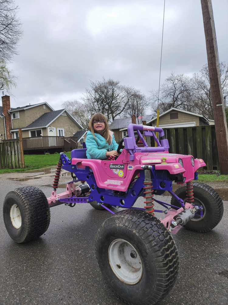

Well, I gave in and Santa bought one for my girl. (But the jolly bugger made me put it together.)
If I'd known how much she was going to enjoy it, I'd have dropped the extra bucks and got a Big Toy's version.
It's currently dead in the garage. Typical for a Jeep. Been to sick to dig into it this week, but I've tried charging and it won't start. Not sure what's going on, going to chase some wiring this weekend.

Buy the tool battery adapter and don’t look back.
We have one at the house for the grandkids. Run a wheelchair battery in it. They will get tired of driving it before the batt runs down.

So I have a pink ‘frozen’ jeep that’s been sitting in the garage for a little over a year. It was expected to ‘charge and drive’. Charged and just the radio started playing. I’ve been reading up on various conversions…12v vs 18/20v tool batteries. Then there’s a risk of frying circuit boards and motors. Figured I’d just cut up some old swampers for traction. Anyone want to make it easy on me, and let me know what circuit board/motor combo and battery conversion parts works best with 18v Milwaukee batteries so the thing doesn’t burn to the ground?
