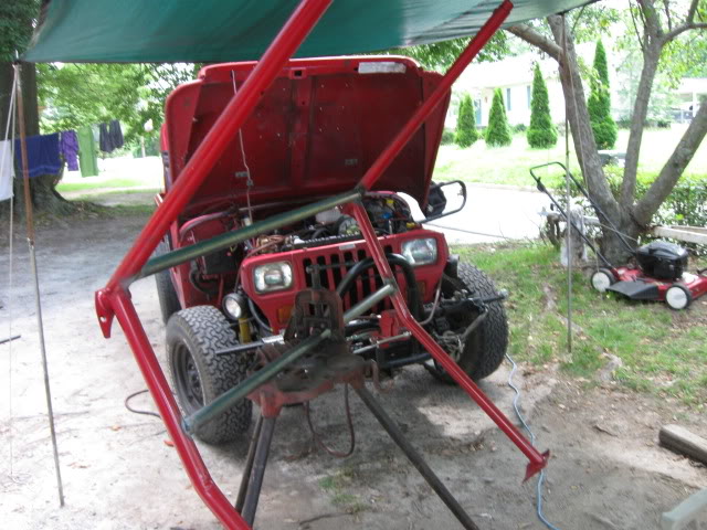

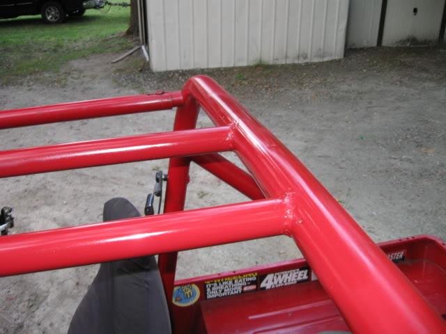

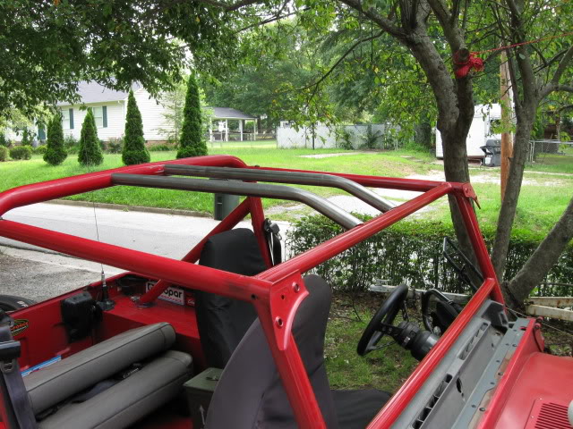

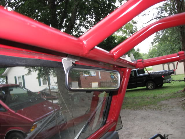

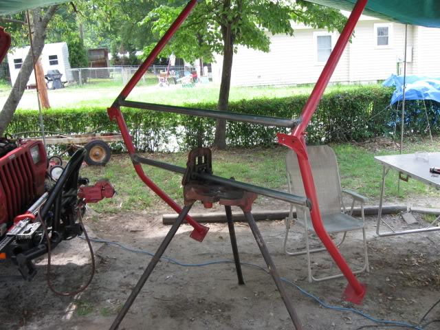

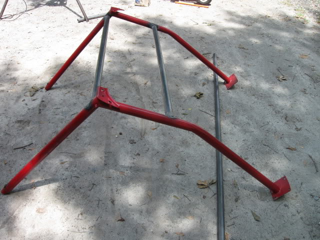

I did stop in at Jackson's, & the nice lady there found me a 9' length of the 1-3/4' stuff. It was $2.20 a foot & just enough to do the front risers, from the floor to the spreaders.
I'm gonna go back & get smaller diameter stuff to do the cross tubes, & two center spreaders.

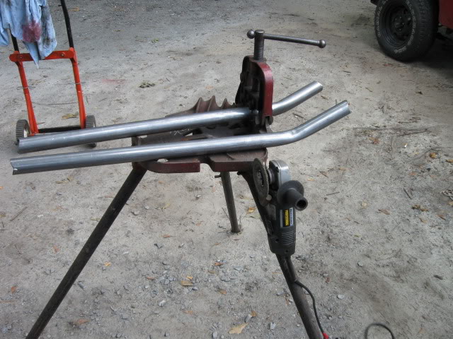

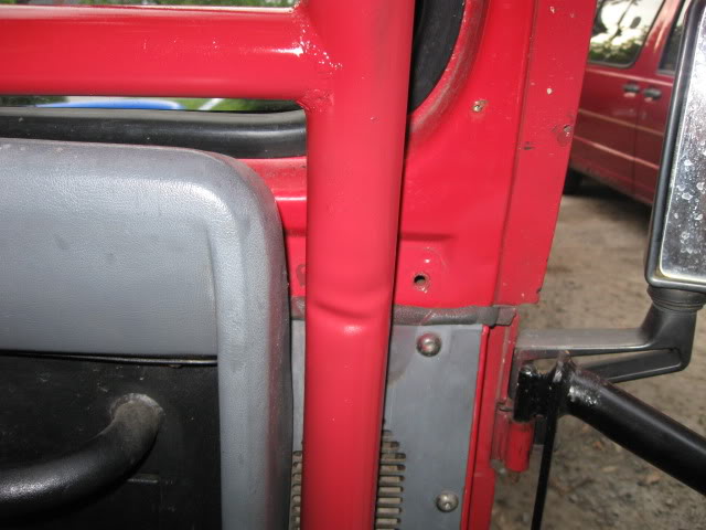

I also discovered my bottle jack bender makes crappy bends in thin wall tubing. A little kinked, they are gonna have to stay like that, until this recession is over, or i get a better job.

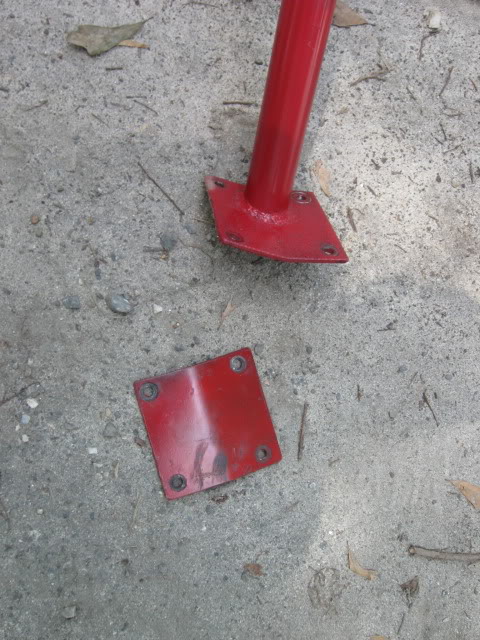

I may make a plate for each riser, to attach them to the torx bolts that hold the dash to the tub, near the speakers.

that kink doesn't look any worse than the factory Jeep tubing bends
Next time you bend tube in the HF bender, pack the tube full of sand and cap it off. It will help keep the bends from kinking. If you have a couple bends, its good, if you have a whole chassis to build, you'd spend way more time stuffing sand than it would be worth.
If you're using an HF bender then go buy some 1.25" sch 40. You're wasting your money buying tubing.

Agreed on the factory jeep bends!:shaking: I'm not too ashamed to leave them, since they match pretty well.
I'm still gonna get a real tube bender though, I have plans for much more protection at some point. (after the tire's/axles/lift/SYE/gearing changes)
I knew about the sand trick, but I'm way too lazy for that.
