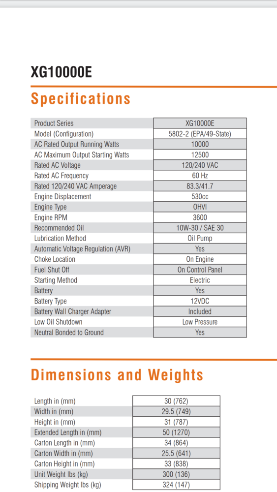

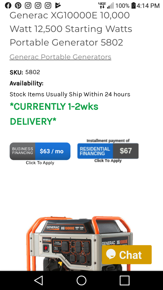

I'd suggest something along this size.
Would run larger tools, Or multiple small tools. Regular heat pump, or well. Buy a small inverter based multi function welder like the Rebel and rock on.
