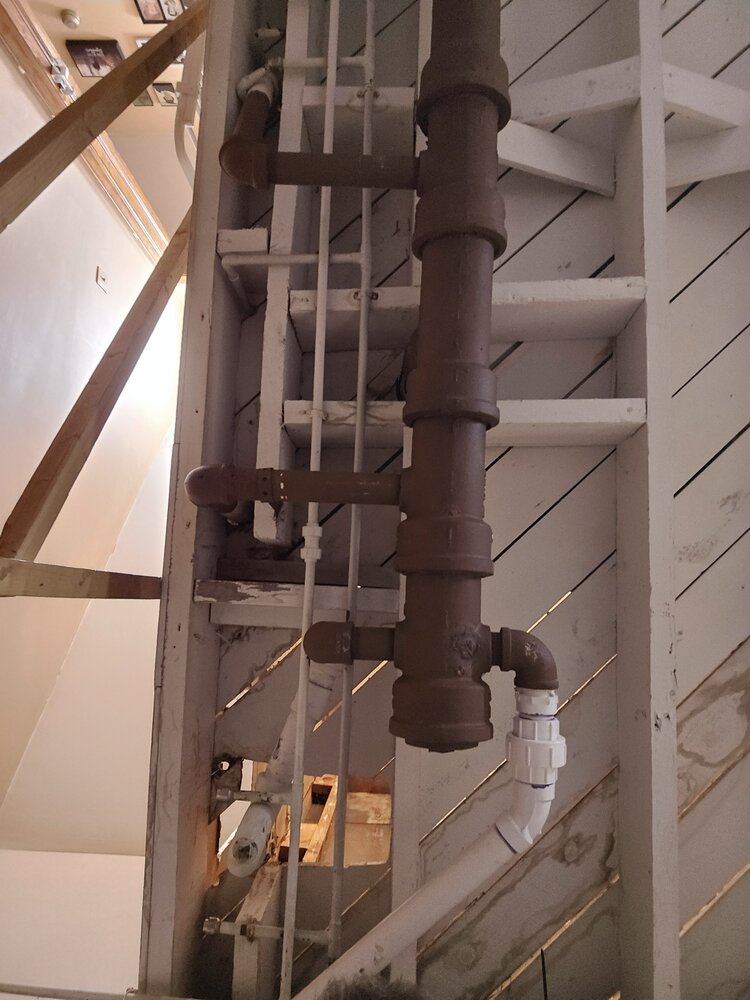

Tldr; In the middle of a total bathroom gut, the (overhead basement) plumbing shows numerous signs of multiple repairs AND shenanigans... like 1/2" copper feeding galvanized sections and judicious use of plastic compression fittings. All said, gonna redo all the water supply from pneumatic tank to endpoints (sinks/crapper/shower)...
Have the PEX tools, so thinking 3/4" "mains" (cold & hot) to 1/2" individual supplies...
Then wondered about recirculating the hot water (40' max run to furthest sink/dishwasher) with bath between there and water heater.

Then there's ye old rusty shitstack... coming out as well 💩
