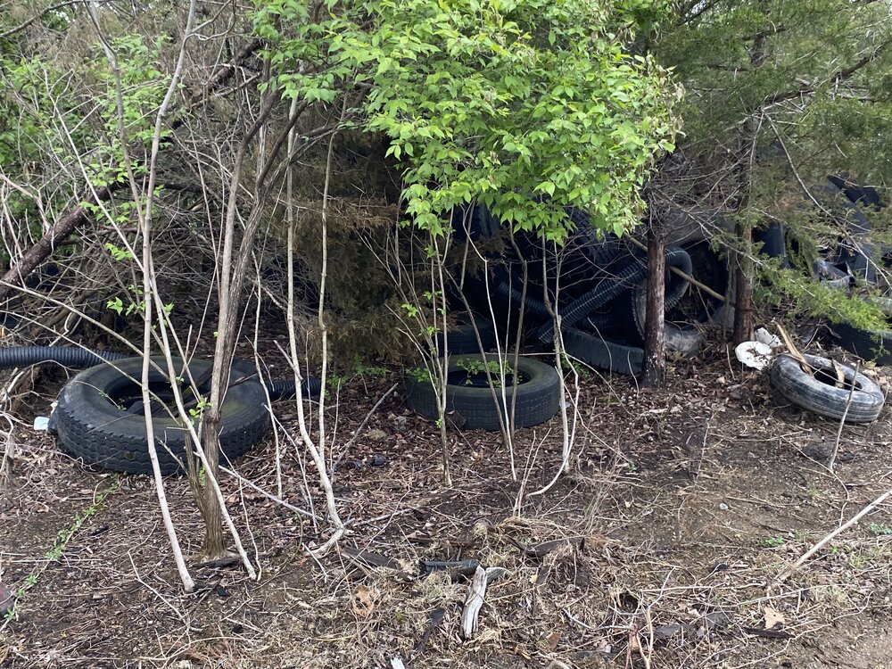

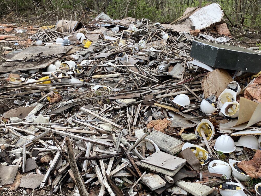

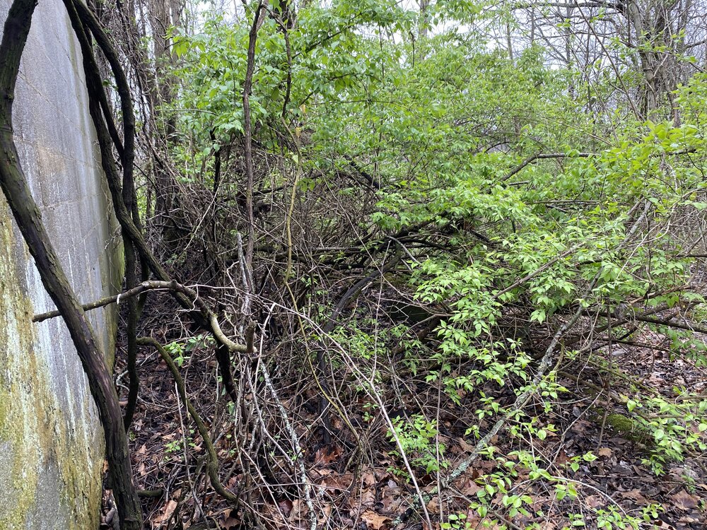

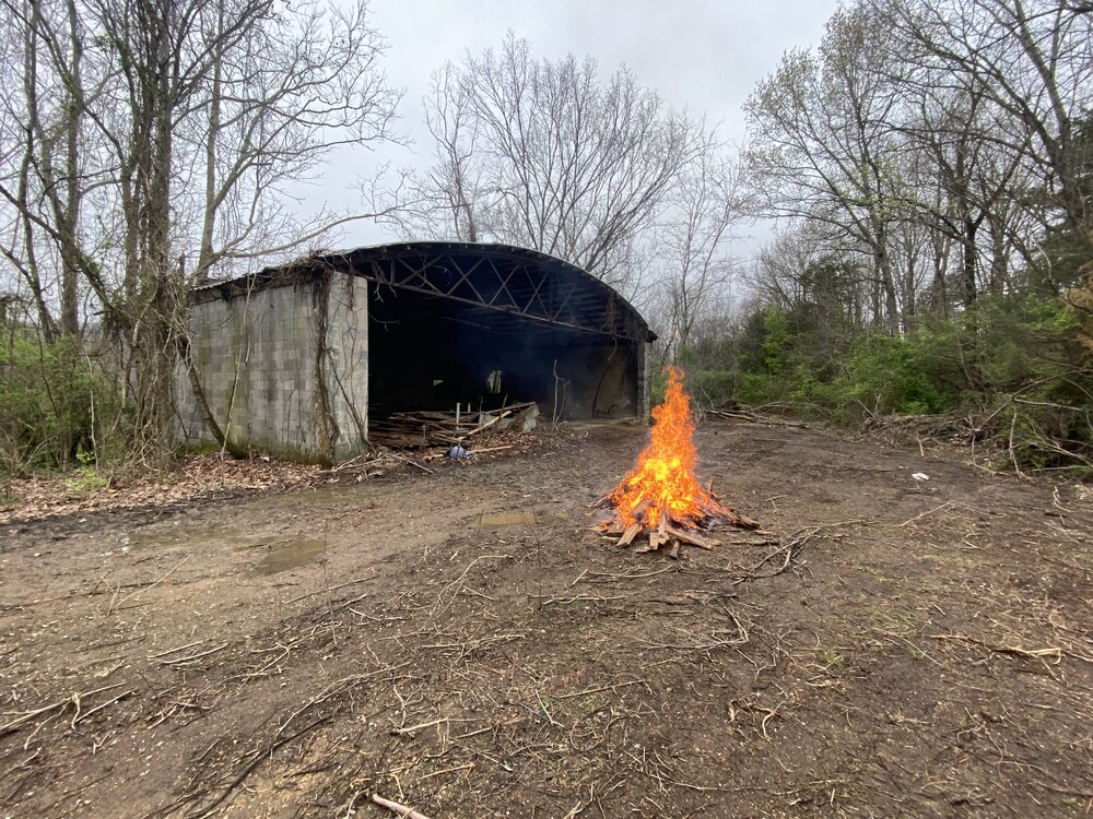

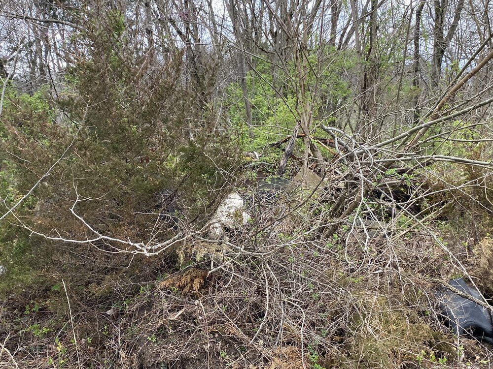

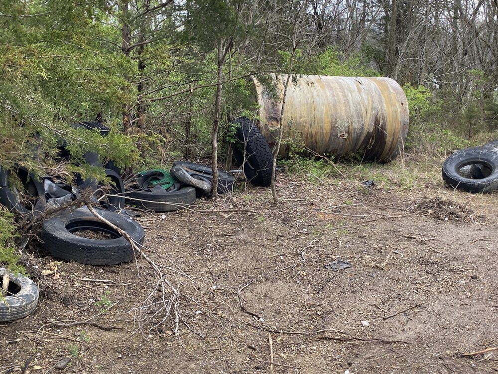

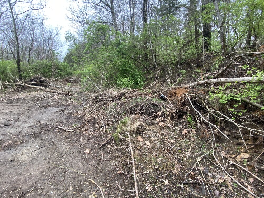

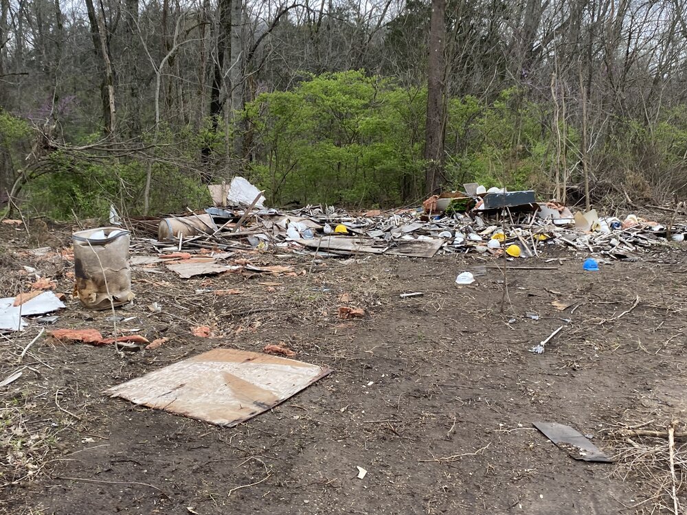

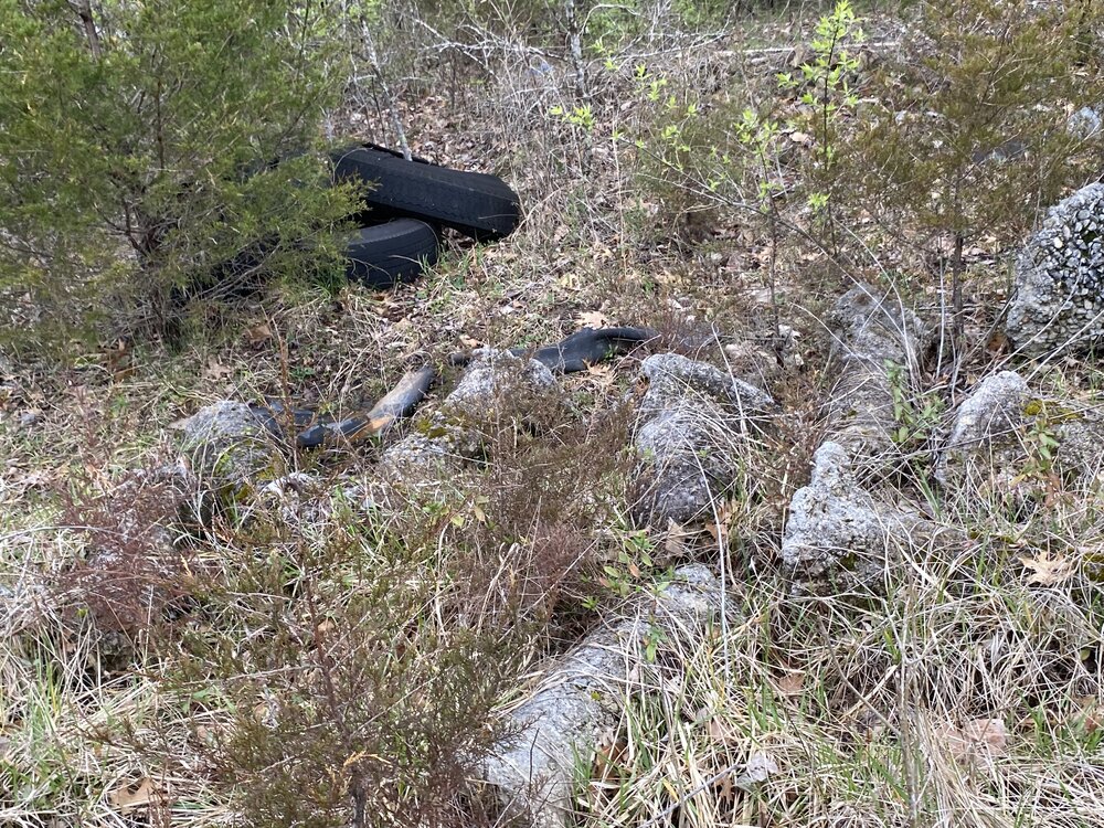

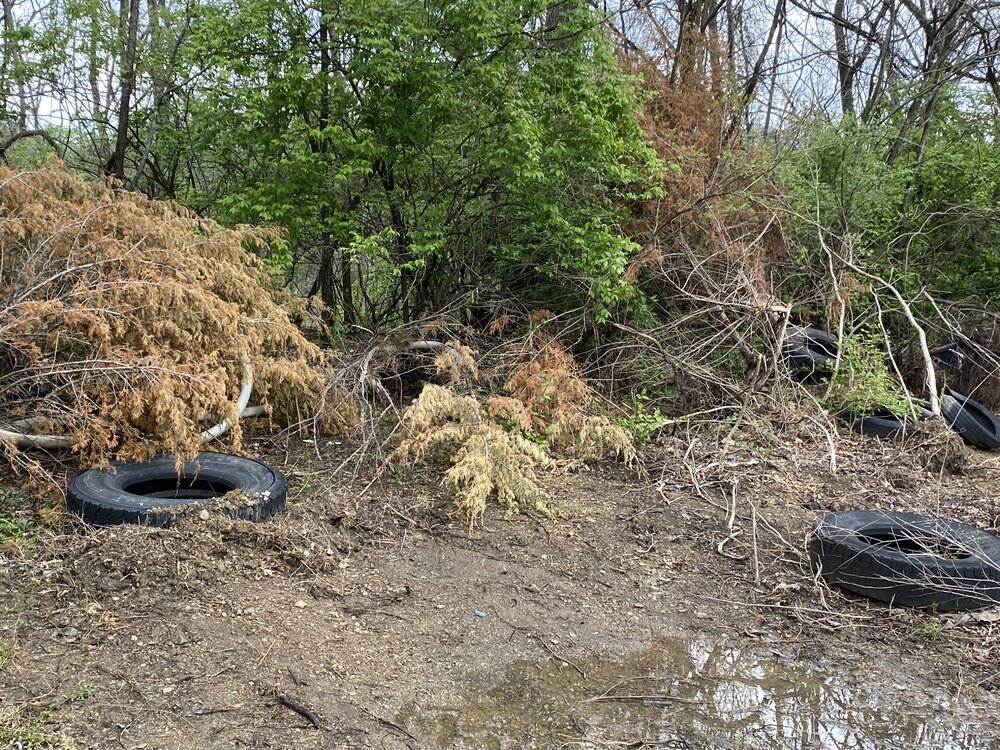

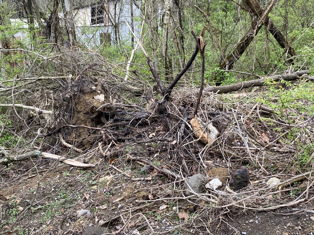

Quite a bit of this type of stuff
You really can’t root rake very well with a skidsteer because it will dip and dig in too easily if the roots are very sizable. But you can take a toothed bucket and let it float at ground level tilted slightly forward, and make a yard good enough for what you’re wanting. You can also set the bucket nearly vertical and backdrag with it.
But also that stuff doesn’t look too bad, and you could probably get most of it with a 4n1 bucket and just pushing it into a pile. Don’t cut anything, try to push it out first. It’s way easier to push a tree over at 6ft up than try to get the stump out with no leverage.
Im gonna get a toothed bucket too.I ran a tracked loader for a while many years ago and understand the leverage thing but im not sure how much of this will come out versus bend over.
A big enough skidsteer and a tooth bucket would do all you need for that type brush/trash

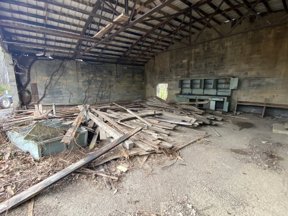

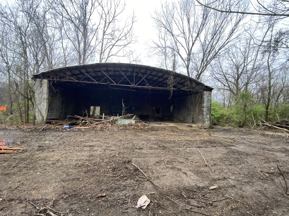

In TN the PO has a year to reclaim property from a tax sale so Im not working on but about 1.5/2 acres of it until then and some of that is already clear.Sorry,I didnt mean to imply I was doing the whole 9 acres.My main goal (for now) is to get all the old lumber out of the building so I can get our trailers in and clear off a place to park my parts trucks.I know at some point I'm gonna have to bite the bullet and pay somebody to do most of it.
