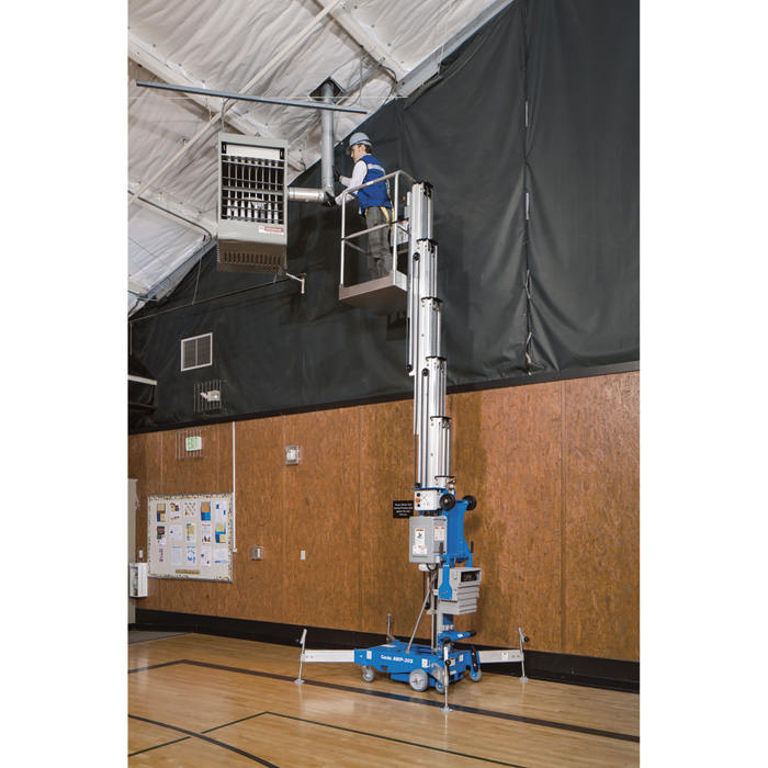

I think it's a great idea. Thats basically the way I did it to finish up the inside of my shop. I couldn't find a scissor lift for a decent price, but that would have been a ton easier. I found a Genie Aerial Work Platform like this:
Paid $900 for it from a guy 4 miles down the road. Used it for about 6 months for various stuff, then sold it for $1700.

Btw I think a 19' would be all you need. And as far as the earlier post about the 1 man lift. They work..... But man it's like riding a flagpole and not much room for tools. Also Mikey Mike u r welcome.
At 20' it shouldn't sway too bad. A scissor is still way better for tools and materials but boom lift is the best by far. Set the base centrally and then mover the boom wherever you need to be without having to move again to reach the next spot.
Yeah, the only reason I did the 1 man lift was convenience (it was 4 miles away and I could buy it and start that day) and it was under a grand. It was not convenient to use, but all I needed to do was put up panels in the center where my scaffolding wasn't tall enough. All the scissor lifts I could find were $5k and up, and you need a special trailer to move most of them because of ground clearance and weight. I really wanted to find a boom lift, but again, it was much more investment ($10k plus for any decent looking ones when I was in the market).
19' electric is likely all you would need. I wouldn't get that single person one unless it was a steal. To move you have to come down and then manually retract the outriggers, move it, set outriggers back up, go up, find out you aren't far enough moved over, then donit all over again. Waste of time IMO.
