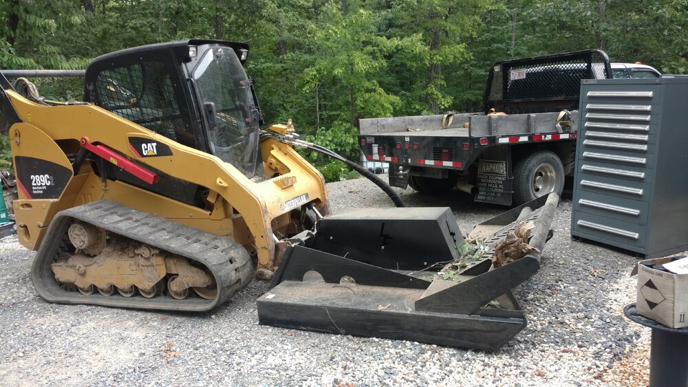

I have owned two CAT machines, an older 246 and currently a 289c. They are high new or used. Resell seems higher too. Parts availability is awesome in my area. They have never not had a part in stock when I needed it. The 246 never gave me a minutes trouble. I bought it with a bad pump and fixed it, ran about 3-4 yrs and bought the 289. The 289 has given good service with the exception of the head gasket. But it was an easy swap and Poole even had it in stock along with head bolts. My next one will more than likely be a CAT. The only thing I don't care for is the front door, but I'll trade that for the reliability I've had from it. I run a 72 lolflin bush hog on pretty often.
