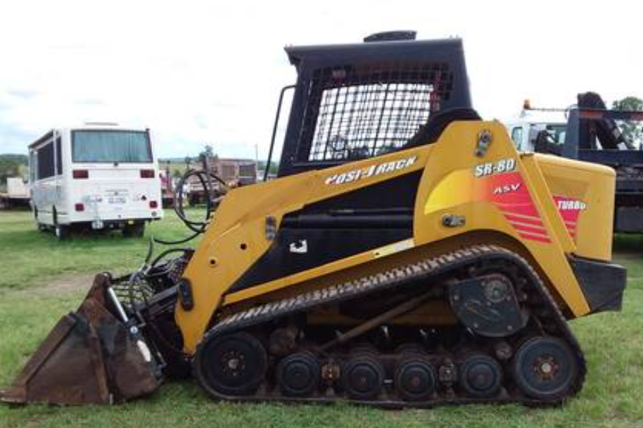

In my opinion, I wouldn't own a skidsteer without an enclosed cab ESPECIALLY if you are planning to do any brushcutting. I wouldn't own an enclosed cab skidsteer without a flip up door, and your only options for that are Kubota, Takeuchi, or older ASV's. I love my ASV SR80 because it has longer, wider tracks that are basically impossible to derail (they are more complicated, but I wouldn't say less robust, just a different design that most people aren't familiar with so they like to make fun of them ;)), a very good suspension system, and a flip up door. I've owned and ran Kubota and Takeuchi mini-ex's and skidsteers and they have all been very good machines and I wouldn't hesitate to get one.

If you are more #1, go with the 90hp, 5 ton class machines (Kubota SVL90/95, Takeuchi TL250, TL10, TL12). For me, philosophy #2 works out well, and if I were buying new or close to new I'd get a Kubota SVL75. If I were buying used and focusing on cost, I'd buy an ASV SR80 (or a Terex PT80, exact same machine, white paint) over and over again. Being sub-6ft wide gets you in a lot of places, and you can still pick up 5k pounds and move around with it within reason. I run a pretty heavy 6ft brush cutter on my machine and never have stability or control issues. Also, get a high flow machine if you can find it, but if not, a standard flow machine will do the same stuff, just not as fast (but using a lot less fuel).

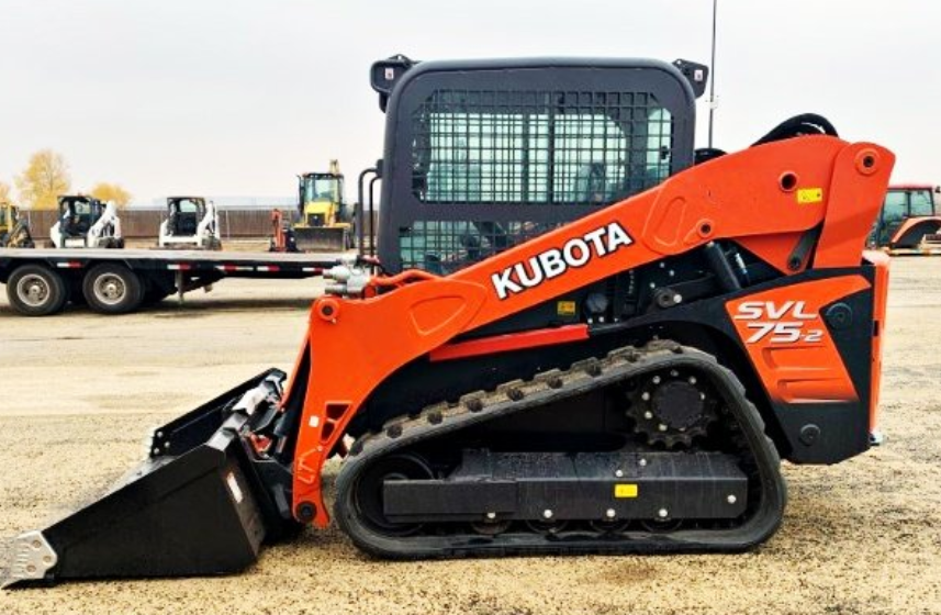

If you're already familiar and comfortable with Kubota, you can't go wrong with a used SVL75-2. @braxton357 has one and if he hasn't broken it in half, I'm sure you'll be just fine! :D The Kubota SVL75 and Cat 259 have become kind of the ubiquitous midsize skidsteers, and for good reason. Not overly complicated, with the right mix of features, capability, reliability, and cost. The construction side of things is a little more cryptic than the ag/tractor side, but parts and info are still relatively easy to come by. Home page is a go to for parts diagrams. Their prices aren't necessarily the cheapest, but they've been great to deal with when I ordered the wrong thing or too many of something and needed to return it, and also the typically ship out of Georgia, so most things are next day to NC.

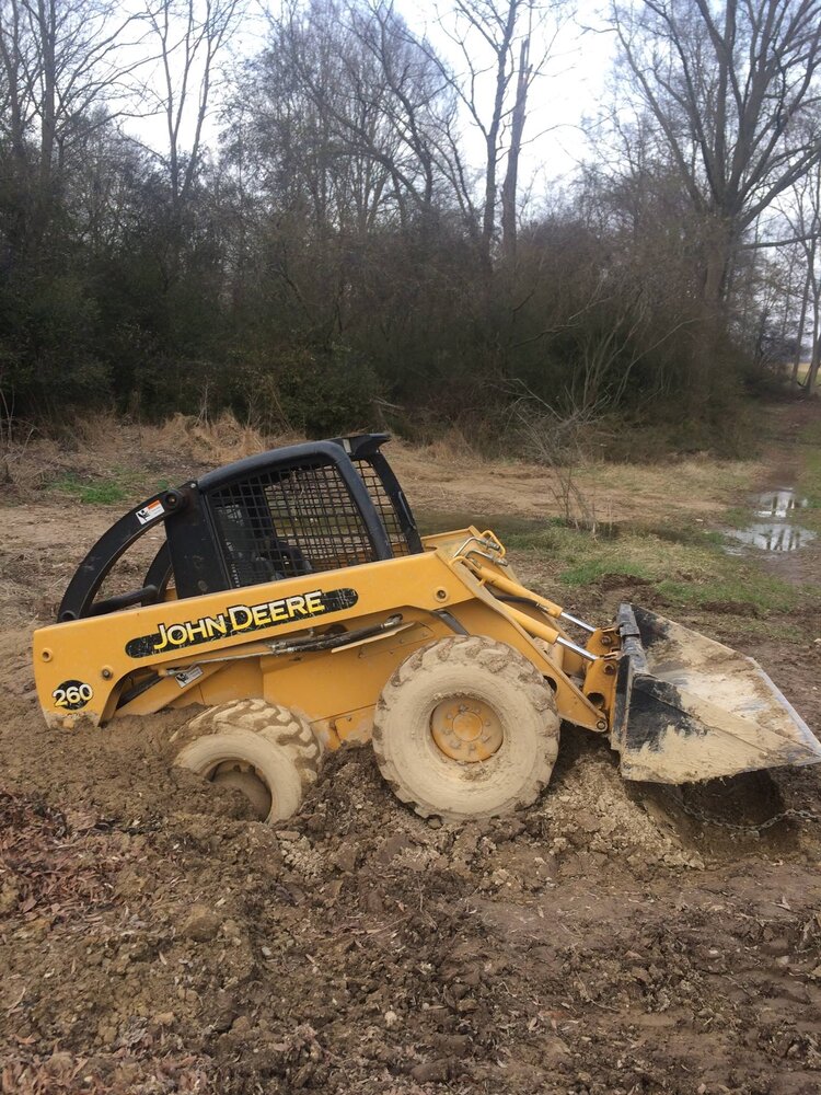

Dad has had a JD 260 since new, think it's a 2001 model. It's been good to us, replaced the radiator last year due to a leak. Otherwise it's mainly been just maintenance. Never had or ran a tracked machine or one with an enclosed cab. We just have a regular bucket, pallet forks and a grapple bucket for it.

Glad to help, and don’t mean to monopolize the conversation, plenty of others on here have valuable input too. Knowing the price point makes a huge difference. That’s definitely wheeled machine territory (or a tiny tracked machine), and in that scenario and price range a Deere 270 seems like a solid trade. I would make sure to have reasonable expectations for what you can do as far as “cutting trails”. It’s a pretty big wheeled machine which is good until you get stuck. They are fine on dirt, but roots can make you feel like you’re on ice (same can happen with track honestly). Steel over the tire tracks are actually really good. They add flotation and grip which are the main areas where a wheeled machine is lacking. Since it’s an 80hp machine, it should do pretty well with the tracks. Lower horsepower machines struggle with over the tire tracks because they add something like 1000-1500 pounds of mass you have to turn. But it’s also an 8500lb machine, so with tracks will be approaching that 10k pound mark. Additionally is 6’3” wide, so with tracks it would be over 6.5ft wide which is getting pretty big. None of this is necessarily bad, but things to keep in mind for your application.

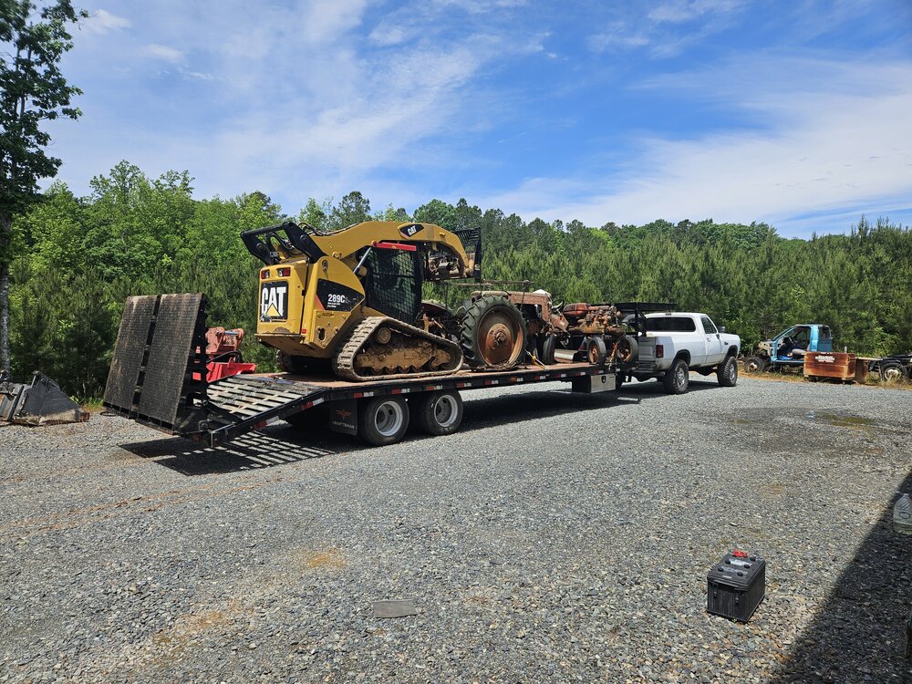

I'm a CAT fan. This is my second one. As mentioned the front door could be better but I'll give that up for parts availability, hp to weight and overall toughness. CAT probably has the best parts department of any dealer I've ever seen. Out of two CAT machines I've only ever had to order one part(joy stick base). Was in Atlanta at 4pm on a Friday and I picked it up from raleigh 830 am next day.
