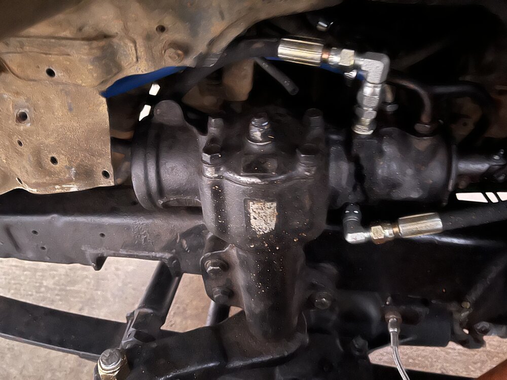

Looking for some insight on my current problem. I’ve got a scout ii box on my tacoma and plumbing for hydro assist. I read on pirate and drilled and tapped it in those locations. It doesn’t seem to be working properly, when you touch the wheel it goes hard driver. The lower line seems like it hit the vein good and has good pressure the upper line I question. I have also swapped the lines, it is a all new trail gear kit. Any suggestions and input would be appreciated!
Really nothing to be noted, I searched on pirate for a few hours and found there is also a vein on the inside of the box that could be drilled and tapped. Doesn’t work well for my application since it’s on the outside of the frame but it’s getting me by. I can add pics this weekend
