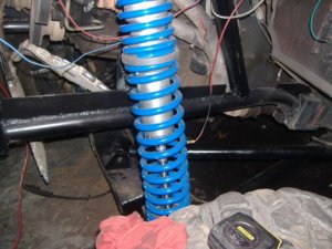

scout on 39's
IBREAK
Member
Aug 29, 2005
MTNS
so far scout II
4.3
t350
np205 twin sticked
2.5 foa coilovers
39 krawlers on 32 bolt mrws
60 narrowed
14 bolt

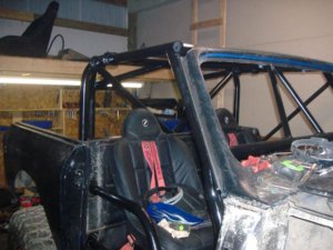

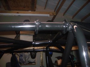

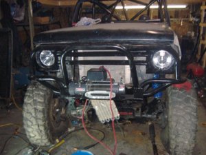

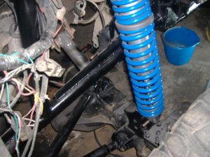

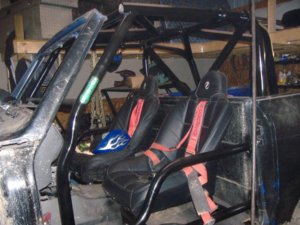

the cage bolts together so I can still use the half cab top. The main hoop is behind the bulkhead. I can't figure out where to put the steering cooler oh yeah I have POS full hydro and the big Derail (sp) cooler with the fan. It will not fit over the motor because I raised the motor so the oil pan would not hit the front axle. And it will not fit under the brake booster because the orbital and hoses will take up all that room.
Let me know if anyone has any ideas
