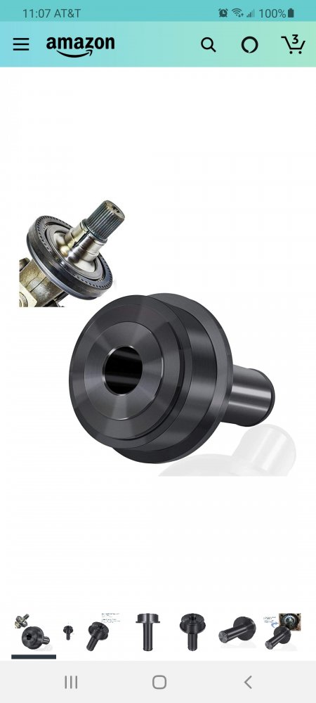

You have the tool that looks like this?
They take quite a bit to get them fully seated.
I feel like, if you have to drive them into the locker, it's going to be a pain when they break.
Sent from my SM-G970U using Tapatalk
It's the axle shaft seal and hub deals that make it a pain in the dick. The sd have those two piece inner seals that are ~1.5" wide and a have 3 o-ring style ridges in them.
