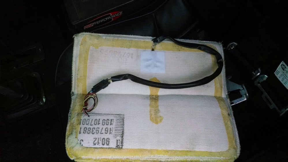

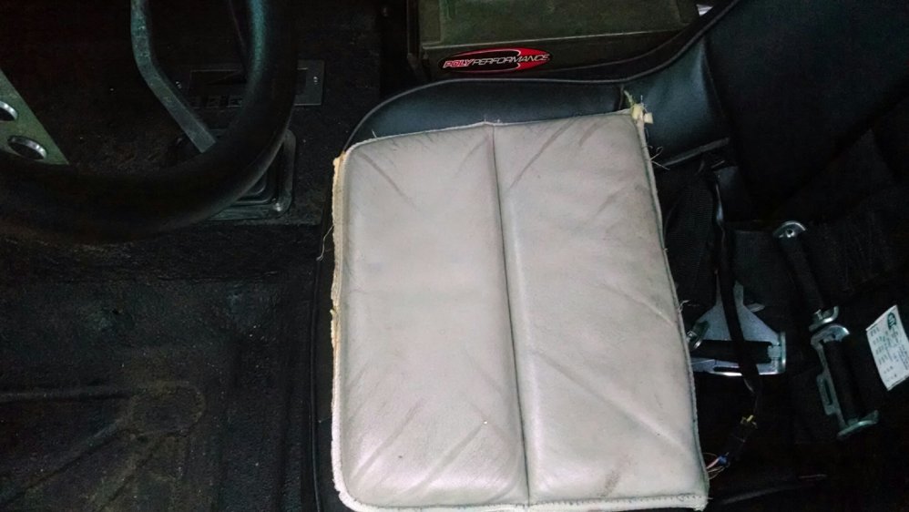

Went to pull a part today after work and looked at several different style seat heaters. The one I decided to pull happened to be in a 2000 Cadillac Seville. This seemed to be the cleanest and simplest designed. I'll dig into them more tomorrow in the daylight.

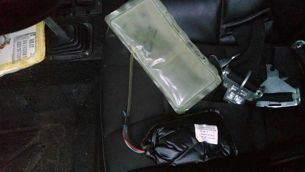

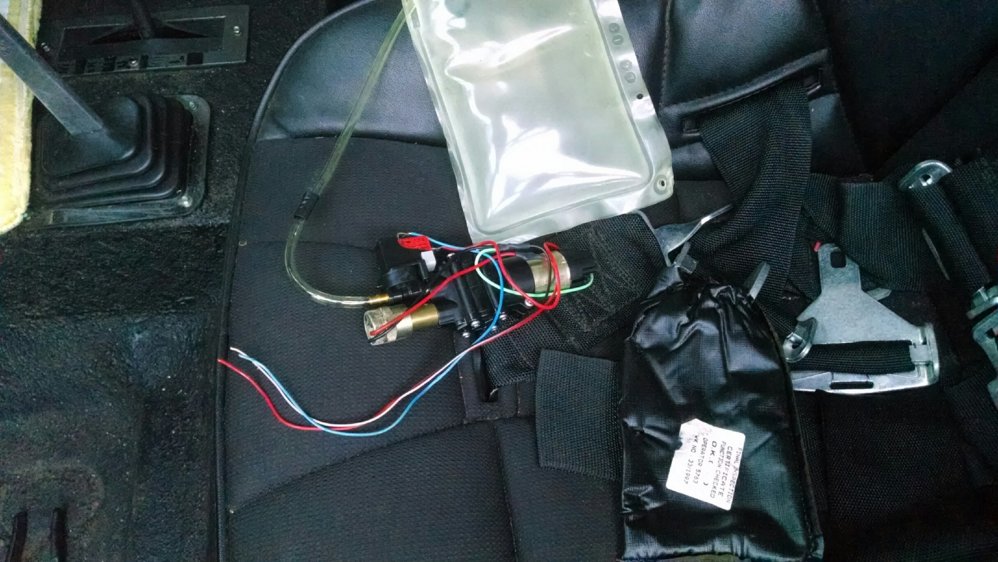

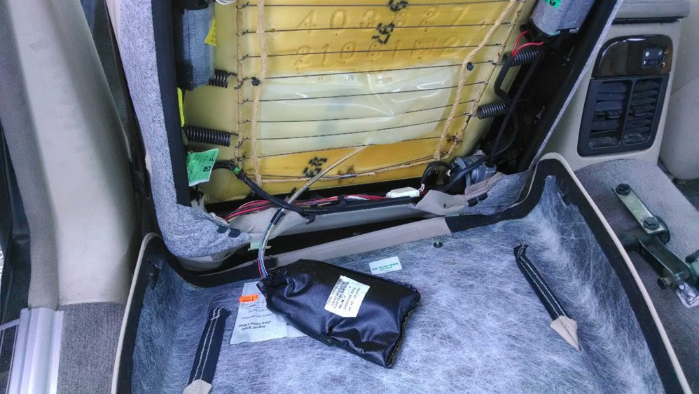

Also found these interesting little contraptions in a 99 jag xj8. Theyre air operated lumbar supports complete with inflatable bags and mini compressors. I got these cheap and plan on seeing how I can adapt these to my Corbeaus. PAP charged me $7 each for these so what the heck. I'm curious to see how much psi these compressors will put out, may even be a good candidate for ARB compressors. Also very easy to wire up (pressure +, pressure- and ground)
