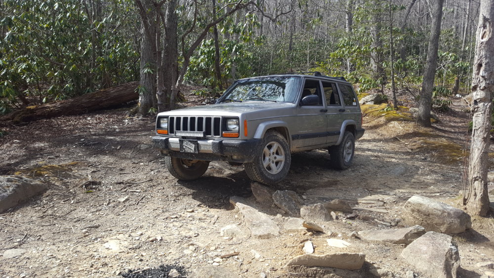

This past Saturday i took her up old nc 105. She did great through some of the bigger ruts and wash outs. I even played on some on the smaller rocks in on of the pull offs. I did end up putting her in 4wd full time because I would take the most challenging route through the washouts because I wanted to challenge myself and practice wheel placement and due to the fact the gravel was very loose in some places. Also to get practice driving it in 4wd. I highly recomend this easy and beutiful ride.

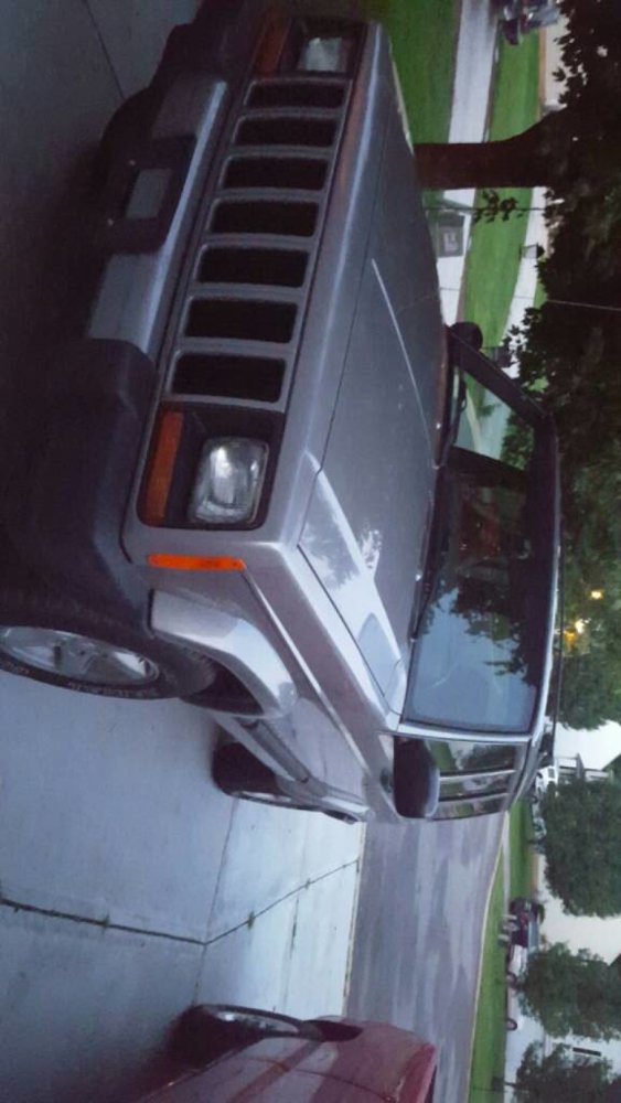

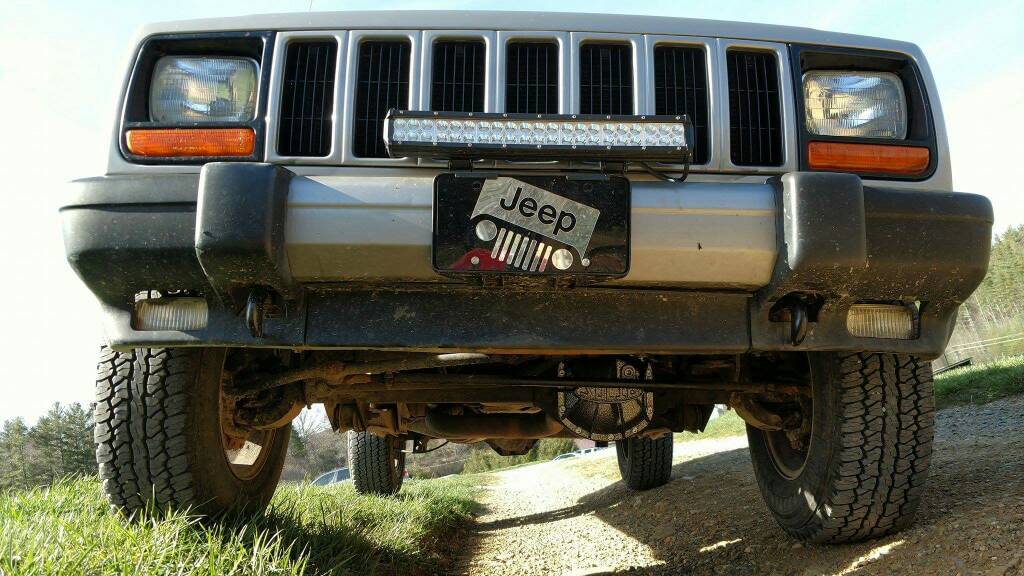

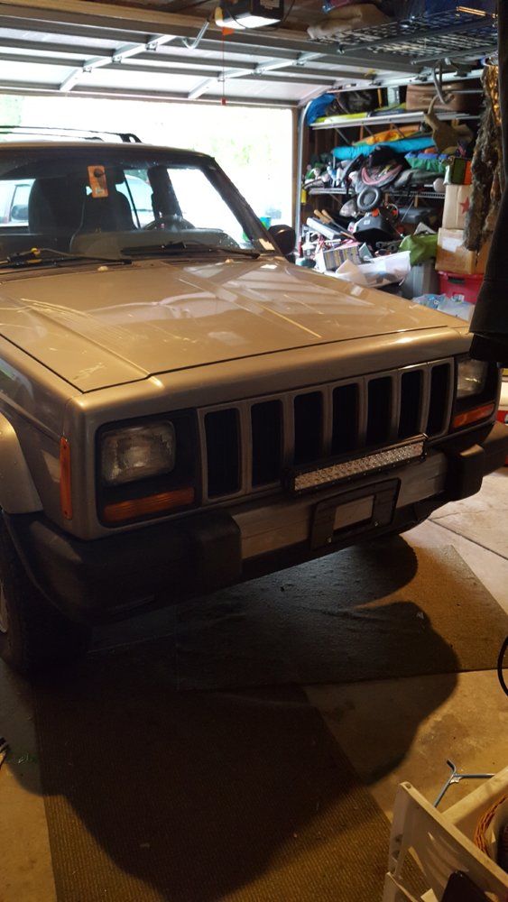

Its been awhile since i've updated this. Due to the fairly dim headlights on my Cherokee and wanting extra light when i need it but not blinding on coming traffic all the time. i watched on amazon for a fairly nice light bar to go on sale and ended up buying a 20 inch nilight one and the wiring harness for less than 40 bucks and mounted it on my front bumper

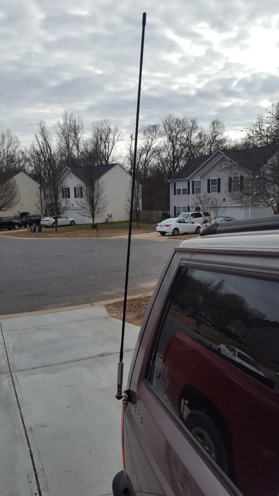

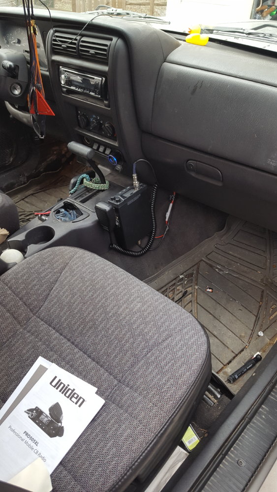

Got my CB installed today at first i was going to try to mount it above my rear view mirror but i ran into allot of issues so i just mounted it on the passenger side of my center console. I got the Uniden pro505XL and a four foot firestik firefly antenna. So the CB isn't taking up much room on the passenger side. I'm currently in the process of trying to get it tuned properly. i mounted the antenna on the back passenger side of my jeep so it is sticking about a foot and a half past the top of my jeep and ran the coax cord behind the plastic paneling of the passenger side

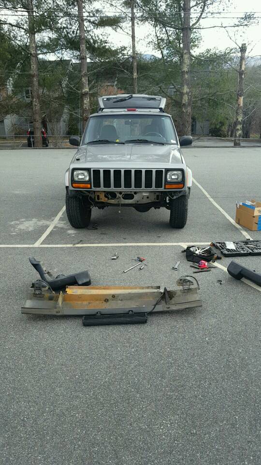

Finally got my front tow hooks installed. It was pretty simple hardest thing was shifting the brackets on my bumper over to allow them to slide over the tow hooks brackets. And yes me and a budy installed them in a parking lot at my college. Next step will be rock sliders and a gas tank skid

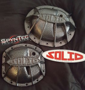

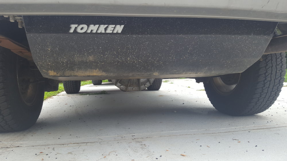

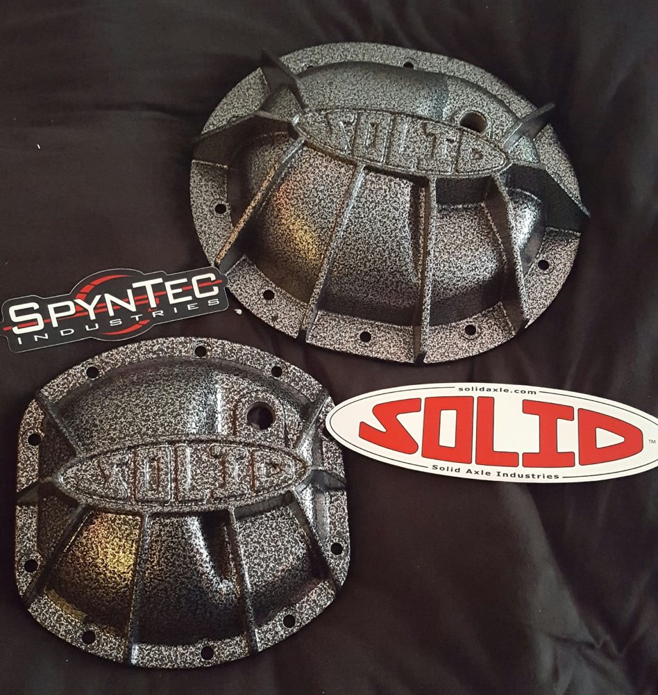

Its been awhile since i posted or worked on my jeep. Its hard to find the money and time at college. After saving up since January by putting money aside i finally saved up enough and ordered a gas tank skid plate and solid diff covers. i figured with me planning on only going 33's or 32's i need stronger diff covers since they where going to be fairly low and this way i can start doing a little bit more challenging stuff with out as much worry of breaking major parts. I order a tomken gas tank skid through quadratec it should be here by the end of this month. I think the ladys in the mail room at campus are starting to dislike my packages because they are getting heavier... I hope to get these installed here in the next week i need to go get a H14 socket in order to do it.

Finally got my new diff covers installed the gas tank skid should be here this week. I would like to thank Jason again for the help and guidance with installing them. The 8.25 gave us a little fuss but nothing to bad. The dana 30 went right on. I had a blast riding with Adam and Chris at the Flats this past weekend with the Carolinia Trailblazers. I learned a good bit even though my cherokee stayed parked.

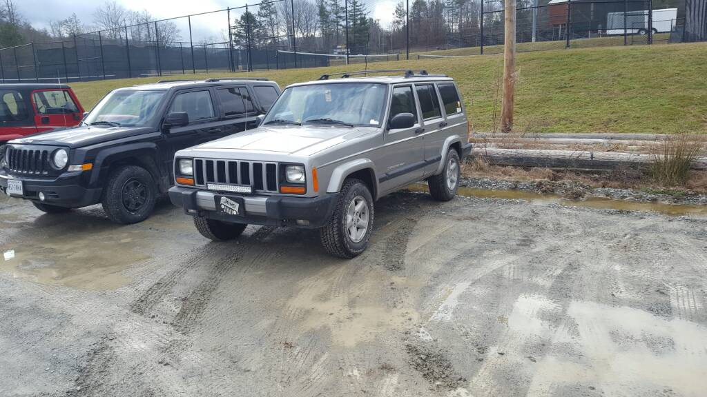

So my Tomken gas tank skid came in about a week after my diff covers did. The post office at school wasn't so happy about the 40lb package. The installation was really easy except my low profile hitch no longer fits on my jeep with the skid so i am looking for a normal square tube hitch. The skid sits just a little bit lower than everything else so it rubs going through some deeper washouts. I am hoping to be able to install a 3.5 Rubicon Express super ride lift kit by July along with new OEM steering kit for ZJ V8. Really don't know how much lift it is going to add because my suspension is sagging allot right now.
After going to shift from 4lo to 2wd it was my linkage time to go over the rainbow. So I ordered an azzy design linkage. Got it installed today with few problems besides trying to get in adjusted correctly. Going to do a final test tomorrow to make sure i got her correct. I also found a great a deal on a new hitch and got that thing installed today. I have slowly been gathering parts to finally lift my xj. I have collected a hack n tap sye, front drive shaft with new u-joints, shocks and soon a steering setup from my brother inlaw. Next week I am going to purchase the actual lift kit. Stand by for build pics and write ups in the next few weeks.

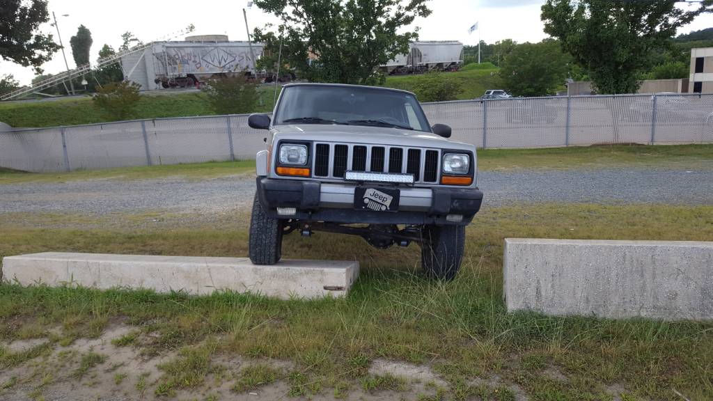

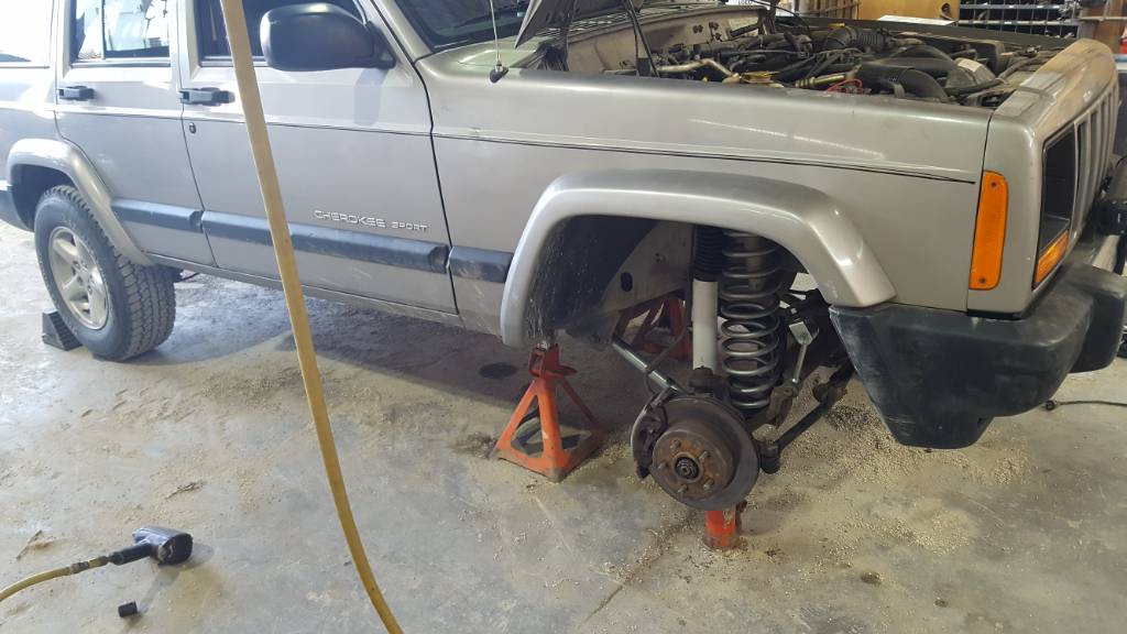

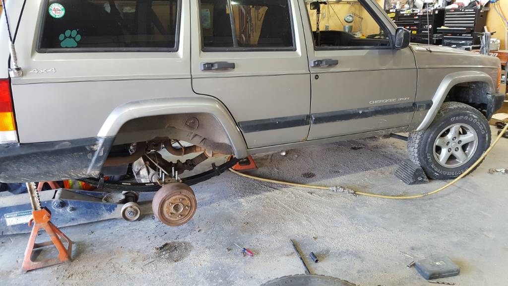

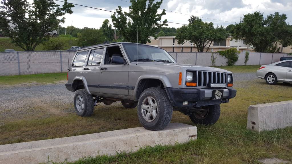

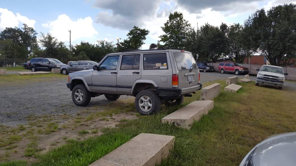

So I got permission to use the matinence shop at work to install my lift. Everything up front when great until i went to undo my track bar snapped the bolt off on the axel. So drilled that out and replaced the nut and the bolt. After got the front all done besides my front sway bar. The rear is where it went all to shit broke off all four upper shock bolts. Went to undo the front bolts on the leaf spring they didn't budge so that's when one of the matinence guys looked at the situation and said let's soakem in pb blaster over the weekend. So right now my jeep has Carolina squat and is locked in the matinence shop for weekend until Monday rolls around for round 2.
The picture is the front installed with out the tire or sway bar
I would like to give a giant shout out to the mateince guys at work they were giant help today finishing up my jeep. Got everything installed lift kit wise except my sway bar links. I need to fix my steering wheel it's off by 90 degrees. I do get some vibrations between 30 and 35 mph from my rear drive shaft. I am hoping it will go away once the rear settles but if it doesn't I will install my sye earlier than planned. Next on the list is upgraded steering including steering box brace and larger tires.

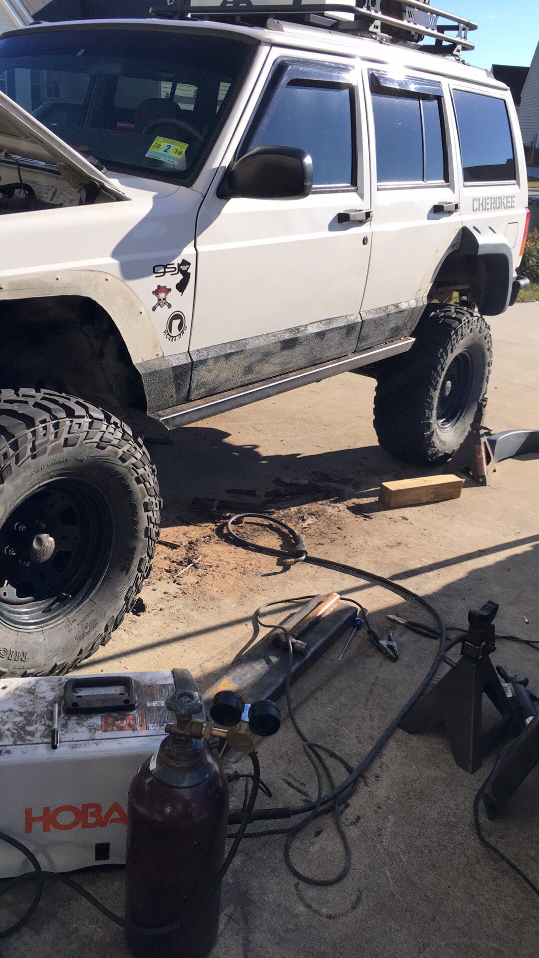

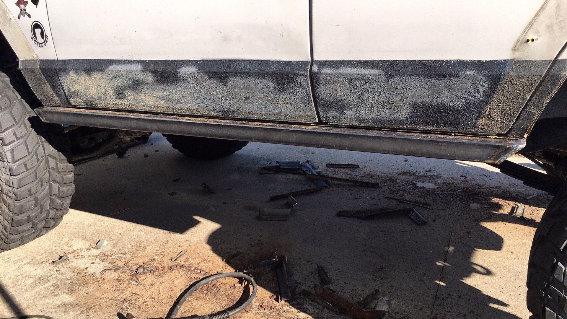

I welded in some of those hooligan rocker replacement sliders. It stiffened up the guys XJ a good bit. His had some rust issues mainly from the previous owner. Might be something to look into.
