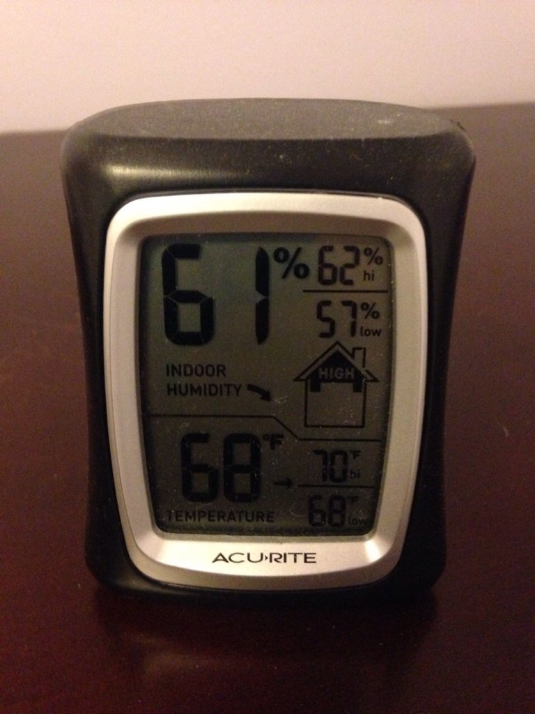

Inside

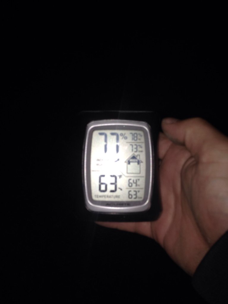

Under house
Weatherunderground said 85% humidity

Inside
Under house
That's crazy high. Get some plastic down on the dirt asap. Look for threads on here by moldman and mac5005 if you need specifics.
