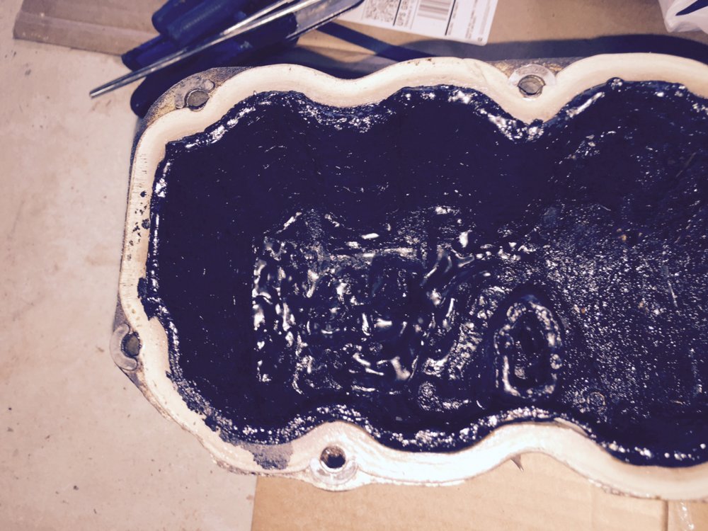

I bought a used YJ with 135k miles on it's 4.0 so I could swap the 4.0 into my cj. I have the 4.0 on my engine stand so I can freshen it up a little before installing in the cj. I had planned on having the head rebuilt, new oil pump, timing set and some gaskets. I pulled the valve cover last night to prepare for pulling the head and found major sludge build up. The rocker arms look pretty much the same. I scrapped about a full solo cup full of sludge out of the valve cover. So now I am concerned about the condition of this engine. It ran good and had good compression. I plan on pulling the oil pan to replace the oil pump and oil plan gasket. The head is going to be rebuilt so it will get hot tanked to clean it up. Is it reasonable to think that tanking the head, cleaning out the oil pan and replacing the oil pump will clean most of the gunk out. I am going to spend about $400-$500 for the head rebuild, oil pump, and timing set replacement. I can have a company called Poteat Engines do a full rebuild including those parts mentioned for about $1150. I would prefer to put that $700 towards something else if the sludge engine can be cleaned up, but if it can't I don't want to spend. $500 freshening this one up to have it crap out on me 10k-20k miles later. Thoughts?

If your going to have the head rebuilt pull it and then fill the block with diesel fuel and let it sit for a few days, this will eat the sludge and make cleaning much easier when you drop the oil pan. I redid a 4.0 that way and when I pulled the valve cover the sludge was so thick it looked like a second valve cover. Rebuilt head new oil, water pumps and timing set, few gaskets and it runs like a top.

i've rebuilt way worse and used/seen/bought way worse and never had an issue: soak it in Kerosene overnight or diesel fuel then pressure wash the hell out of it with oil pan and valve covers off and put the pressure washer on the straight nozzle from 3-4ft away and when you're done, the inside will look brand new. then put the stuff back on whatever you replace or reuse, put pans back on and put some real cheap oil in it or used oil for that matter and just turn the motor by hand several times, install it and use the starter to turn it for 20-30revolutions with good charger hooked up. this will get about 90%of any remaining moisture buildup from passages/bearings out and then ur good to run cheap cheap clean oil for an hour or so then change it to whatever you normally would. I've done this for years and works flawlessly...even on one engine with so much gunk that you couldn't see the oil pump screen/tube or bump and bottom of crank but when done, that motor ran like new with 81K original miles. (this is why nowadays i won't give much for a old low mileage 4.0 cause they are gurarnteed to look like this). have fun and enjoy!!

Wow seems like there is no clear consensus on this. Seems like almost as many people saying rebuild as those saying clean it and run it. I think I am going to wait and make my decision after I have the head and oil pan off. If the bottom end looks good and isn't too full of sludge I think I am just going to clean it and run it. It ran so good before that I hate to spend money on a rebuild that may not be needed. If the cj was my DD I would probably rebuild it no matter what, but since it is just a weekend toy that will see 8k miles or less a year I will try and clean it and save it if the bottom end looks decent.
Instead of guessing, do a simple check. Pull the rod caps and measure the diameter of the crank journals to see if they are within spec or out of tolerance. Measure the bore of a few cylinders to see if it is within spec. If everything measures within spec, then maybe just replace the rod bearings and you could hone the cylinders and install new rings, or just do nothing and put the head back on after having it freshened up.
