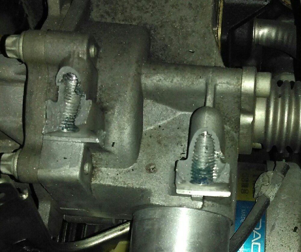

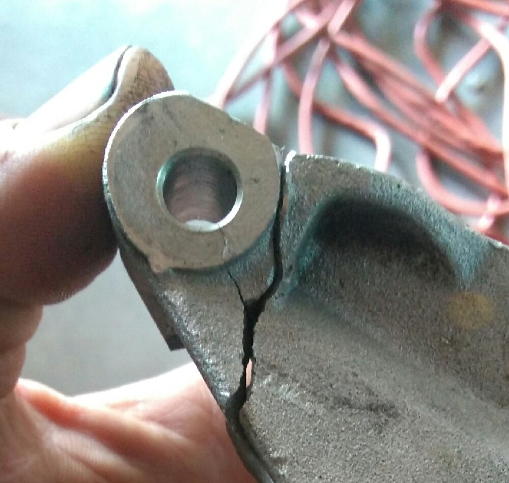

Maybe I should have attached these pics...
It's pretty clean and pretty thin.

Well that changes everything! I'm not going to say "no," anymore. I'm gonna say "Hell no!" ;) That's a mess there. Those threaded holes should really be ground out, built up with weld, then remachined, drilled, and tapped in order to have any chance of surviving. You could MAYBE tig it back together well enough to hold for a little while, but you'll likely end up with screwed up threads and welds that continue to crack.
No, nope, not even a chance. Welded aluminum is in the annealed state when finished. It would require extensive heat treat to hold threads again along with an absolute perfect weld condition.
You got yourself some scrap metal. Honestly lab metal or some goofy epoxy would be a better attempt.....profesionally...replace it.
Lol. That's what I was gonna say, better off with an epoxy. No matter what you do on that, it won't hold anything belt driven. If it was just helping to seal the cover to the motor, that would be one thing, but that looks like it will have a load on it and a lot of vibration.

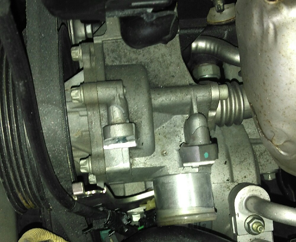

I'd happily replace it if it wasn't made out of unobtainium. Anyone want to Tig it for me? Yes it is structurally loaded. It mounts the power steering pump.
What part for what kind of car?
It's a 2011 Chevy Aveo front engine cover / water pump rear cover. Can't even get it at the dealer. I can get the VIN for which motor it is. Junk yards don't list it as available either.. even those with core motors.
If it were me I'd find a cheap parts car or wrecked one and rob this part off it then part the rest out.
I'd attempt it, personally. If it were my car or a friend/regular customer. I feel confident I could make it strong enough, but I couldn't guarantee it. And between the welding and machine work necessary, it wouldn't be cheap! I would strongly encourage you to find a replacement cover overseas or wherever.
